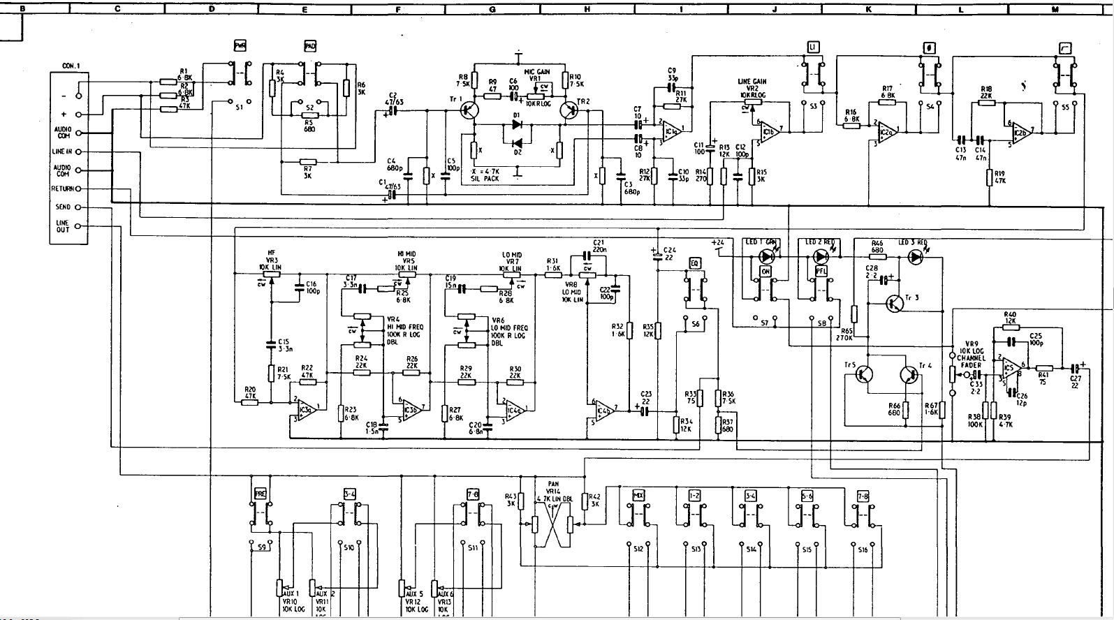

I ordered a couple of so-called high performance opamps. I did the master-section and one channel strip. In the same round, I also did recap the master section and the channel. I had finally given in to all the audiophile hype around changing opamps to get "darker background, wider image, more detailed but less hyped highs, violins comming clearer through" and all the other subjective terms to describe differences in sounds, and decided to try to "upgrade" the opamps. I have never believed in all the hype, and I am sorry to say to all of you "audiophiles" that I still think it's a load of cr**. I was very dissapointed when I plugged the "upgraded" channel strip in, and connected a couple of microphones (Neumann U87 and a Shure SM57) and a DI-box to both the channels with a Y-splitter cable. I made sure that both channels were gained identically, checking the level in my DAW so they were matching within 0.4 dB. I recorded some voiceovers, snare hits, bass guitar notes and other stuff,. I A/B'ed the recordings (not a blind test), and other than the improved low-end of the recapped channel, I couldn't hear a difference. There was no darker background (whatever that means) no relaxed mid, no non-hyped highs, just an identical channel with improved low end because of the recapping. The monitor system I use is a set of Yamaha NS-1000M and a Yamaha MX-1000 amp, so I would expect to be able to hear a difference if there were any. Even the noise floor was just about the same for the two channels, any small difference could just as well be differnce in component tolerances. All that hype about super fast opamps is, in my opinion, completely nonsense. The good old 5532 is still one of the best suited opamps for these tasks.
After that, I did some measurements. I did use my DAW and sound interface. Some of you might say that an audio interface and a VST plugin from a DAW is not the best tools for doing measurements, but I would actually think that it will be the most appropriate, since that's where the signals eventually will end. I put a test tone in to the two channels, and monitored the frequency graphs of the two channels (layered on top of each other so that I could compare the two graphs). I could see that there were slightly better distortion characteristics of the reworked channel, but that could just as well be because of the new and better Low-ESR caps I used to recap the channel.
I also measured intermodulation distortion, inputting two different frequencies into the channels at a quite high level, far beyond where the peak lamps where lighting up (though the desk still has some headroom above the peak-light), and I couldn't measure any considerable differences between the two channels and their distortion characteristics.
So based on these tests, with both measurements and listening, I don't believe that changing op amps is the way to improve this console. This will also save me the hassle of acquiring a larger power supply
A total recap of the console is of higher priority. I could measure a 2 dB drop at around 50 Hz, when comparing the recapped and the non-recapped channel. That is a considerable amount when we're talking bass guitar or kick drum.
I tried the mod described by Jim Williams, cutting the feedback loop of the first opamp and connecting that to the emitter of the inverting transistor in the discrete first stage of the preamp, but that didn't work. Can any one of you tell how exactly to do that mod? I couldn't get it to work.

I tried OPA2134, OPA2604, LM6172, OPA2277 and others. The extensive testing I did, was with the OPA2134 which I often see highly appraised for it's capabilities in the audio field. As I said, I was not able to hear any difference, except improved low end on the reworked channel which probably has more to do with the recapping.
I would still like a more thorough description of the mod I quoted on page two by Jim Williams of Audio Upgrades:
They can be rewired into trans-amps by cutting the opamp feedback loop and tying that feedback resistor to the inverting transistor emmiter. That will lower preamp noise below that of a mic and will lower THD levels considerably. You can get -129.6 EIN with that preamp if reworked.
I tried that but it didn't work.
Yes, I tried real audio through the LM6172 (though the very first stage of my channel modules only use a single op amp, since it does not have a line input at in the schematic, so I used a OPA134 in this position in all the tests). I also activated the EQ (flat though) and both the Phase and Low cut switch, inserting at least five op amp stages in the signal chain. I let the signal exit from the DAW, allowing further op amp stages in the chain.
I would expect that a complete recap of the console will have much more impact on the sound, than changing the op amps. What I have heard during my own tests didn't convince me that it is worth the high cost. These types of op amps are expensive even at bulk prices. Lucky for me, I can get Low-ESR 105 degrees caps pretty cheap throug my work.

The only thing I see can be done here to this desk, is the Jim Williams mod to reduce the noise and to recap the whole thing with high quality caps. Other than that I could spend my time making music and renting out the studio so I can get money to buy more cool gear. I am not at all dissatisfied with the sound of the console, it's not clinical and clean, but as I mostly will be recording rock and the occasional heavy metal bands, it suits my needs fine. I just thought that if there were any easy improvements, I would try them.
Are there any of you who can explain the mod to the first stage of the preamp as I described above?

I have linked to the complete schematics in the second post. The schematic for the whole input module is found on page 4. My modules are not completely identical, since they don't have the line in, but instead have 8 aux send pots, otherwise the circuits are completely identical.
Yeah...I know you linked it in the 2nd post...I looked at the partial circuit.
I have cell-phone internet...
...& unfortunatly downloading a gazzilion terra-bytes of Soundcraft PDF's & chopping bits out of them is not on the cards.
Just wondered, since you already have it...if it was easy to post a complette front end.
Si.
Here is the complete (well almost) schematic of the channel strip.
