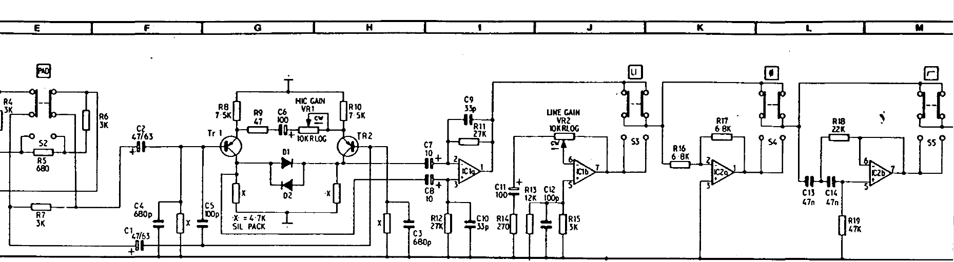

I am currently running and managing a recording studio, which I have built myself. The studio is based around a Soundcraft 800B mixing desk which is the live counterpart to a Soundcraft 1600. The difference between the two mixers is only the configuration of the modules and the fact that the 1600 has an optional patchbay. Other than that, the input stages and channel strips are the same.
I do like the sound of the desk, and I am in no doubt that it's a high quality piece of equipment, but I do feel there is room for improvement. I do feel that the preamps on the console could use a bit tweaking. They do sound OK, but I suspect that there are some improvements that can be done to give them more life and maybe less noise. I know this is not a clean sounding console, neither is the purpose of the studio, since I mostly record the typical blues, rock and occasional metal bands. I have attached the schematich for the front end of the input modules. As you can see, the very front end is discrete, followed by a couple of opamp stages. The transistors are 2N4403 and the opamps are TL072.
I am willing to do major modifications, but I would like to ask you NOT to advice me to either scrap the console or buy outboard preamps. Outboard pre's are not that practical, both because of the price of a nice pre will be above the 1000$ mark, and 32 channels of nice pre's are not really anything I can afford... Ever...
Give me your suggestions for improvements. Maybe I could benefit from changing the resistors from carbon to metal film, other transistors, constant current source in the emitters of the first stage. Gimme all you've got!

Excerpt from the Schematics

Personally I would get rid of the TL072s as a first step.
I replaced the ones which were in my active xovers with OPA2134s and got a significant improvement. Other and better opamps are available but would possibly need extra bypass caps to prevent them oscillating.
Talking about capacitors it might be about time to have your Soundcraft recapped.
That's all I've got, I'm crap at electronics.
2N4403's are low noise, the TL072's not so much, I'd replace them
with 5532's as a matter of course, but try one or two channels first.
Quite probably changing IC1 only will make the biggest difference.

Changing IC1 to 5532 is the cheap obvious no brainer,
and must be done first before anything else, IMHO.

Well I guess there is no reason to change the transistors in the front end then, if they are already a low noise type. Could there be any design changes done there? What about adding a transformer on a couple of channels?

1600's and 2400's used a standard instrumentation amp design for the mic preamps. It's a pair of noisy 2N4403 switching transistors in front of a 072 opamp.
Modern Japanese transistors will lower the noise, but THD is high with this design at higher gains. It's the same design as used in the TS-24, early 600's and others of that era.
They can be rewired into trans-amps by cutting the opamp feedback loop and tying that feedback resistor to the inverting transistor emmiter. That will lower preamp noise below that of a mic and will lower THD levels considerably. You can get -129.6 EIN with that preamp if reworked.

Off the top of my head, that preamp looks very much like the 400B I used for quite some years. Nevertheless, I don't think you will gain much in terms of noise by changing the opamps, as it is the two input transistors that sets the noise level. 5532s should be OK in terms of power consumption. I'm not really sure you'd get much lower noise by changing the transistors either, as 2n4403 is concidered being quite good in that respect, and getting any real improvement with other transistors may need a total redesign. Maybe shopping for some used external mic preamps is a better choice.
True, reducing noise for the micpre amp will be nearly impossible. But lower distortion and better bass - generally a more open sound can be obtained. Upgrade the power supply, then opamps and caps AND ADD A CURRENT SOURCE TO BIAS THE OPAMP FURTHER INTO CLASS A OPERATION. At least do this to the opamp associated with the mic pre circuit. A lm334 set to even ONE MILLIAMP (62ohm set resistor if memory serves me) will help with low level detail linearity. I learned this from Jim Williams.
