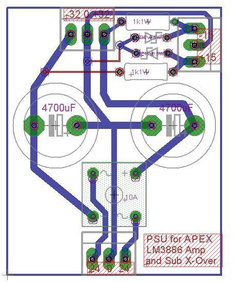

Sorry, I'm not familiarized with pcb software, you should try like 2Kohm 2W and 1.3W zenner
Also, diode brigde have usually the + terminal not in the corner, you should add some fuses on +/- power rails and 100 nF ceramic caps close to DC power connector and some 100uF electrolitics on +/-15

thanks for the reply. I am planning on using the above PS in a sub powered by APEX LM 3886 amplifier and sub x-over circuit given in this thread by APEX.
I have a transformer that has 24-0-24 (5 amps) and 12-0-12 (500mA). Do you have any PSU circuit that is suitable to drive the above combination?

you can use four 4007 diode and then add two cap and use 7815 and 7915 for crossover but you can not use this circuit from dc voltage like +-32.you should use 12-0-12 ac source.if there is doubt in mind i will clear for you.HI rohin,
