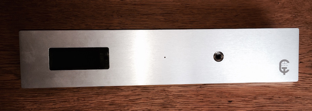

Finally got my faceplate back from the machine shop ... finished pics coming after this weekend's build session ...
Nice avatar logo depiction. Is it laser etched?
Yes ... laser etched
Do you outsource the Laser etching or do you have your own machine? Curious about acquiring a small machine for projects..
I have a local shop that does all my machining and laser work.

Craig: Nice front panel design! I'm waffling between a metal or exotic wood front panel on my next few projects...

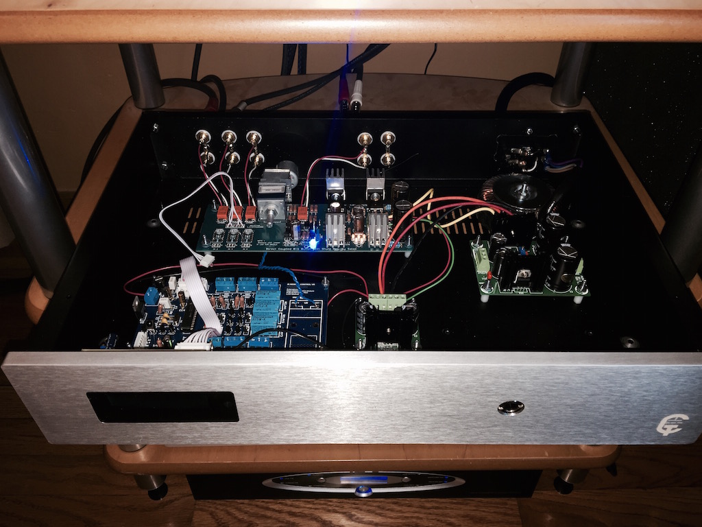

I got the boards all mounted in the chassis. The remote control from Analog Metric runs the Alps pot no problem. I have having issues getting it to control the input relays. The remote board simply switches a transistor to connect the relay - to GND, so I tied the GND's of the Mez and the remote board but when it switches, it blows a fuse on the AC line. I am powering the remote PCB off a 7809 regulator between one set of the secondaries of the same transformer connected to the Mez. Does it matter if it is the positive or negative Mez supply secondary as long as the CT is GND on the 7809?
The remote control board is a PIC that is switching a B550 to GND, so I was thinking if I tied the GND of the Mez and the Remote board together, those transistors would power the relay coils on the Mez. At least that was the thought ...

You should use one or the other power source and control. Not together.
It has to be possible. The audio signal never leaves the Mez board and the controls are simple relays and motorized pot. I see no reason the controls for those devices can't reside off-board. The motor for the volume works fine, I just need to be able to control the relays now.
I tried powering the remote board off of the Mez 12V reg, but it drew too much current and shut down.

Craig, I'm working through this same issue right now. My remote control board has volume and switches up to 4 inputs (with mute- which disconnects all inputs). I was looking for a way to remove the relays that came with the remote board and have the remote board directly control the relays on the DCB1, but they use incompatible voltage levels (remote control boards runs on 5V, not enough to drive the 12v relays on the DCB1 board).
So, I will use the relays that came with the remote control unit to replace the rotary switch for input selection on the DCB1. Thus, my build will have 2 sets of relays.
Cut the +V and ground to the relays from the Mez power and use the controller's?
I thought about that ... the only bad part is the controller is 5V so I would need to replace the relays with a 5V version. They are a pain to replace too as I did one already and did a little damage to the PCB. I was hoping to just find a way to easily tie the grounds of the 2 boards together to just switch them.
