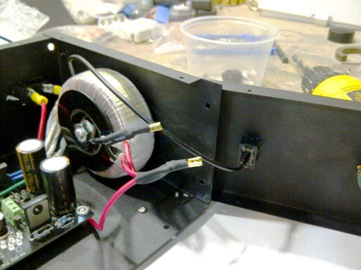

One last question, as I am just about to power up my DCB1 for this first time, and I don't want to smoke something.
Have I hooked up the transformer correctly to the 3 prong power switch?
(Not sure if you can see the picture clearly but...)
Black wire straight from the IEC to the top of the switch.
Blacks from the transformer joined, then plugged in to the second prong of the power switch.
...and finally Red wires, as well as a live from the IEC, joined together and plug in to the bottom/last prong.

Is it that model? http://www.antekinc.com/pdf/AN-0515.pdf
If yes, then you go red/red, black/black to live/neutral, inner blue/green to dcb1 connector's center, outer green to one outer connector's point, outer blue to the other outer connector's point. 3rd centre IEC prong you drive it to chassis. You switch black/black or red/red if with a single pole mains switch.
Use the bulb tester as already advised.
Power up the transformer alone through the bulb tester.
If OK add the DCB1 to the transformer.
Power up through the bulb tester.
If OK then put it all in a case.
Power up via the bulb tester.
When you have completed ALL modifications do a final power up via the bulb tester.
Finally put the bulb tester on the shelf for the next project.
Listen to your DCB1 & system.

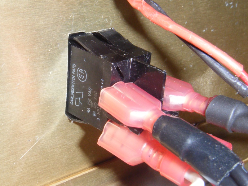

Hi Fred:
Your initial description of your switch wiring sounds very wrong. Your "3 pole" power switch must be a single pole double throw switch. It connects the center contact (think of it as the "output" contact) to one of the other two, depending on the position of the switch. So it can only be used to switch one leg of the AC circuit, either the live or the neutral. Connect one side of the transformer primary windings (the 2 reds or the 2 blacks) to the center contact, and the hot AC from the IEC socket to one of the outside terminals. Leave the other side unconnected (but insulate it for safety). Connect the other side of the transformer secondary directly to the other leg from the IEC.
Then disconnect everything and throw the switch away, and replace it with a double-pole switch! With a double-pole switch you will interrupt both legs of the AC and so can never be caught out by a miswired AC receptacle.
Here is a picture of my double pole single throw switch:
The terminals on the top are to the transformer, the two black leads on the left and the two red leads on the right. The terminals on the bottom connect to the IEC socket, neutral on one side and hot on the other.
Either way, make sure there is a fuse in series with the transformer primary, 0.5A should be plenty.
