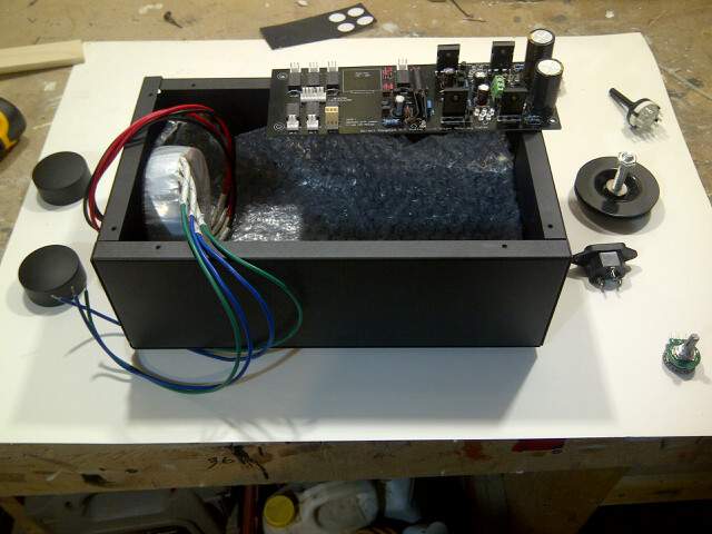

Help connecting Power and Selector Switch to Mezmerize
NOTE: I posted this over on Audicircle, but have yet to get the full answer
Hello Folks, I recently received a fully stocked Mezmerize Board and plan to put everything together in a case this weekend, however I have a few questions that I know you good people can easily answer.
Wiring the Antek transformer to 110V
I have 2 Black and 2 Red wires to connect to the 110V IEC, so do both pairs need to be connected, or just one. Does it matter which wires are connected where? No ground wire is used?
Powering the Mezmerize Board with the Antek Tran 12V
Again, I have 2 Green and 2 Blue wires coming out of the transformer, how exactly do these connect to the Mesmerize Board?
Selector Switch to inputs on Mezmerize Board
Included in the bundle, was an Alpha 7M4 Selector Switch. I understand this Selector Switch connects to the boards Selector Pins and Ground, but again I am confused how this is to be wired. Any assistance/explanation as exactly how this is done would be greatly appreciated as I’m a bit/very confused.

Is the Selector Switch actually in the signal path, or on the Mezmerize board is it purpose simply to engage the correct relay/input. Curious?
I plan to run an output for a Sub, in addition to an out to the Amp. No problems in doing this? And is as easy as taping a second set of RCAs of the first set of outputs?

Not really a guide needed. Just use 10 Ohm 3-5W setting resistors and bolt the Mosfets to the case or to a sink, using insulation pads.
Fredly:
Regarding the switch, no it isn't in the signal path. It just energizes the relays. You just connect a row of its pins to 1,2,3,4,5,6 as depicted on board and their respective ''output'' pole pin to GND.
Regarding an output split, better put 100R in line with the ''hot'' RCA pins of the extra output, its buffering it better.
As for the Antek, someone who used that particular trafo may reply you the wire colors, but some communication with the company would give answers too I suppose. For its secondary side you need to know which colors are making a center tap. Those are going to the center screw of the green connector, the others to the side screws.
