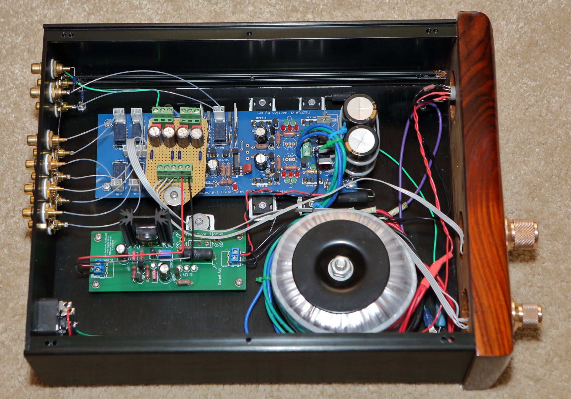

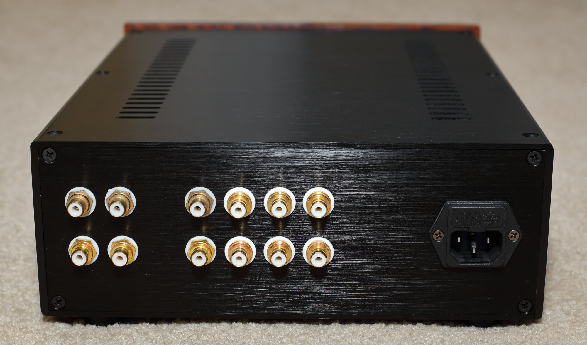

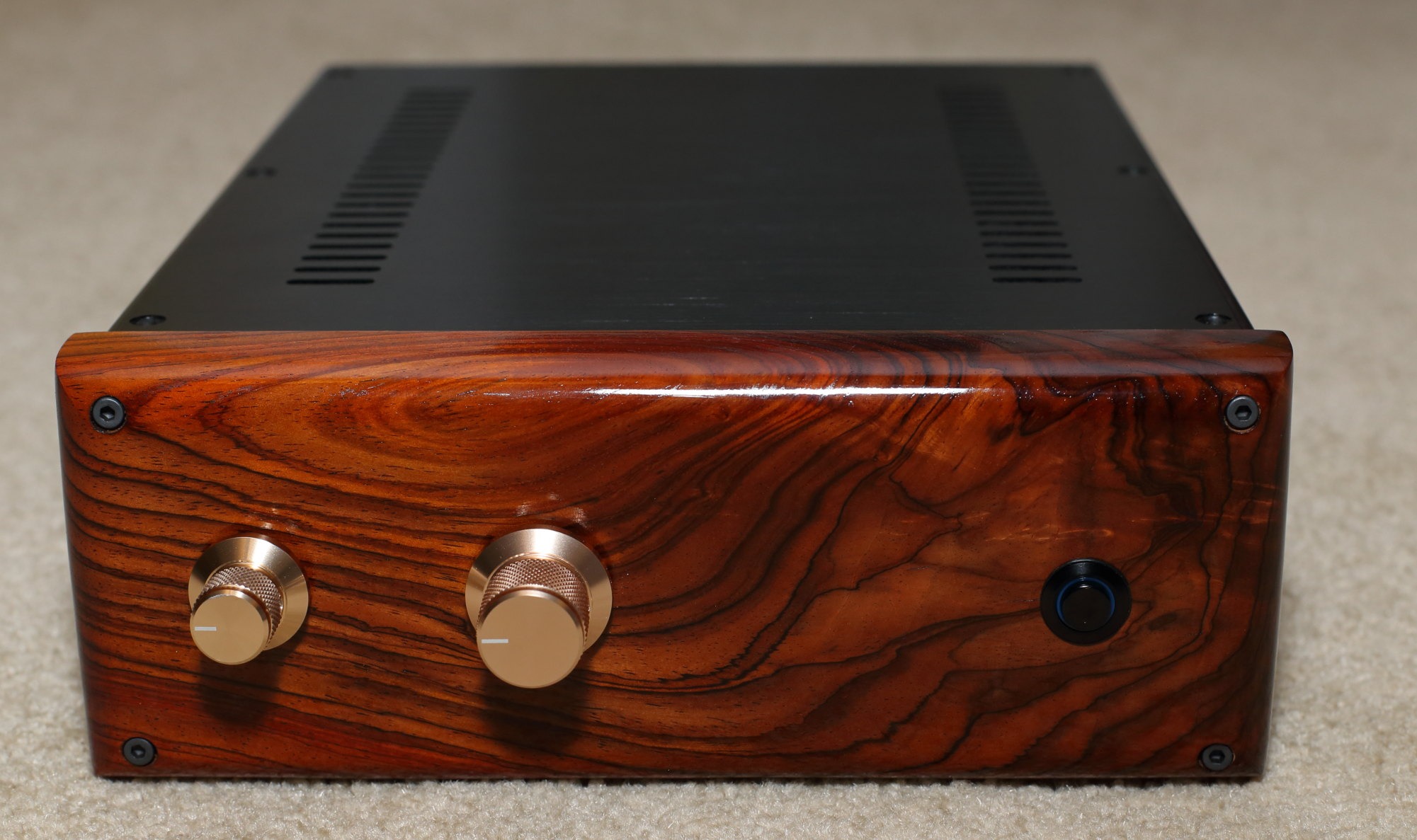

I've had this "built" and somewhat usable for several years now. Three and a half years ago, I mounted the boards in this chassis, but never put a face plate on it. The regulator mosfets are mounted to the chassis floor and I've used 6.5w 4R resistors to bias the DCB1 regulator. So, here it is, finally finished.
It's got four inputs and dual outputs, with outputs separated by 100R. The volume control is a matched set of LDRs that I picked up from Uriah ages ago, and they're driven by one of Salas' nice 5v shunt regulators. The front panel is piece of Cocobolo that I picked up several years ago and finished with some Formby's Tung Oil Finish. Now my only challenge is finding those little screws that hold the top plate in place - can't remember where they went :scratch1: ...

Congratulations! A really nice medium form factor build with an aesthetically pleasing thick wood panel of rich grain. Very good components inside too like Vishay foil resistors in the signal path. Wiring is single strand silver?
By the way LDR volume controls owe to add enough second harmonic holding back from the 0.001% THD+N DCB1 is capable of but subjectively many people like LDR.
