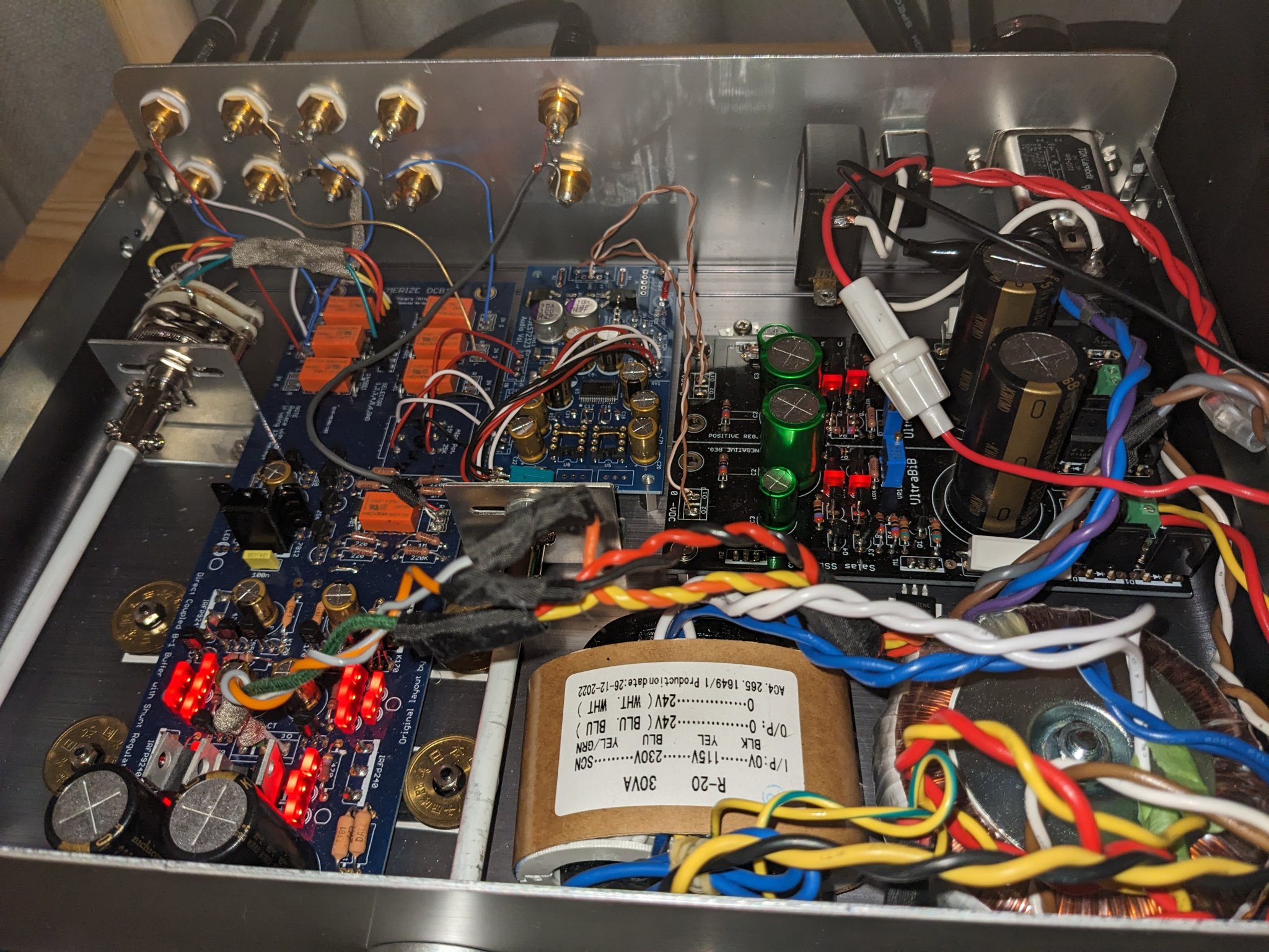

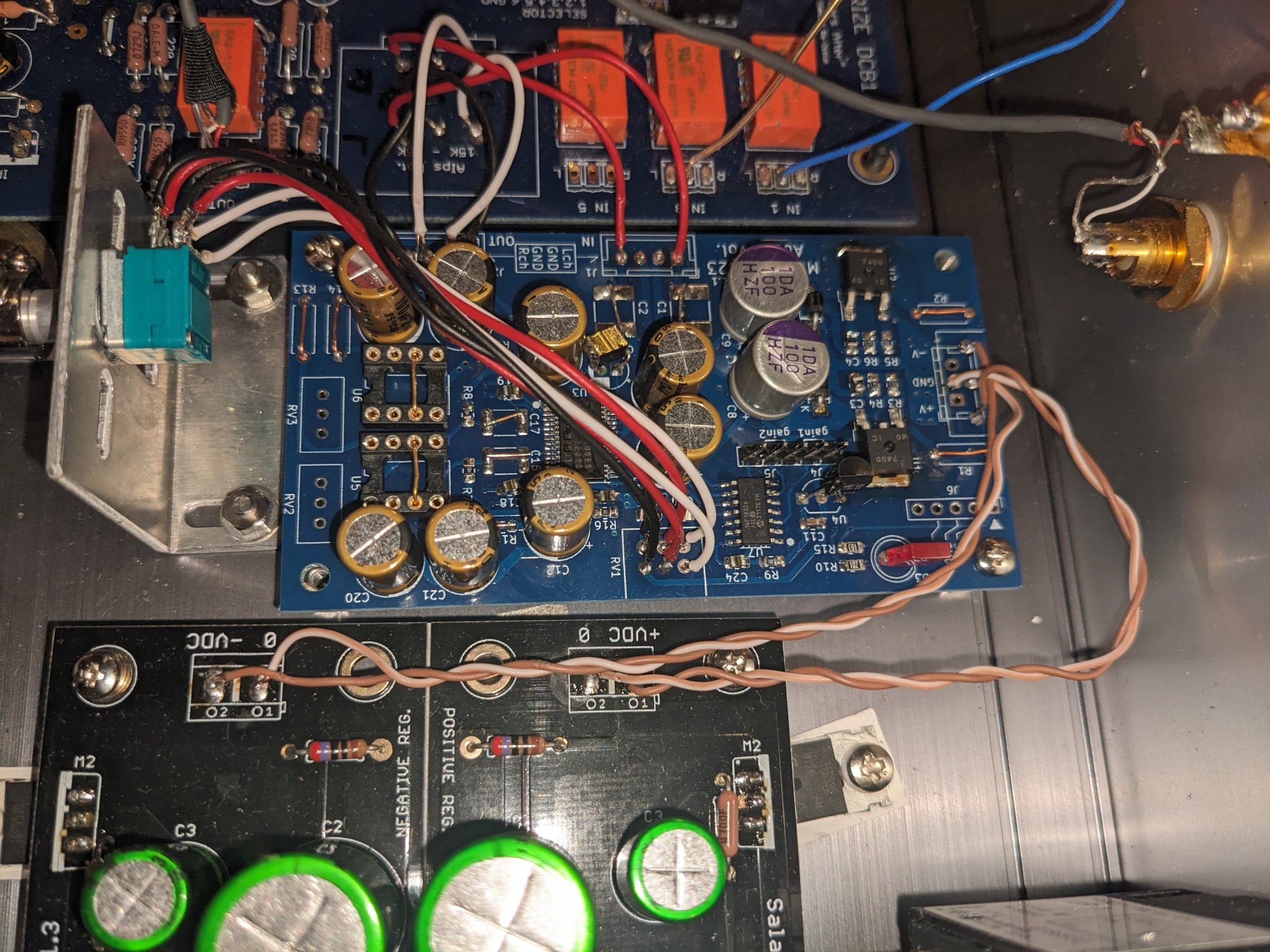

Finished exchanging carbon pot to muses72323.
I prefer muses volume.
diyAudio Chief Moderator
Joined 2002
Nice. Congratulations. I see you skipped op-amps on the Muses board. You skipped the output coupling caps there too. What about the input coupling caps? Can't see for sure what parts are which that far back in the photo. No extra DC offset from the Muses board when skipped parts?
I'm using a pot that cannot be soldered directly to pcb. Whats the correct wiring scheme? For instance for connecting rca sockets with pcb I am using twisted pairs.
Pots have 3 wires per channel. Should I twist all 3 toegether? Should I twist ground and attenuated signal wire cause the signal level is lower than input?
Am I not overthinking this?
Thanks!
