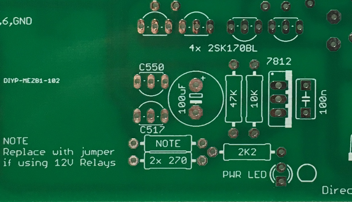

The PWR LED pads on the Mezmerize board* provide for a power indicator LED. There, a 12V source (LM7812) outputs through a 2.2K resistor on the circular anode pad and the square one is ground for cathode. You can either alter the resistor's value for different brightness or use a link instead when there's a resistor in the switch for its LED already.
*Image crop showing the PWR LED area from the Ten Years After Mezmerize special edition board prototype. The production one as available on the DIYA shop is blue with gold pads and thick copper.
Thanks @Salas for pointing that out. The actual procuction board doesn't have such designation (and even looking now I can't find where VDD is specified).

1. Does your board have "Ten Years After" printed on it but it does not have the PWR LED designation? Maybe its one you bought before the TYA issue? In any case it should have a 2.2K resistor and one LED at the same places.

- Sorry, *please* forgive me. I looked over the board when I received it and it looked identical to the board shot on the DIY store. They are close, but there are subtle differences; so mine does have the power LED designation like your attached picture does (when the store picture doesn't).

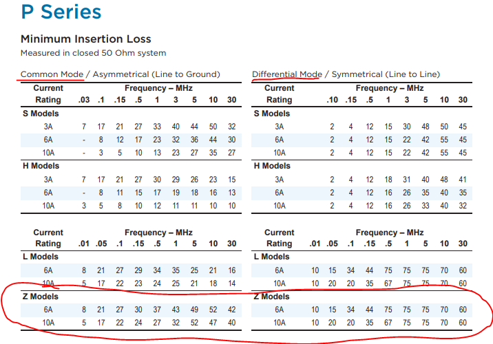

- Sorry last/new question: Would a filtered power inlet provide any benefit? TE Connectivity's P Series Z Models appear to offer some benefits at least down to 10kHz. See attached. If it's not worth the trouble or cost(!), I'll stick with a Schurter non-switched fused inlet.

4. Yes only use them at the secondary output. Use something like a Vishay CMF50100R00FHEB
5. Its not a very susceptible circuit due to no voltage gain and line level operation. The majority of its builders did not show mains filters used but such extras even when there's no specific polluted power source problem to address they are not harmful either.
