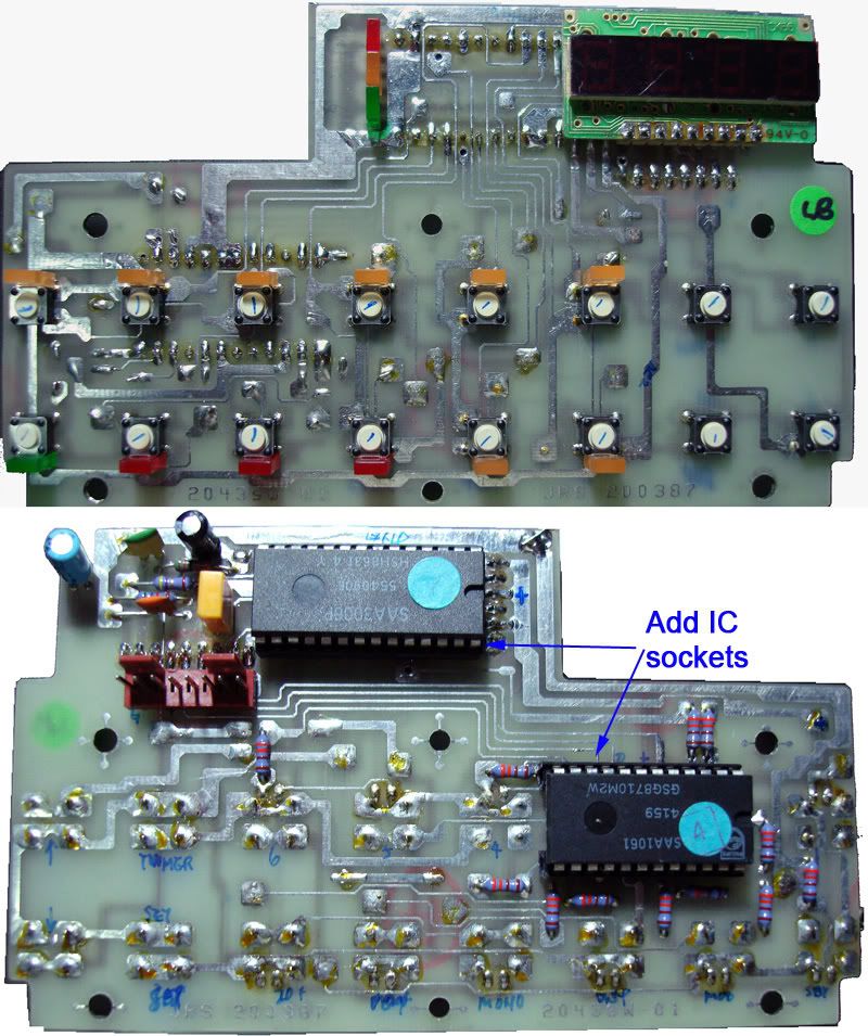

i've got same issue here - did u replaced only the both SAA's ? or is the display module also affected ? (i have a newer design on PCB, do not need to unsolder it for IC change)
- what should i check before i plug the Mains?
thanks for any help, Mitsch

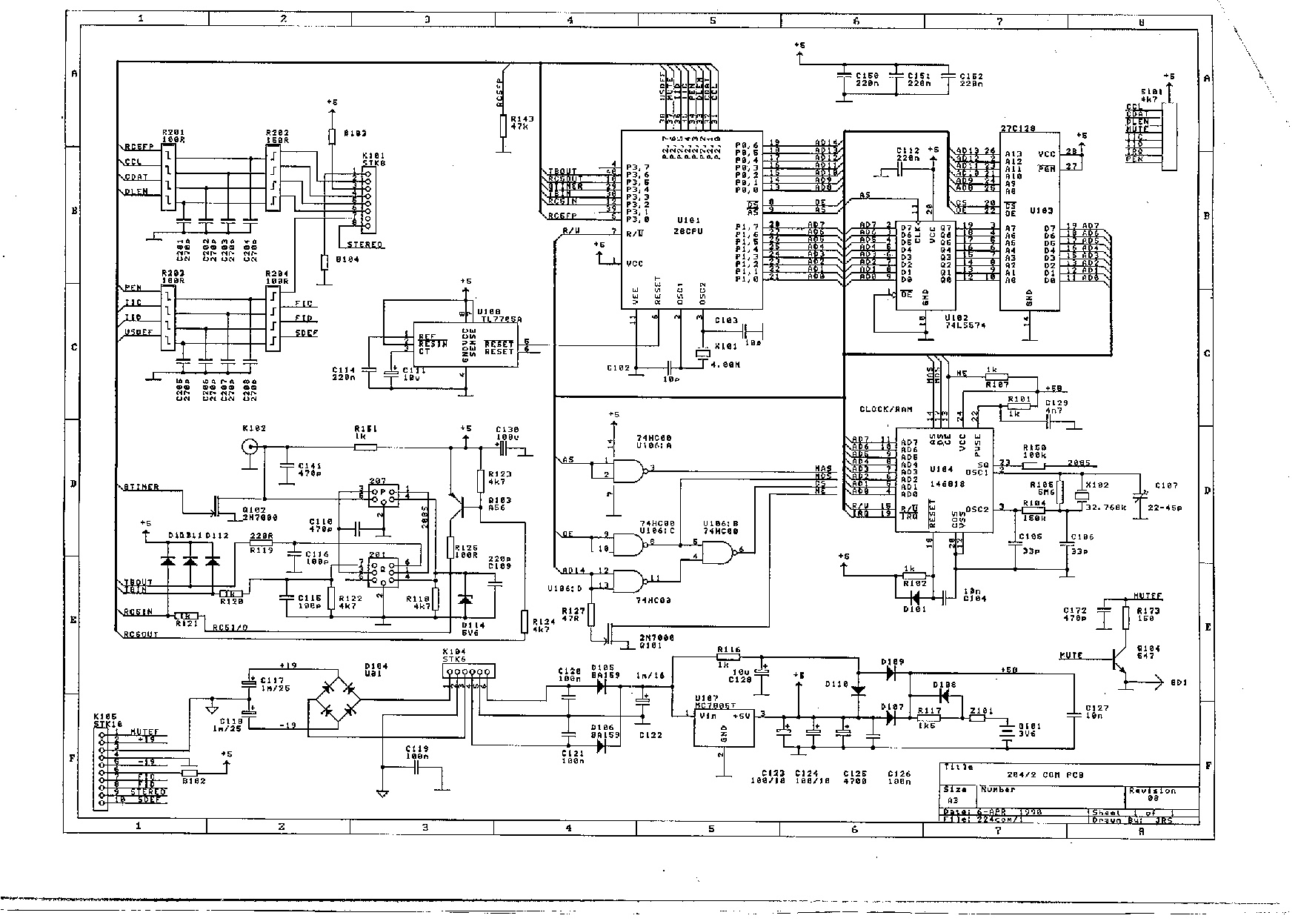

my Meridian 204 tuner is also working again, but it was more then just the Battery to replace...it was:
key driver chip, display driver chip and even CPU!
i have a scheme as pdf if anyone needs it...
CPU: if there is something like in between Hi and Lo (+/-3V) on Busses, it has to be replaced...
a fine tuner who is worth to be repaired...i like it, but if anybody wants it, i cold even sell it...
stay FM!

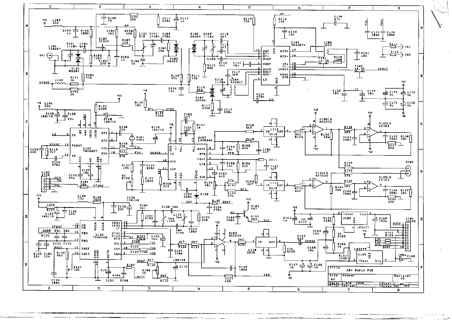

scheme!

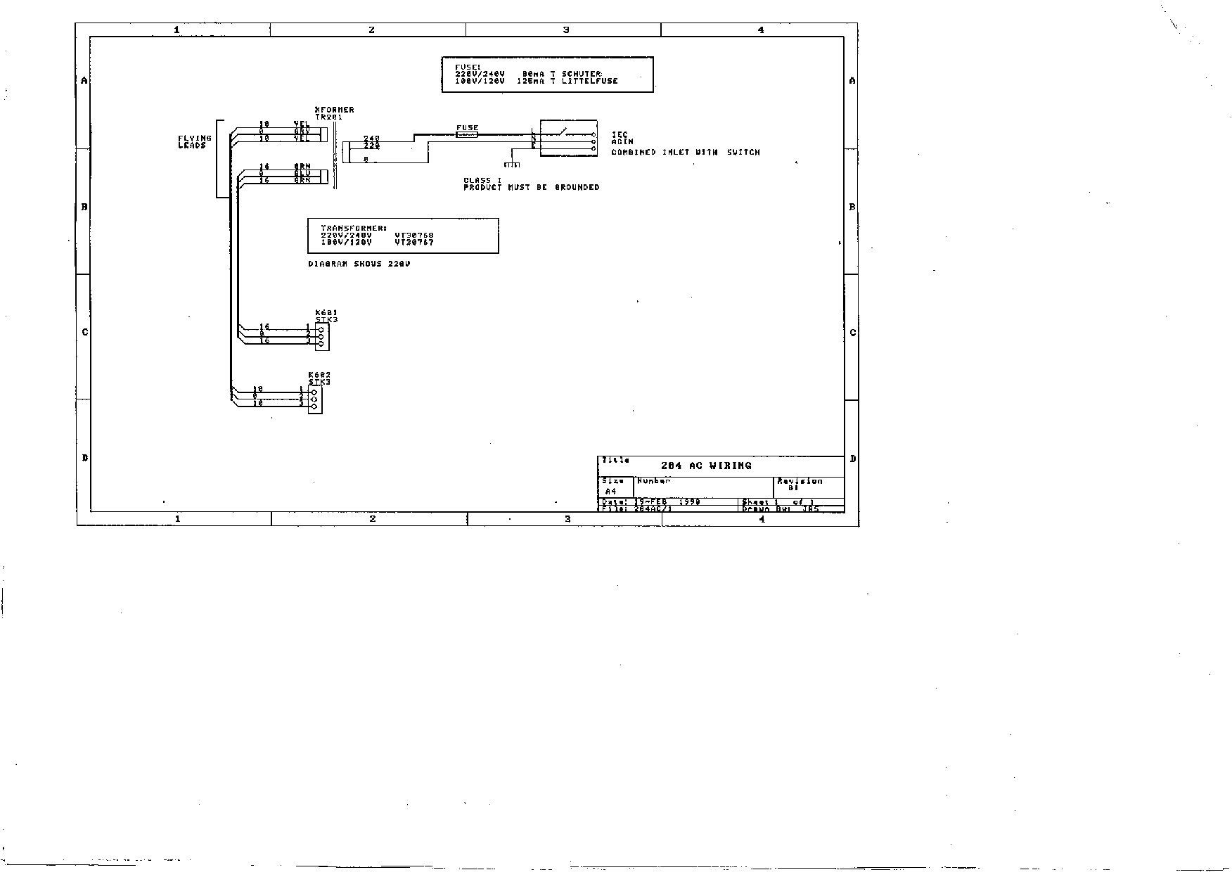

this is what may help! good luck! sorry, no rc- codes...
