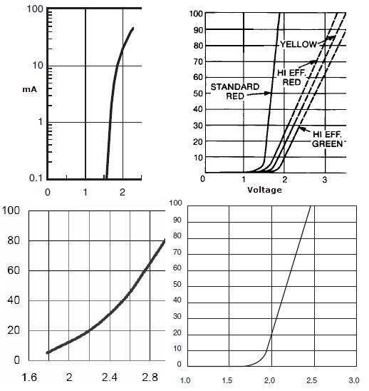

LED's sure don't seem to behave like a constant voltage source. Just got around to sorting the batch of 200 cheap LED's. I was looking at them between 15 and 35 mA.
They ranged from about 2 to 2.4V drop. 20% variation is not what I call constant voltage.
At 24mA, the selection of 200 ranged between 2.10 and 2.16V, pretty close to a standard deviation around 2.13. Now I am burning in a string to see if they change over 24 hours.

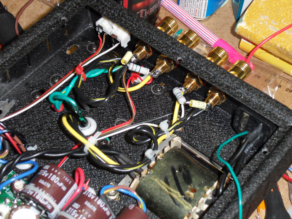

Pic is too small to see clearly, but is that point-point rewiring?
Gary
Hello,
yes, I´m rewireing the amplifier.
Bild: heater-connection003yokz.jpg - abload.de
I had to mod. the transformer in order to obtain a stable 12,6V AC heater winding ( both 6,3V windings dropped the voltage below 5,4V AC ).
I can post the schematic of the new amplifier too.

A string of LED's dropping 14.00 volts and 22mA, 48 hours and still dead on 14.00V.
So, no drift, just sure not 1.6V. I wonder if these 5 cent wonders have a resistor in them? That would explain their higher than expected drop and their less than constant voltage operation. I will compare some older LED's I have.
It would be typical to have a fairly large voltage drop variation in LEDs. They are indicator bulbs after all, so I wouldn't expect accuracy or consistency in items made for the consumer appliance market.
No, they won't have a resistor in them. You'll just have to hand pick them for the task.

There are a couple different structure/dopant red LEDs. I don't know if the old cheap 1.6V ones are still made or not. The advantage with them is supposed to be lower dynamic resistance.
You will get a good bit of variance in voltage from unit to unit. However once nder constant bias, each one should hold it's voltage drop with good stability.

The extra 3 windings around the transformer, how much do they raise the voltage of that heater winding? I guess you need special wire, where do you get that? Or will just normal solid copper wire be OK? Is that a 555 on the PCB, to delay the B+?
Tvr, the voltages depend a lot on the material used to make them. 2V at 22mA is pretty normal in my book, 1.8V @ 15mA is difficult to find these days.
Edit - sorry missed your post Gimp. Yes, what Gimp said!

Hello Ian,
I´ve built a additional circuit board for the dc heater (input tubes) and the NE555 delay circuit for the anode voltage. I can post the circuit too although I guess it is not hard to figure out.
Unfortunately I have to use a voltage doubler and stick with the original chinese power supply in order to obtain 400Vdc.
I´ve connected the mod. 6,3V winding in series and used some spare enameled copper wire and have a stable 12,6V winding ( EL34 connected in series, parallel. I use the 12,6V winding for the additional circuit board too ).

That is the idea, but if I had a constant bias, then I would not need an LED, a resistor would be fine. I tested a bunch of odd ones I have. All react about the same. The point is they do not maintain constant voltage with varying current. About 10 times better than a resistor, but not constant.
Handy chart. Never seen that before. I would bet everything is "high efficiency" now. Slope is about right.

Tvr, with the LED's, I agree they do not appear to be a constant voltage source (or is that a sink?) But better than a resistor as you say. I found 500mV rms on the cathodes at clipping with LED arrays. Something with a better dynamic impedance than an LED would be a straight piece of wire and use fixed bias. Seriously though, I found the LED's to sound very good. I have not compared it to fixed bias yet.
George from Tubelab tried some LED's in his Simple PP amp prototype, worth reading. Read more here. Interesting that George found less distortion with individual LED arrays, vs a combined array for each output pair.
