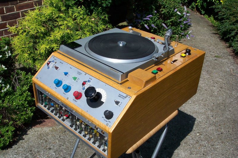

I have to say this combo looks the biz. Memsahib does NOT agree :)
Right need to look again at those FR plots George did.

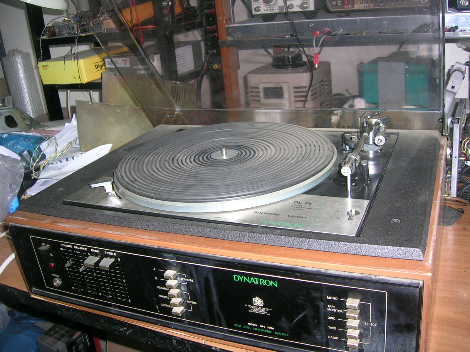

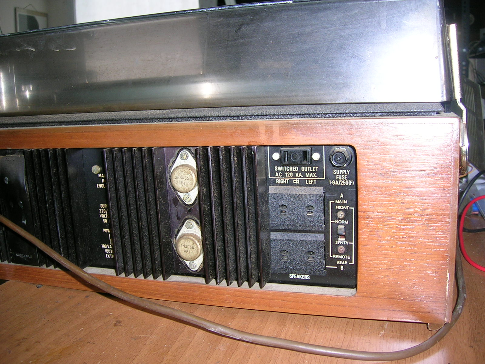

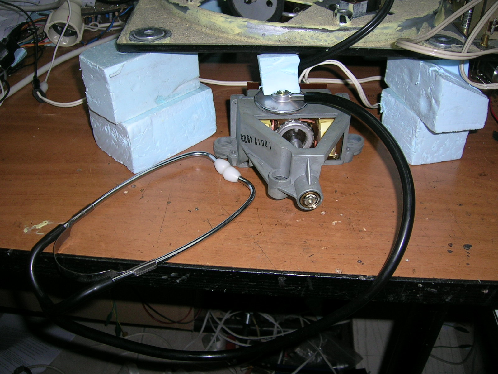

Seeing old turntable decks. I am wondering which vintage turntable had a very well made motor. I have collected some Garrard Synchrolab, A Garrard changer Motor, A Sansui Direct drive motor. I also had a Philips simple motor like this. Strangely when touched Garrard Lab motors had significant vibration but Philips was very quiet. All Motors were clean/lubricated .
Also would like to sneak in another question What RPM are these garrard motors ? Example 1. another is exactly similar but with steel shield plates.
Thanks.

George: It's a technics SP-10 with BBC MP1/18 and Shure SC35. I know that they specified this for local radio and Radio 1 (pop station). I guess the EMTs were for classical but not sure.
What is interesting reading the MP1/18 spec is that it was designed to work with the SC35 to give a 14Hz LF resonance. See they read the B&K papers and acted on them :)
