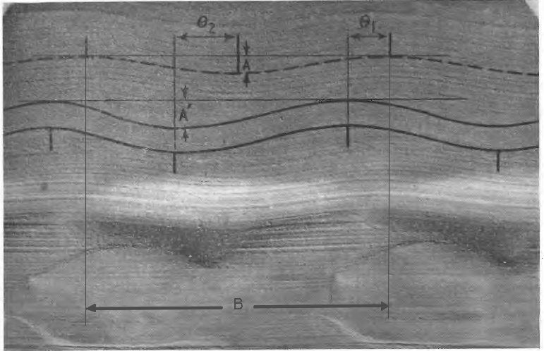

Thanks to Hiten for finding and posting a link to Walton's 1963 WW article. A few years had moved on since 1961, but looks like the same SEM images were still the basis of discussions.
Putting aside the narrative, the article hints at image 'flattening', which I take to mean scaling the vertical size by an increase of sqrt(2) so one can look at the surfaces of both grooves at the same linear and vertical scale. However, although the author doesn't describe what is meant by flattening, a factor of sqrt(2) would tally with top groove width being about 60um, much more reasonable IMO.
Attached is a geometric markup, mostly Walton's, with addition of dimension B the wavelength of recorded tone. The ratio of dimensions B to A is at issue.
IMO, this image is reasonable proof that the test record can't have been SXL 2057 (10kHz one channel 5cm/s rms at 14cm radius). However it is consistent with 10kHz one channel 15cm/s rms at 14cm radius which (elsewhere) the author considered a target for trackability. Which is extreme.
Personally, I doubt the track portrayed by the image is trackable by any 'normal' cartridge, representing about 1350G acceleration.
So my personal opinion of the likely circumstance of this series of SEMs is that it involved permanent damage probably caused by mistracking an extremely testing track, and use of excessive VTFs in an attempt to force the stylus to trace. But it appears as though the stylus bounced along the modulated wall, hitting rising slopes and elevations, whilst tracing its own locus which had not much to do with tracing the groove, other than the 10kHz once per cycle touchdown. Hence the weird phase offset and unnatural duty cycle. On some of the SEMs, I speculate that excessive VTF led to gouging of the unmodulated wall.
My opinion is that discussion/theorising on the basis of those SEMs should only embrace the most likely test conditions, which unfortunately appear different from those described/used as the basis for much narrative discussion and conclusion.

Yes, thanks again for the WW article. Form that and Bill's scans we can conclude that it isn't the Decca LP, as it's stated that only one wall is modulated. I don't see anything on the Decca test LP to indicate modulation to only one channel. Has anyone else - I don't have the disc.
Also from the WW we can conclude that that the signal wavelength is 48.76µm. It is given as a 10,000 kc/s signal at 11 inches. That means 48.76 cm/s linear speed at that diameter resulting in a 10kHz wavelength of 48.76 microns. Using that scale it puts the groove width at 68µm, right about where it should be.
You might want to check my math on that.

I suspect the flattening was a double exposure with rotation of the sample so the elecron beam was impinging directly on the wall of the groove rather than from above. That may be the 'special technique'. Bearing in mind that the first commercial SEM was 1965 whatever they were using at salford was either a lash up or borrowed time on another machine.

Yes, perhaps - that would give the same result, that one is effectively looking at the groove faces flat on with the same vertical and linear scales..........I suspect the flattening was a double exposure with rotation of the sample so the elecron beam was impinging directly on the wall of the groove rather than from above. That may be the 'special technique'. Bearing in mind that the first commercial SEM was 1965 whatever they were using at salford was either a lash up or borrowed time on another machine.
That would still imply the test record isn't Decca SXL 2057 though.
The image is definitely one channel only modulated, BTW, Pano. The marks at A are witness lines from the cutterhead, following the groove base up and down which happens when one channel only is modulated.
LD
The wavelength works out correctly for 10kHz, but the issue is the modulation amplitude which works out about x3 what it should be for SXL 2057................ on the markup amplitude is A, and wavelength is B.Given that, maybe it does work out to be the Decca LP after all - if my wavelengths are correct.
LD

Walton's August 1961 Wireless World article that Bill previously cited has the same SEMs with the following explanation of how they were obtained. The "flattening" is mentioned.
". . .all these micrographs are of the 10kc/s band of the Decca stereo frequency test record (SXL 2057). This photographic evidence has been prepared by Dr. P. Chippendale of the Royal College of Advanced Technology, Salford, by a process which he has specially developed. The electro micrographs are taken from carbon replicas of the groove walls. During the replicating process the carbon film becomes somewhat flattened and therefore some of the indentations will in fact be deeper than they appear. There is also some buckling at the bottom of the groove (appearing lighter). Small cracks occasionally appear in the replica because of the very delicate nature of the carbon film. In spite of this the lines left by the cutter still provide a datum for accurate quantitative interpretation."

Thanks Charlie. I don't doubt in good faith Walton believed that to be true. However, the SEMs apparently contradict that the record could have been SXL 2057. Here's a proof of the contradiction that one can check over for oneself:Walton's August 1961 Wireless World article that Bill previously cited has the same SEMs with the following explanation of how they were obtained. The "flattening" is mentioned.
Consider just the unmodulated wall cutter head witness marks on the SEM, which Walton acknowledges, and the vertical motion of the cutterhead they have recorded.
For sine modulation D = Dpeak sin(wt) [m] (1)
where Dpeak = peak displacement [m]
Instaneous velocity = dD/dt = wDpeak cos(wt) [m/s] (2)
Peak velocity Vpeak = wDpeak (when cos(wt)=1) [m/s] (3)
Rearranging (3):
Dpeak = Vpeak/w [m] (4)
______________
For Decca SXL 2057: V = 0.05 [m/s] rms, f = 10kHz [Hz]
Vpeak = 0.05 * sqrt(2) = 0.071 [m/s] (5) ; converting rms to peak for sine
w = 2 * pi() * 10000 = 62831 [radians/s] (6)
Substituting into (4)
Dpeak = 0.071/62831 = 1.1E-6 = 1.1 um [um] (7)
Dpeak direction is normal to 45 deg groove wall.
Vertical peak displacement Dpeakvertical = Dpeak/sqrt(2) [m] (8)
Then Dpeakvertical = 1.1E-6/sqrt(2) = 0.8E-6 [m] = 0.80 [um]
________________
From (8), Decca SXL peak vertical displacement of witness marks from cutter head = 0.8um (9)
From SEMs, using 10kHz wavelength (B) as a scale marker, verified by top groove width, measured peak vertical displacement (A) of cutter head = 3.0 um/sqrt(2) = 2.1um .....or 3.0 um if not 'flattened' (10)
Allowing reasonably for arithmetic and measurement error, (9) and (10) are certainly contradictory. Therefore that the SEM is an image of Decca SXL2057 as described is shown to be contradicted.
This is why I consider the SEMs can't be for SXL 2057 as described.
LD

1961 would have been very early days for SEMs, and the process of carbon sputter coating a sample might have then been considered new I suppose? A sample has to be conductive for SEMs to work, of course, things we now take for granted. The coating might fill voids to an extent and thus 'flatten' the surface, though the witness marks from the cutter head on the unmodulated groove wall are plainly visible.
BTW, in my post above w is angular frequency, 2πf, and [square brackets] just state units or dimensions, of course.
LD
