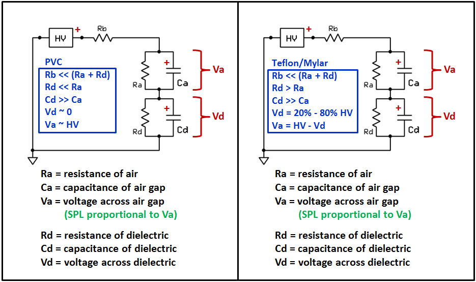

With EHT I can get 100dB of pink noise. With film connected directly to the center tap I got 75dB. I don’t know how significant that is? I have to turn off the EHT before removing it and then I can see the SPL go down.
How long was the EHT turned off before you removed the connection?
This will have a big effect on SPL level when you remove the HV connection and connect diaphragm to CT.
If the charge is on the stator tape how does it make sound?
It is not the charge stored in the stator tape that directly makes the sound. Rather it is the charge stored in the stator tape that charges up the air gap capacitance when the diaphragm is connected to the CT. The voltage across the air gap when its capacitance is charged is what produces the sound.
In a simplified lumped model, you can think of the air gap capacitance and stator tape capacitance as two capacitors in series. The voltages across each capacitor will be in the ratio of the leakage resistance associated with each capacitor. With PVC insulation, its leakage resistance is much less than that of air, so essentially all of the EHT voltage appears across the air gap capacitor. With Mylar, the leakage resistance is similar or larger than that of air so a large portion of the EHT voltage appears across the stator insulation capacitance and the remainder across the air gap capacitance. Remember SPL is proportional to the voltage across the air gap.
http://www.diyaudio.com/forums/plan...truct-cube-louver-acoustat-7.html#post2154621
The stator tape capacitance is much larger than the air gap capacitor. So, when the EHT is disconnected and diaphragm connected to CT, the larger stator capacitor now acts like a voltage source and discharges the air gap capacitance and then charges it with the opposite polarity to a voltage equal to its own. This is what causes the polarity swap.
I will make a few illustrations later today to better explain.
Perhaps 10 seconds. However I Think the EHT (which is a high voltage tester actually) discharges rather quickly when turned off. Perhaps I should retest with my ladder type EHT.
Any illustrations would be great, thanks!!

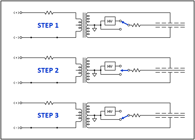

Attachment #1: For the best test, you would not discharge the EHT supply at all.
Step 1 ==> play pink noise thru ESL with EHT supply connected for 5 minutes.
Step 2 ==> with pink noise still playing, disconnect EHT supply.
Step 3 ==> with pink noise still playing, connect CT to diaphragm.
- If minimal charge is being stored in the stator insulation dielectric, the SPL will continue to decrease with time.
- If significant charge is being stored in the stator insulation dielectric, the SPL will decrease at first reaching a minimum and then start building back up in level with reversed polarity.
Attachment #2: Here is a schematic of a lumped model representation of an ESL bias circuit. Most wire stator ESLs use PVC insulation which is pretty leaky as far as insulation goes with bulk resistivity much less than air. In this case(shown on the left) the majority of the EHT supply voltage appears across the air gap capacitor where it contributes to sound output. If “better” insulation is used like Teflon or Mylar, the insulation resistance is similar in magnitude or even higher than that of air. In this case(shown on the right) a significant percentage of the EHT supply voltage will appear across the insulation dielectric, leaving only a portion of the EHT voltage across the air gap where it needs to be to contribute to sound output.

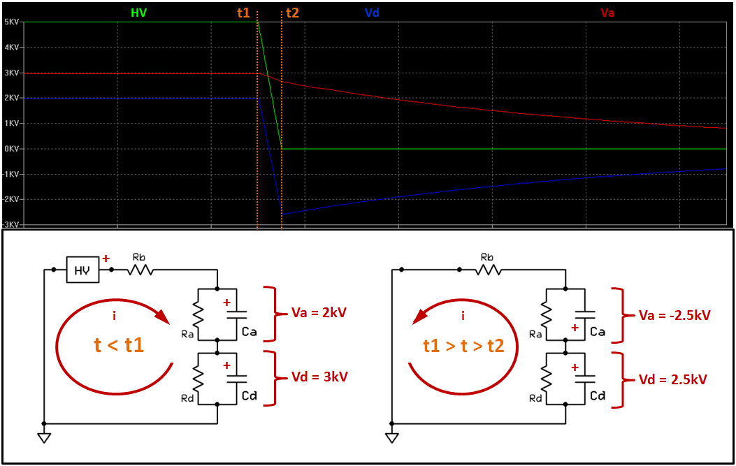

Attachment #3: This is a time history of voltages to show what is happening when you perform the test shown in Attachment #1. The voltage values and trends aren’t meant to be an exact model of anything in particular; they are for illustrative purposes only. Cd was about 20x greater than Ca, which is pretty typical. Rd was just a bit more than Ra. Note that it is the relative values of Rd and Ra that determine the voltages across Cd and Ca(not the values of Cd & Ca).
Prior to time = t1, the EHT supply voltage of 5kV is connected to the diaphragm and voltage has distributed between the air gap and the dielectric capacitors. In this case, the insulation resistance is a bit more than that of the air leaving only 2kV of the applied 5kV across the air gap.
Once the EHT connection has been removed and the diaphragm is connected to the CT, the current flow reverses direction as the energy stored in Cd charges Ca to an equal and opposite voltage during the time period t1-to-t2. An equilibrium is reached at t2 with ~2.5kV across each capacitor.
For times after t2, the resistance in parallel with each capacitor will slowly discharge them. Any imbalance in voltage across the capacitors will result in current flow from the Cd capacitor to restore equilibrium. How slowly the voltage and SPL decays will depend on the values of the leakage resistances and how much charge had been stored in Cd.
Note that ESLs with high resistance diaphragm coatings will behavior differently from the lumped model described above. However, the general voltage and SPL trends will be similar.

I did retest this, disconnecting the EHT and connecting the CT in under 1 second. No discharging at all. I forgot the microphone at home, but my impression is the same. The SPL goes down a lot and stays there. I may have some leakage that I have not considered. I Think the charge on the film disappears quickly. I dont get the spark when I connect the CT to the film.
I will try to remove the insulation on the stators in one of the four Squares, shouldnt be impossible. Will there be any problems with the film having more charge in one of the Squares?
Based on your latest test description, I would not remove the insulation yet.

Now I get an impluse that is the same polarity as when the EHT is connected. I suppose that means my charge is not trapped in the insulation (there is none...)
Pretty cool confirmation of the principles involved in the behavior of stator insulation. :up:
