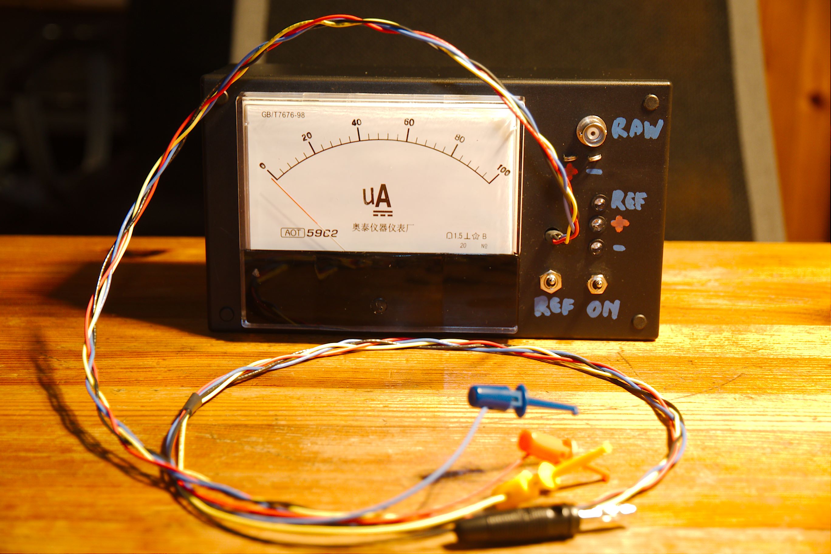

I did build one all parts did fit nicely, tomorrow I will do the electrical testing of the bord (i'm sure it is fine).
But.. one [tiny] problem: I do not have any testable amplifier (at this moment), so, for me, testing this board has to wait at the least 2 weeks (sorry for that :(). I'll be back :)
First result, U1 oscillated and needed a small compensation capacitor. The capacitor C2, in the schema 0pF, has been populated with a 10pF mica capacitor to stop the oscillations.
Using R15: The offset of U1, was adjusted to within 10uV, that seems adequate.
Using RGb: The gain of U2 was adjusted to 1Vdc at VRaw (for a 50mA current in 2 x 1 Ohm between inputs Red, Yellow and Blue [Yellow connected to ground]).
Using R10: The output offset at VBias was adjusted to zero (with inputs Black, Yellow, Red and Blue all connected together).
The circuit passed all tests that I can do at this moment, next measure some bias in a real amplifier :)
Thanks Piersma, let me know when it is build and how it preforms.
Here a picture of my build, it shows placement of the 2.5mm cercaps (the used footprint is a bit confusing).
