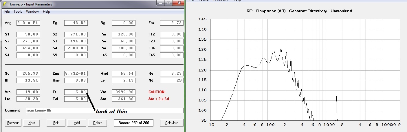

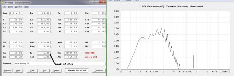

Can you post the hornresp sim for the above graph
Epa, the above data spl chart is not as smooth as post#63 spl chart, I wil drink a cup of coffee and try again later, my processor is still sleeping
i had to adjust a bit to get the fold right in the first part of the horn.
you now have a ripple of 1/2 db or so,
can you see the pic now?
Right now I am not near my computer so I can't see the spl chart post #64
fr/tal is damping matherial.
the input in post 73 is ok but the fr is off.you should get fr like post 63(fr graph post 63 is corrected now)
maybe reinstal hr?
Post 63 and 73 spl chart look different, so which one is the bass cab will produce when built Post 63 spl chart or post#73 spl chart. Just trying to get it clear.
