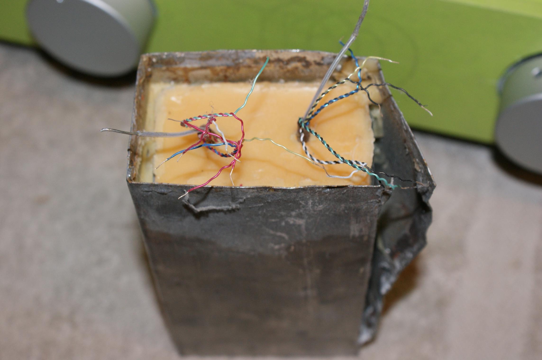

pj
A virtual Slim Whitman Record to be awarded to the person who can recognize the horror my curiosity has committed, here.
Identify:
You get a Slim Whitman Record! Virtually, that is.
slim whitman indian love call from mars attacks! 480x200 - YouTube
It's an M.A. Cotter, it was wired for low output. It was in such good shape, I still have the box and instructions. (somewhere around here) Another one sold for $1300 a few days ago... and I'm doing things like this.
At least you now know what they look like on the inside. It appears to be bees wax.
This is one of the better more transparent units out there.. Why torch it BTW?

I wanted to re-strap it to a different value.
I've been looking for the re-strapping data for about 20 years, and it only now appeared on the internet in the recent past.
I was curious why it was so well respected.
I've owned it for +20 years.
It was obtained NIB at a yard sale, for $15.
I wanted to know it's 'secrets'.
I think I can do better. (Improve via learned techniques and understandings, not design from the ground up)
All of the above prompted me to respond to the itch I've had for 20 years, which is to take the Cotter apart. I already took the unit apart once, due to a broken pin at the solder/board point, on one RCA jack, about 15 years back. This time, I decided to do an actual 'take apart'.
It sits there, halfway done, due to the filler that was found. I expected to find, maybe, silicone, or similar. It appears to be bees wax, or something akin to bee's wax. That is a time-honored method, but feel there are better methods to pursue nowadays.
Re-soldering the unit and reversing the 'damage' is no big deal, easily done.
It is still the best SUT I've ever owned or used, but it can be improved.

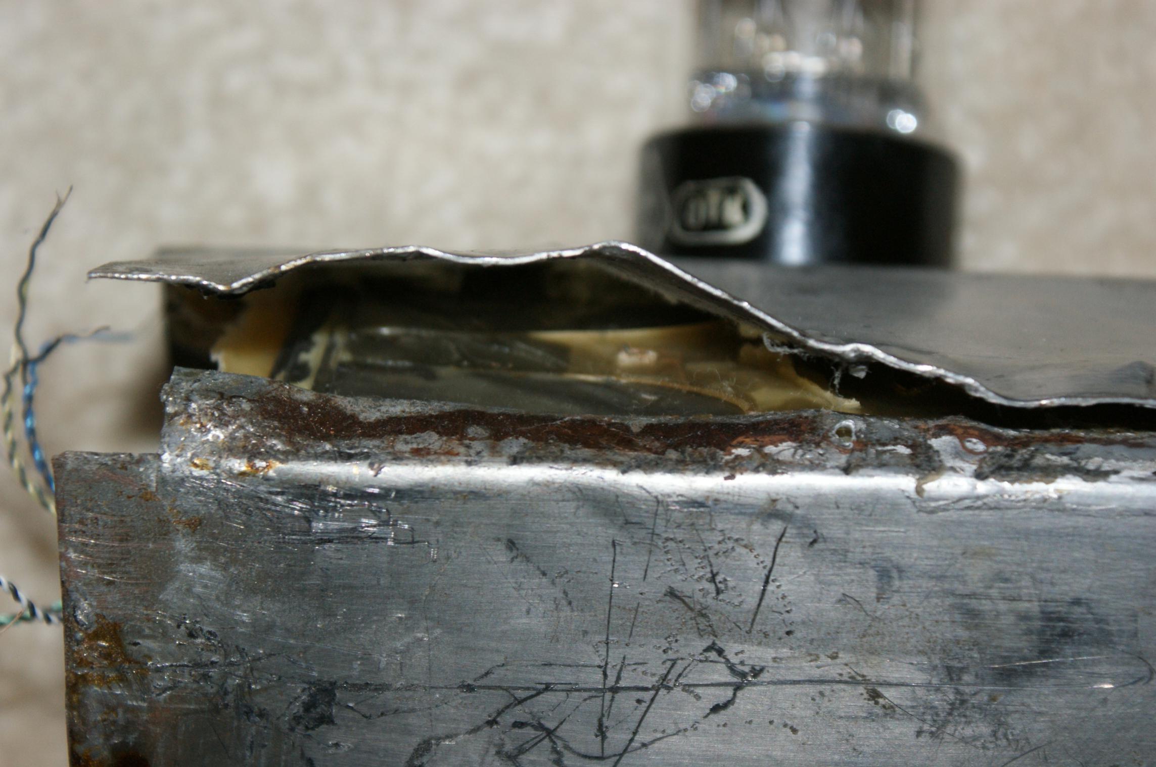

As you can see, from the side view, the 'wax' is only on the end, it is double cased. Looks to be sheet folded, then a thin wax support and end casement layer, where the wires come out of the primary mu folded sheet box (the inner one)

I've got a set of mint 15095's here..just bought them yesterday. I'm looking on the forum for some 'take apart' images, a bit more in depth than the atrocity that I committed to the Cotter.
The Cotter still looks like a horrible road accident. To do it right, I'd have to spot weld it. But that requires that I get the wax out first.. I look at it, think about the complexities..and then I walk away and do something else. So there it sits, only needing a jar and some formaldehyde, and trip to the audio museum.
