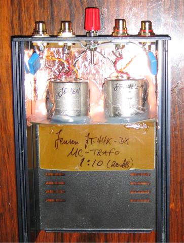

I cannot remember the Lundahl type, I use Jenssen, that I bought used, and glued into a small box. (I did not have any mounting-hardware).

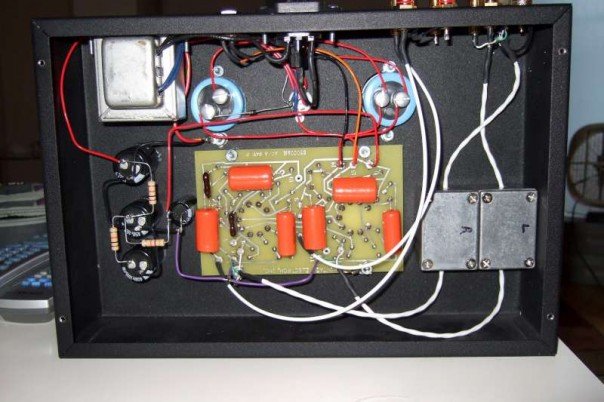

I ended up going with the LL9206's in the end and think they sound amazing. I can not say that I have much to compare them to for transformers but I am happy with the purchase. They are in the shielded metal cases in the bottom corner. It took a lot of grounding but it operates without any hum or noise with a nice set of 5751's. I'm using a Sony XL mc1 MC cartridge.
