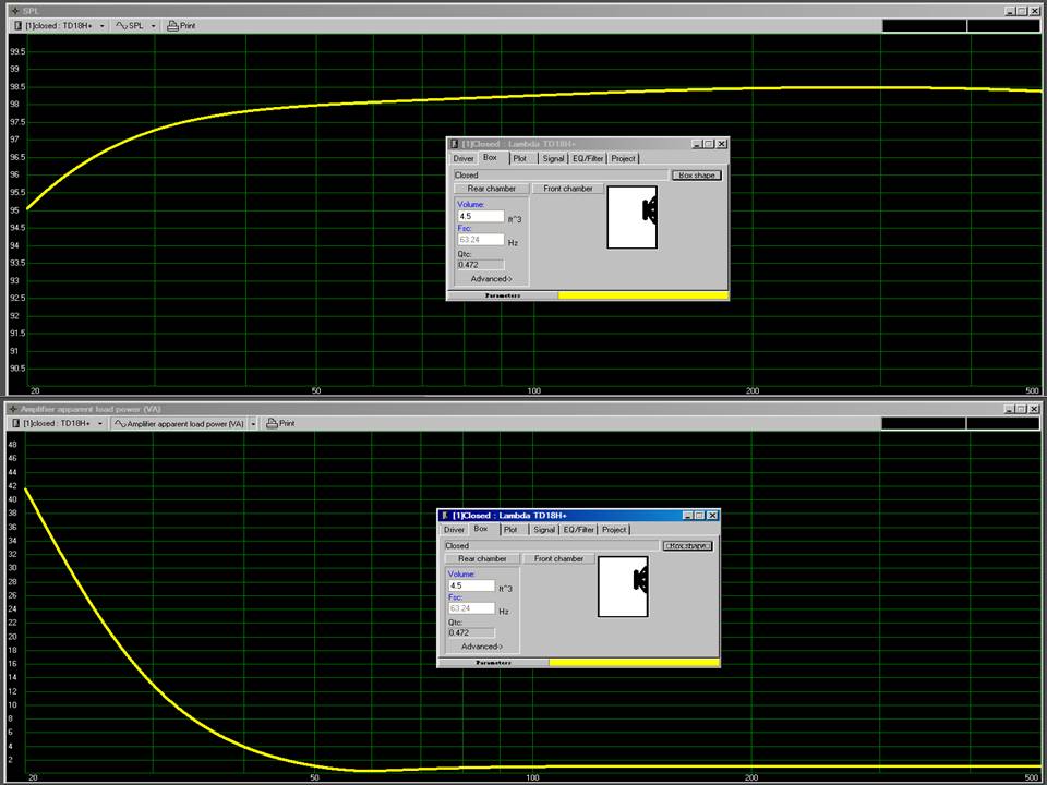

"TWO SPEAKERS" A coaxial compression driver, and a 18" woofer in a large sealed box with equalization.
(1) SEOS24 wave guide with BMS 4954ND coaxial compression driver
(2) 18" woofer like Lambda TD18H+ Mms=164g, Le=0.4mH, Xmax= 14mm 1000W
Dual AE TD18H+ Mains -TD15M center by Lukeamdman
Specifications:
■Loudspeaker Type:
2 Way active with DSP @450Hz
Passive Xover for BMS coax compression driver
■Frequency Response Range: 20Hz-20KHz
■Bass/mid-bass: TD18H+ (8ohm) woofer in 4.5cu.ft sealed ~99db/w before room gain
■High frequency: BMS 4594ND coaxial compression driver Denovo SEOS-24 wave guide
***The JBL M2 coaxial horn could also be mated with a 18" sealed+equalized woofer.

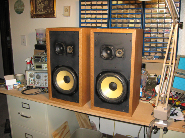

I built these 10 X 19 X 9 inch bookshelf speakers that I think sound VERY good. The tweeter is actually not hooked up. All 3 drivers come out to banana jacks on the back. There's an 8 inch kevlar woofer, and a 3 inch Vifa TC9FD mid, acting as mid and tweeter. It's bi-amped with X = 500HZ 4 pole LR, and I've got active EQ that pumps up the low bass so it's acoustically pretty flat down to 30HZ. It goes as loud as I ever want in my bedroom. I built a 4 channel LM3886 power amp for it that delivers 50watts rms per driver. 2 way, 30HZ - 16kHZ, no crossover in the frequencies where the ear is most sensitive, sounds great.
