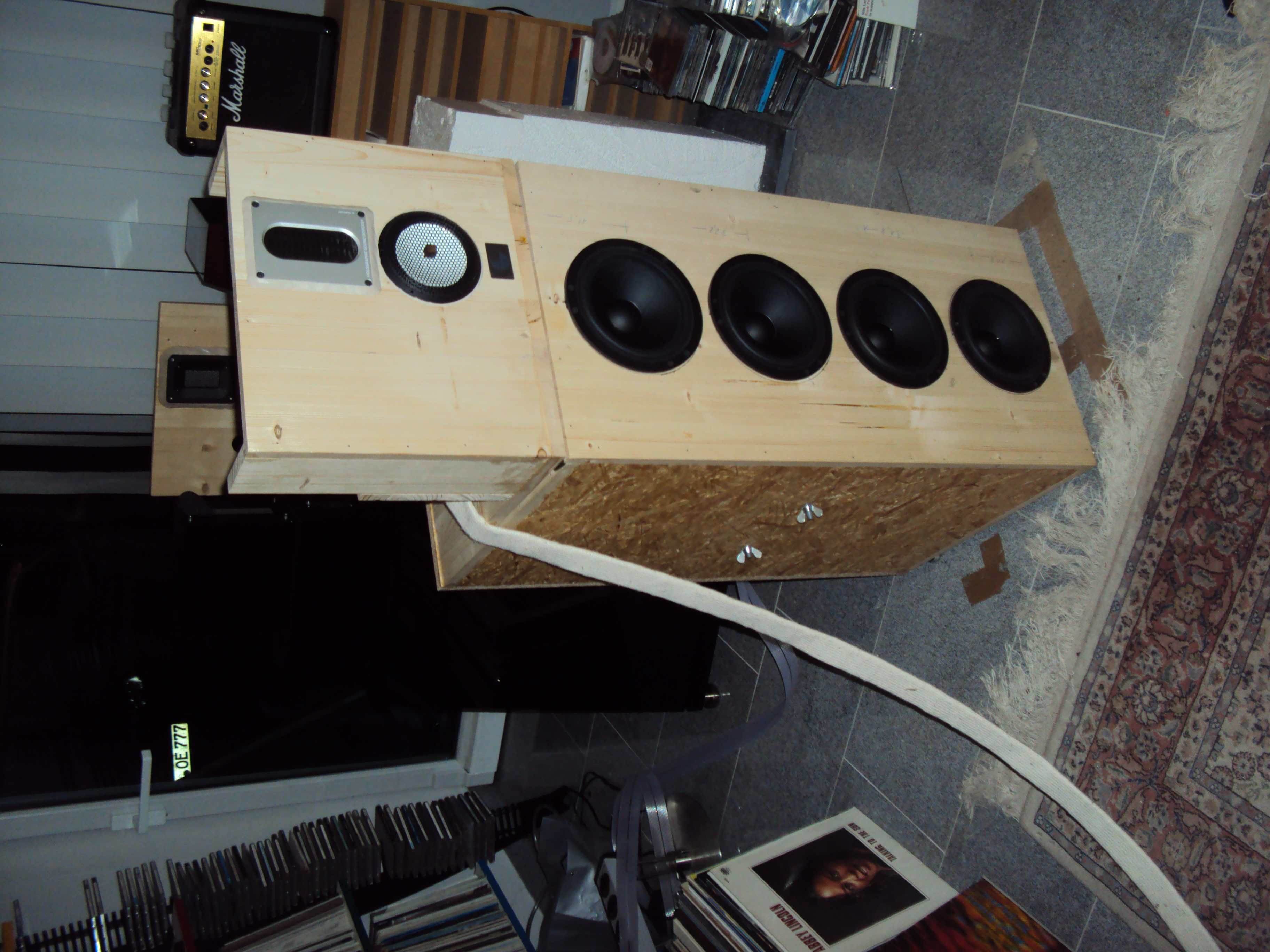

Here are the speakers.
There is much to say about the speakers. It is late here so maybe later.

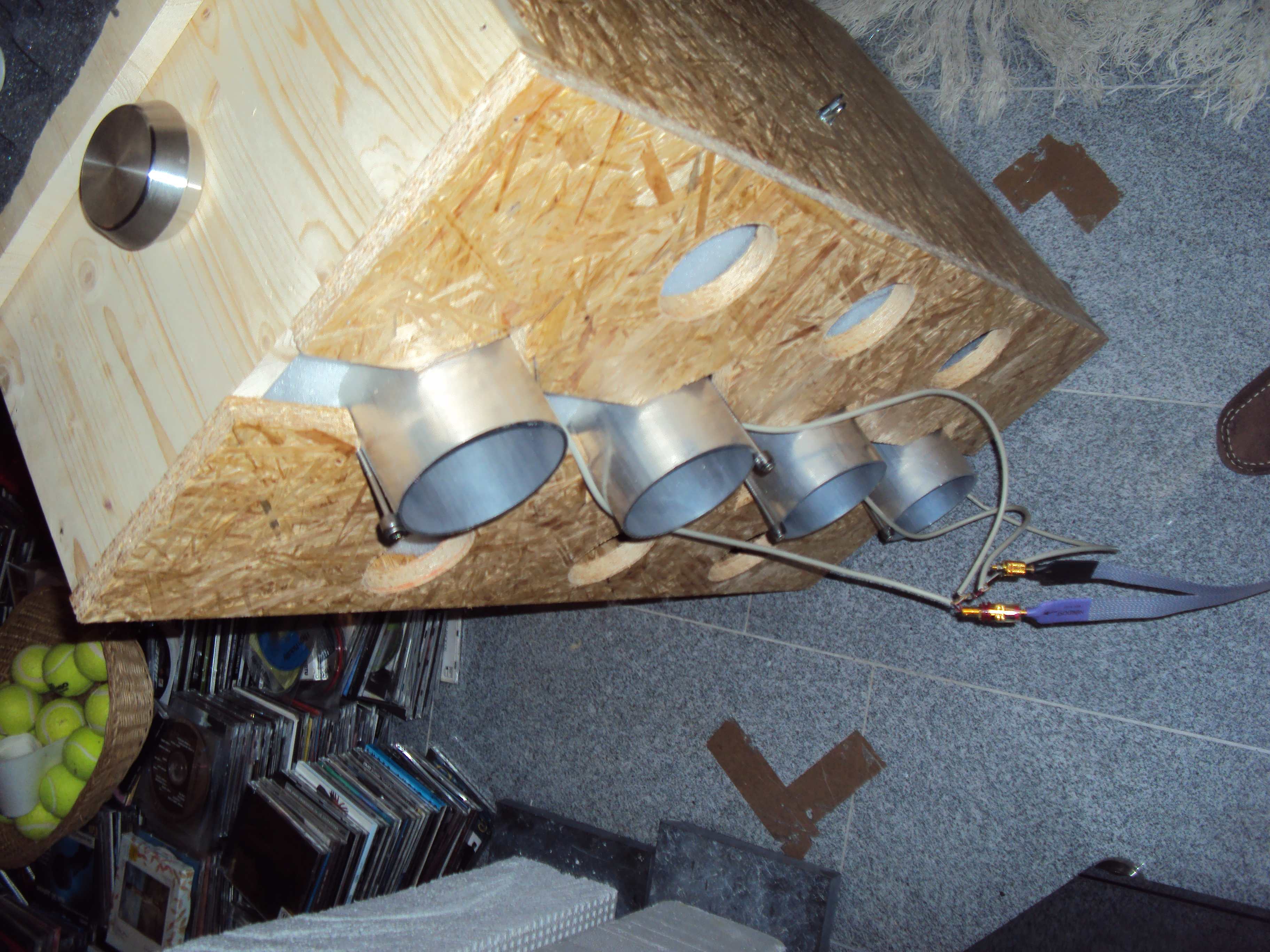

One thing you see is that the woofer are clamped, glued and skrewed into metal tubes that are fixed on the back so that they can not move forward or backward.
The woofer run active with my Back EMF Recyling circuit.
I extract the Back EMF and feed it back to the amplifier.
The midrange is the new 90mm Cell driver from Accuton.
The tweeter is a Heil AMT specially made for me by Mundorf.
The cable is silver ribbons, natural gum dielectric in cotton sleeve.
