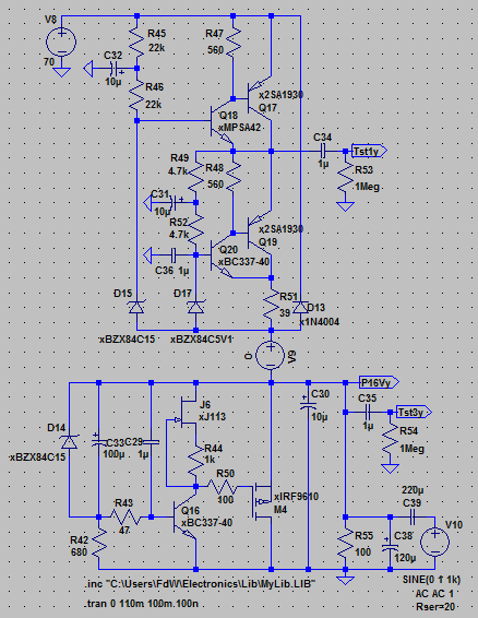

We have discussed how to measure PSUs and why they have an effect on sound.
Maybe this can shed some light on it :

Has this test been done with real builds or are these simulations ?
Where is FdW shunt ?

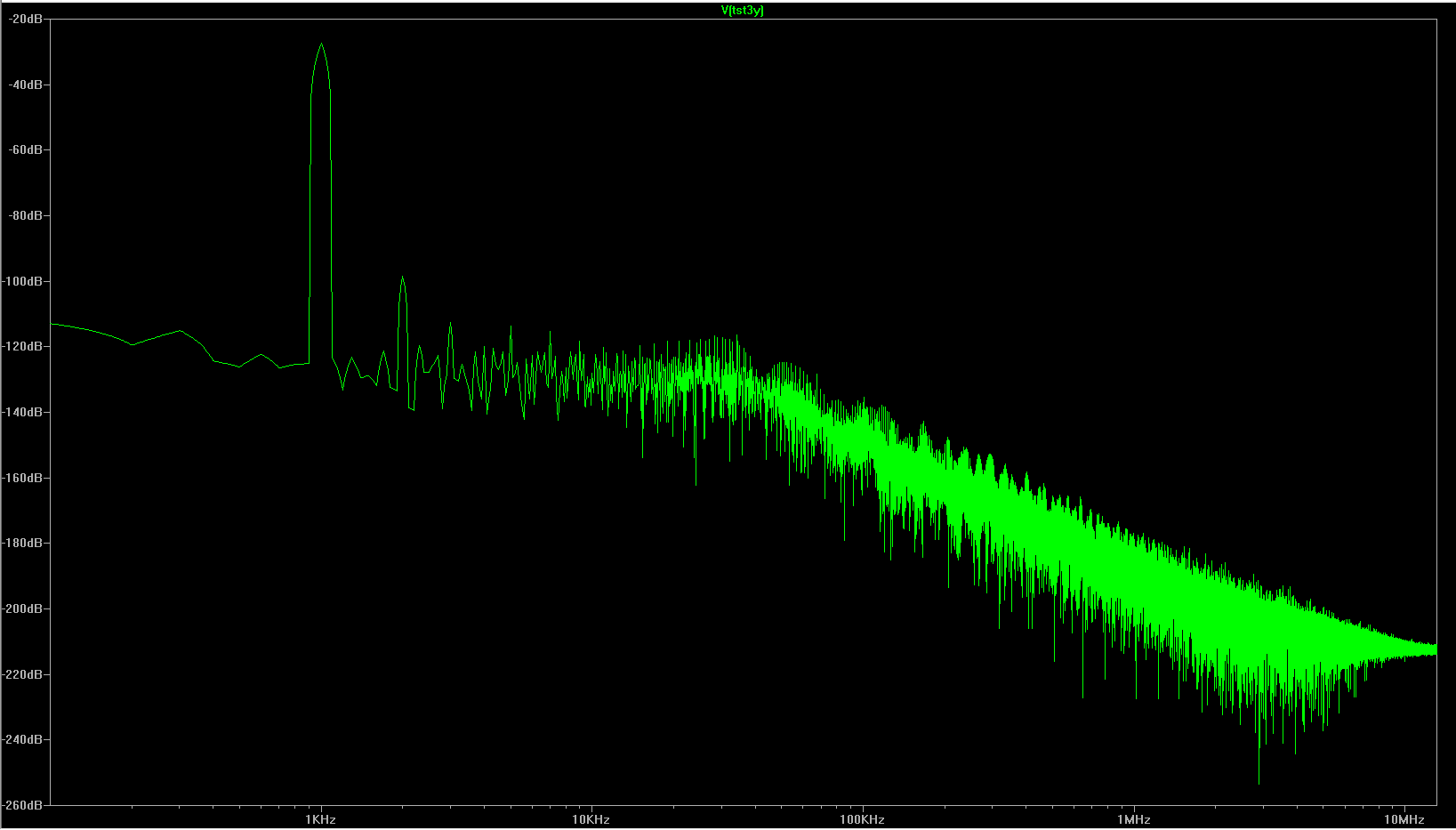

Can't do the real measurement, I do not own the AP but if the simulation helps then here are the results. Also I must note: the specified test (here DIY Test Equipment for Audio and Ham Radio Enthusiasts) is not a PSRR-test, it is (I would say), a current injection resistance(CIR) test . Also, series regulator PSU's may (or may not) have a high 'CIR', but I am sure that a good shunt regulator (having a good CCS) will (probably) have a better PSRR than (probably) any series PSU (or I will eat my hat ).

There was a listening test on PSUs in Linear Audio.
They used a rather simple Borbely line stage that did not have much PSU rejection.
The outcome was rather suprising.
The Jung-Didden series regulator did best and the Salas shunt did quite poor.
Usually a shunt should work better but that was not the case here.
So a search was undertaken why that was.
A distortion analysis by FFT of the output voltage correlated with the sound impressions.
The PSUs that did not have high order distortion artifacts did best.
