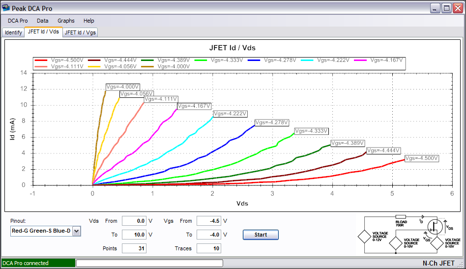

However if limit voltage is 12V and few mA, that would be a limiting factor for me at least in this design.
Maybe I am missing out something.
I think 5mA is not the limit but 12V is.
I have published some measurements on the MPP thread.
what is the max current you were able to put out from the 75?

few mA
5mA limit for Vgs.
12V/12mA limit for tracing a JFET.
=> http://www.diyaudio.com/forums/atta...8-sit-variations-snap-2013-04-03-04.03.31.png
