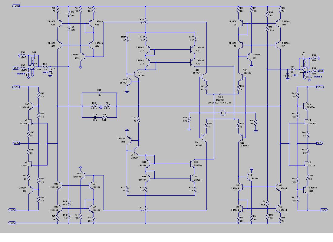

Here is the "final" schematic for the circuit we have been working so far.
I have updated the output buffer with a different version.
Based on some reading this should have sligltly lower distortion and soundwise should have more slam and authority so why not include it in here?
I haven't tried the comparison myself but I trust in this instance other's people experiments
So here is the final schematic as up to date.
EDIT: not shown on the schematic, but I will likely during development expand to a separate shunt regulator higher voltage for the output stage. OPAMPS are also powered up by a separate +/-12V shunt supply.

That buffer is very good and can be improved easy.
I will show you how.
Sounds good. Let me know and I will include it on the schematic!
