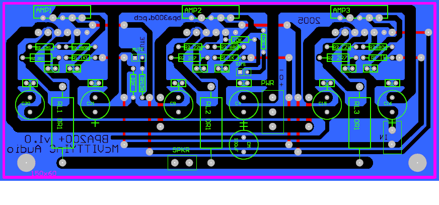

"You are right about the ground track if you connect your speaker (-) straigt to your PSU. However having low-resistance ground tracks/path is always good for your design.
On the Bpa 200 design the + of the speaker is connected to the parallelled pair (noninverted) of 3886 and the - is connected to the inverted parallelled pair. Where does ground or PSU come into the speaker?
This is a serious question, i cant see where either ground or PSU comes into the schematic

Im not sure i understand you correctly here:

You are right about the "return-ground" and BPA-200. I think my mind was in "parallal-mode" only when I replyed.
However you should still make an effort to make as low impedance as possible gorund-connection/plan on our PCB, since your circuit is ref. to ground.
