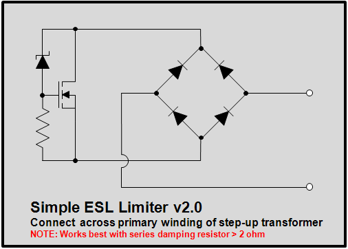

It sounds essentially identical to the simple limiter circuit I have been experimenting with.
See attachment for schematic of the latest version of my limiter.
Basically, once the amplitude of the audio signal reaching the transformer primary exceeds the zener voltage, it starts to turn on the MOSFET which draws more current thru the series damping resistor to drop the voltage down to the desired level. The larger the amplitude exceedance, the harder the MOSFET is turned on. MOSFETs can be paralleled for use with lower value damping resistors or extremely powerful amplifiers. I have been using IRF-540s.
Like you said, the limiter is nice to have in case owners use larger amplifiers than recommended.
It avoids any problems with transformer core saturation or air ionization damaging the diaphragm coating. I just found it interesting that ML did not advertise that their ESLs incorporated protection against being over driven. I think it would be a good selling point. But, I guess it could also be seen by some as a crutch, or a non-essential circuit that could only have bad effects on the sound quality whether or not it was ever tripped.
Two possible reasons why ML chose to use discrete diodes instead of a bridge rectifier:
1) Cost. In large production quantities it may be cheaper to use the discrete diodes.
2) Speed. You didn’t mention the exact part numbers for the diodes, but it is possible that the discrete diodes can turn on and off faster and cleaner than a bridge rectifier.

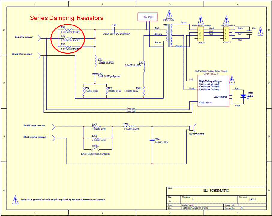

What is the ziner V an amps, you use in your set up.You say that the res 2ohm 1watt or what??
I am using a 62V zener diode in my MOSFET limiter circuit.
Series damping resistance is 2.25 ohm, 40Watt.
ML uses a series damping resistance of 1ohm 60Watt.
See attachment for identification of the 3 parallel resistors that make up this resistance.
Their crossover circuit also has a capacitor, CX2, in series with the audio signal going to the transformer primary. So, there would be voltage drop across CX2 as well as the series damping resistance when the limiter starts to kick in. My ESL only has a series resistance, no capacitance.

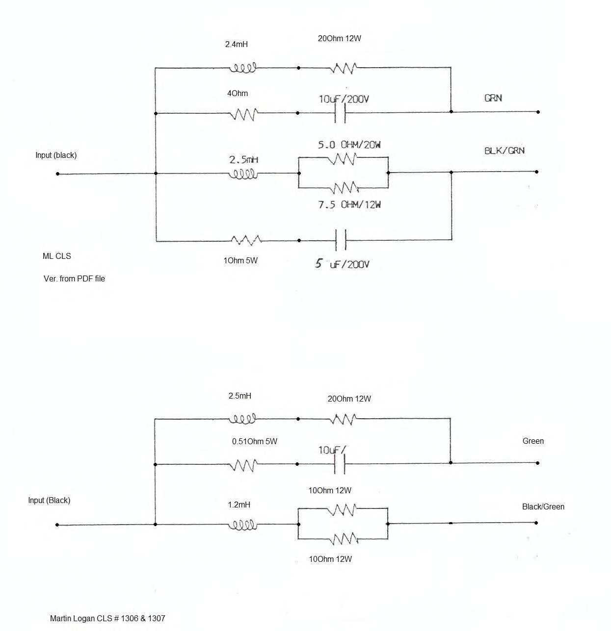

Dou have the CLS Xover an there Tone setup
if you can help, what is the Re go from the sorse an gate of the Mofet your using?? On the logan limimer it look 1watt
An well i need to drop the zener too Lower V as its in being feed in front of the cap?
