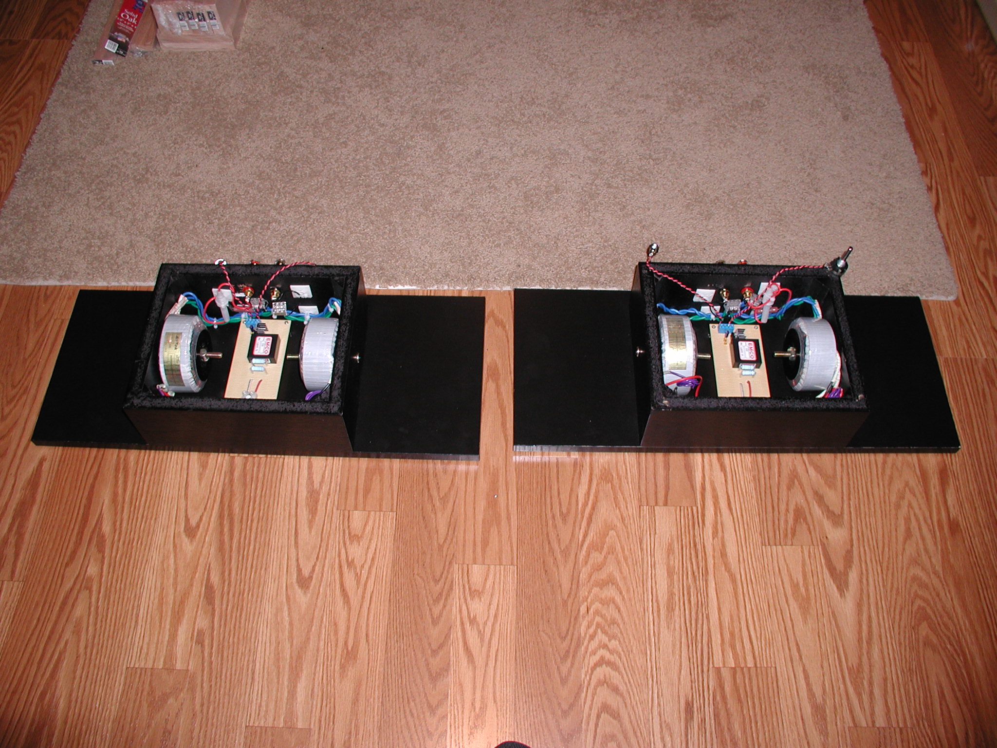

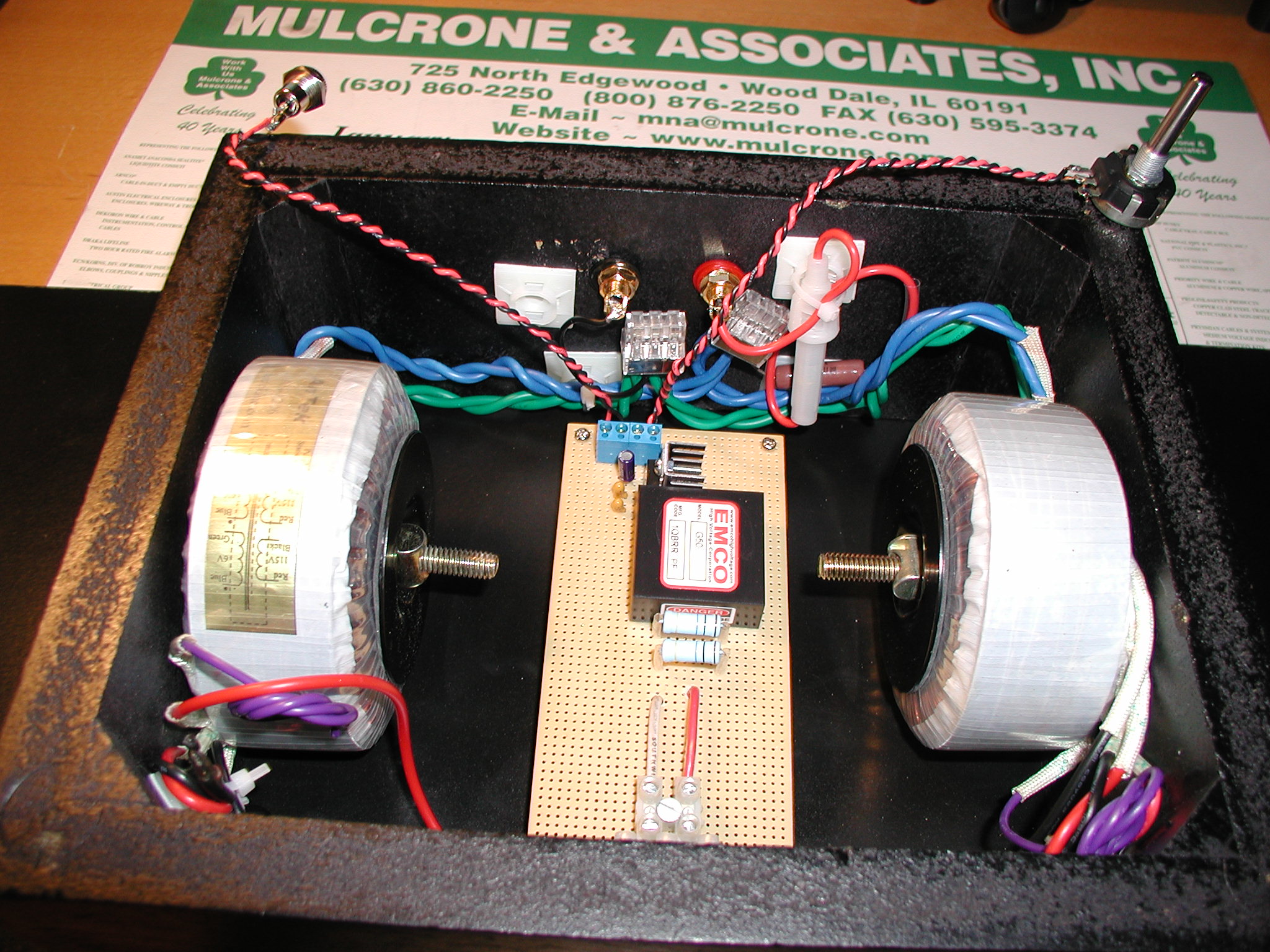

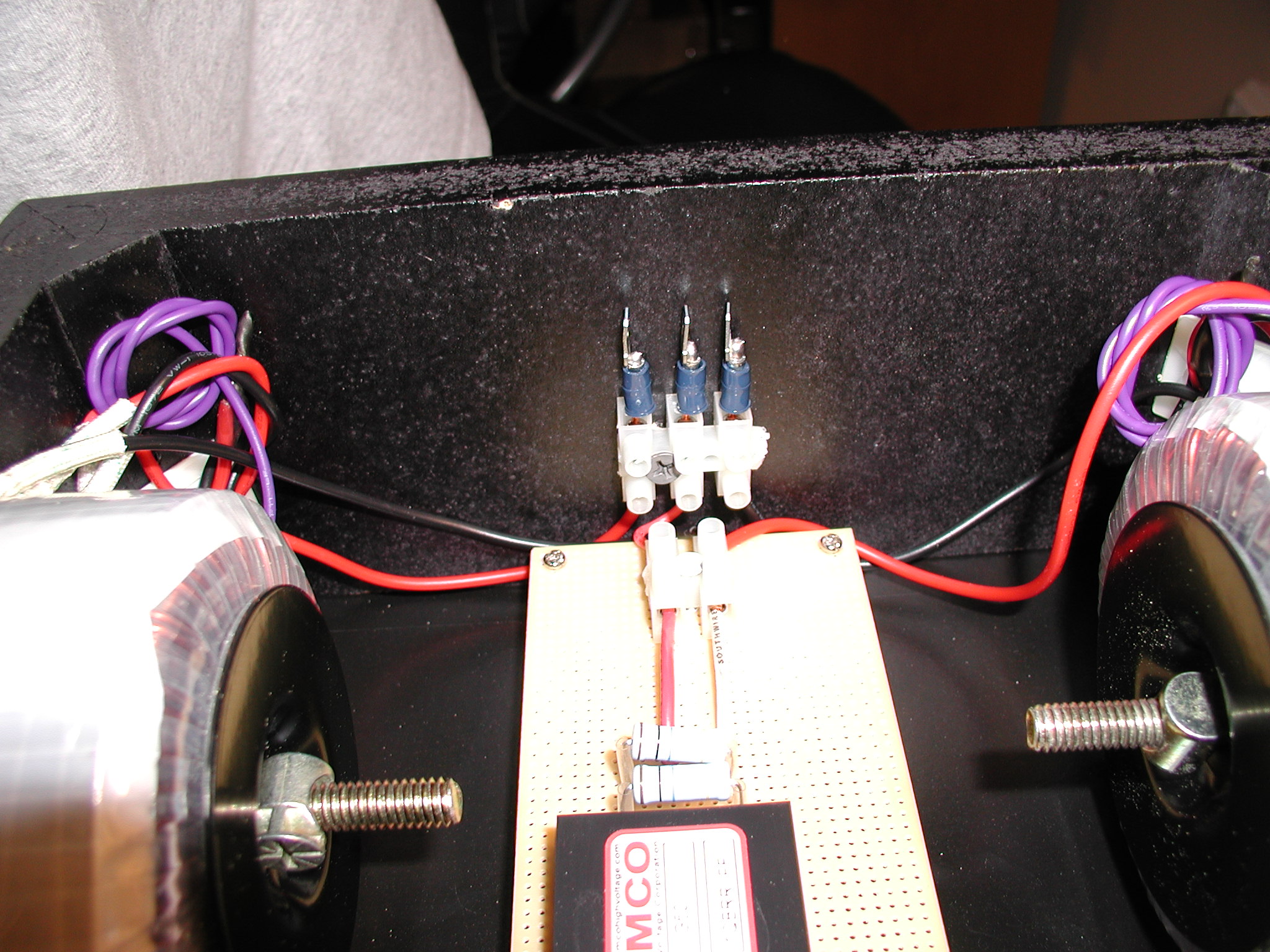

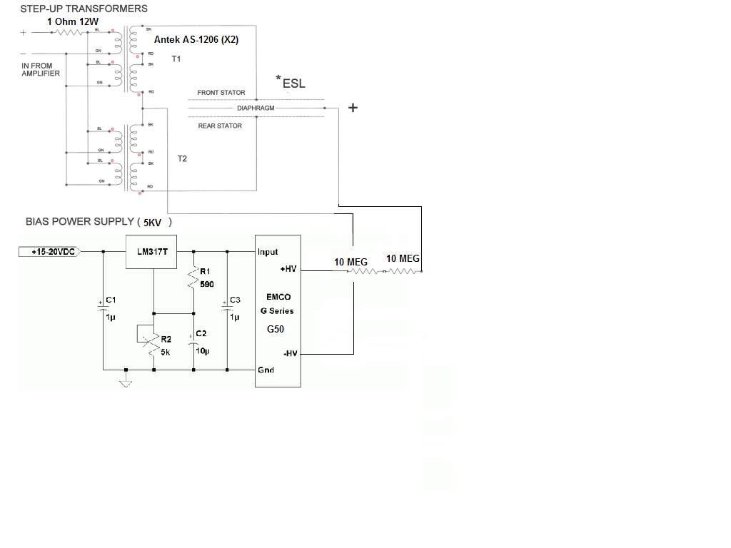

OK. I have finished the two power supplies all set up and tested. But I have one question that just doesn't seem right. I am using the Enco D50, and checked everything - input voltage is 1.1VDC to 11.5VDC. Perfect. The 1.1VDC input yields around 450VDC out of the D50. My DMM only goes to 1000V, so I turned the pot and easily got to 1000v and stopped - still had plenty of knob left to go all the way to around 5000V. Perfect.
Thing is, when I put the probe on the other side of the two 10Meg ohm resistors (in series), I am dropping quite a bit of voltage - at 1.1V into the DC50, I get 450V out of the D50, and about 150V after the two 10Meg resistors. Now I have nothing after these two 10meg ohm resistor to draw current to drop voltage.....this has me stumped...am I missing something elemental here? How can I be dropping that voltage not connected to anything? I am measuring between this before and after two 10Meg resistors reference to the bias supply Ground.

If i am understanding your setup correctly, you are using 2 of the Antek transformers to try and drive the CLS full range. Remember, the voltage input of the Antek's is very limited below 200Hz. Perhaps the distortion(and fuse blowing) is because the cores are saturating as the volume is turned up.
If you put your ear next to the Anteks while the volume is turned up, can you hear/feel them buzzing in sync with the distortion?
If your preamp has a bass control, you might try turning it all the way down to see if this alleviates some of the distortion you are hearing. Or, better yet, use an active crossover to feed it only frequencies about 300Hz. Then see if you can play it louder without distortion.

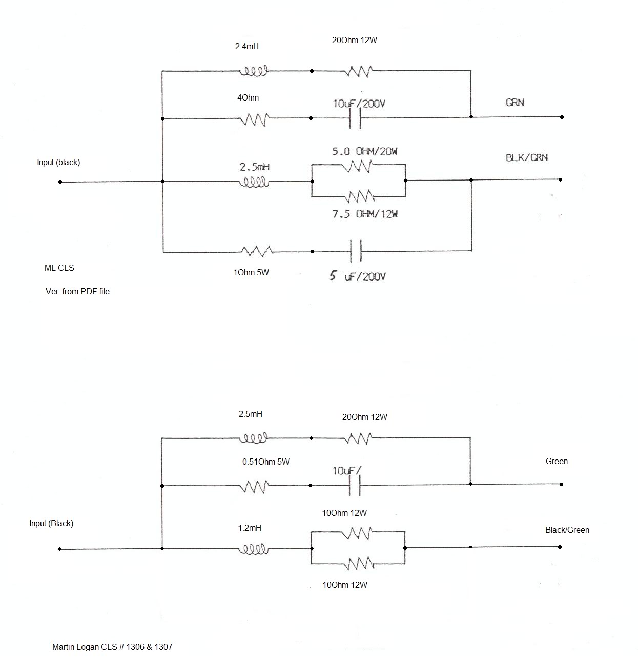

The original CLS power supply and transformer enclosure had a series of 10uf caps, 10R resistors and a pair of inductor coils, which I do not have...maybe a 3rd order high pass? The original specs were down to 45hz

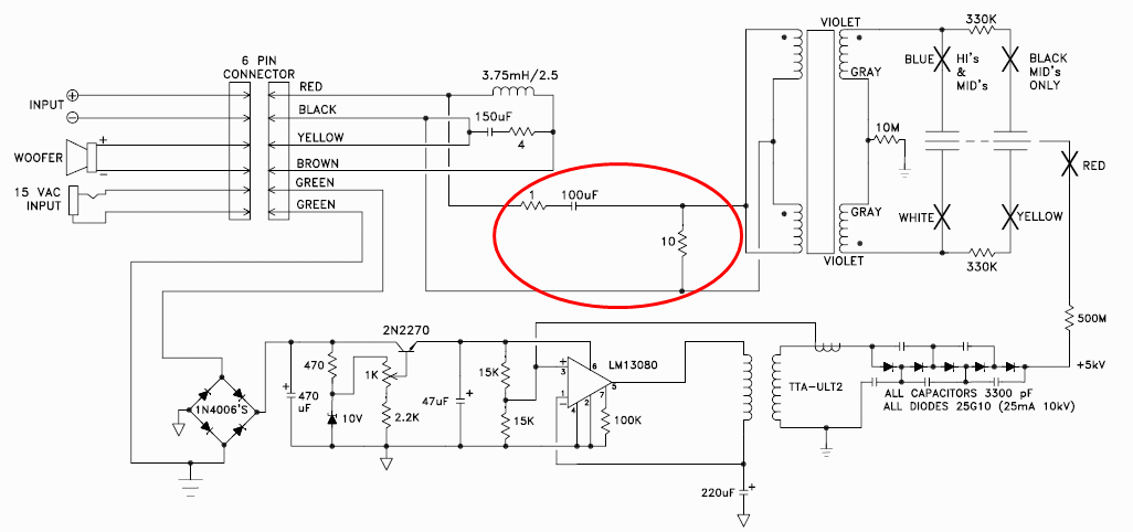

Adding a cap in series to form a hi-pass doesn't work particularly well on ESLs since the impedance of the transformers varies widely with frequency. I would recommend using an arrangement similar to what Acoustat used with the Spectra 11(see attachment) where they have a 10 ohm 50Watt resistor shunted across the transformer primary to give the crossover capacitor a nice solid load to work against. In your case, a 15ohm shunt resistor and 47uF series capacitor should put you 3dB down near 250Hz.

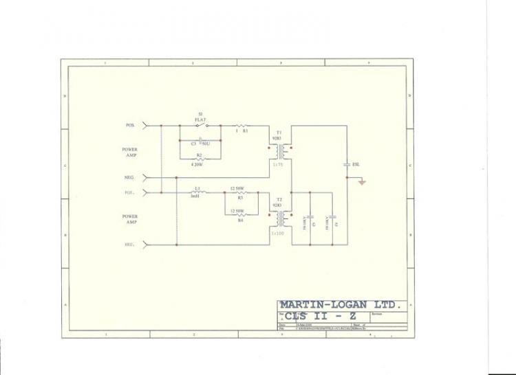

Yes, thanks tyu..I did not have that schematic - that was the last piece of the puzzle for the stock ML CLS XO / bias circuit / stepup trannie box.
I have my Magnepan XO-1 crossover that sits between the amp and preamp. I have the cap in there for 380hz hi pass cutoff (for my 9k input impedance of my Icepower 1000ASP amp). If the plan is to use the CLS on HF anyway (over 250hz), I shouldn't need the internal XO that tyu has drawn, but at least I now have it.
I will try the panels at 380hz cutoff later today to see if it is any better, and also will install the Neon Bulb too to check the panels. I will leave the neon lamp on the external box, so I can always detect issues with the panels.

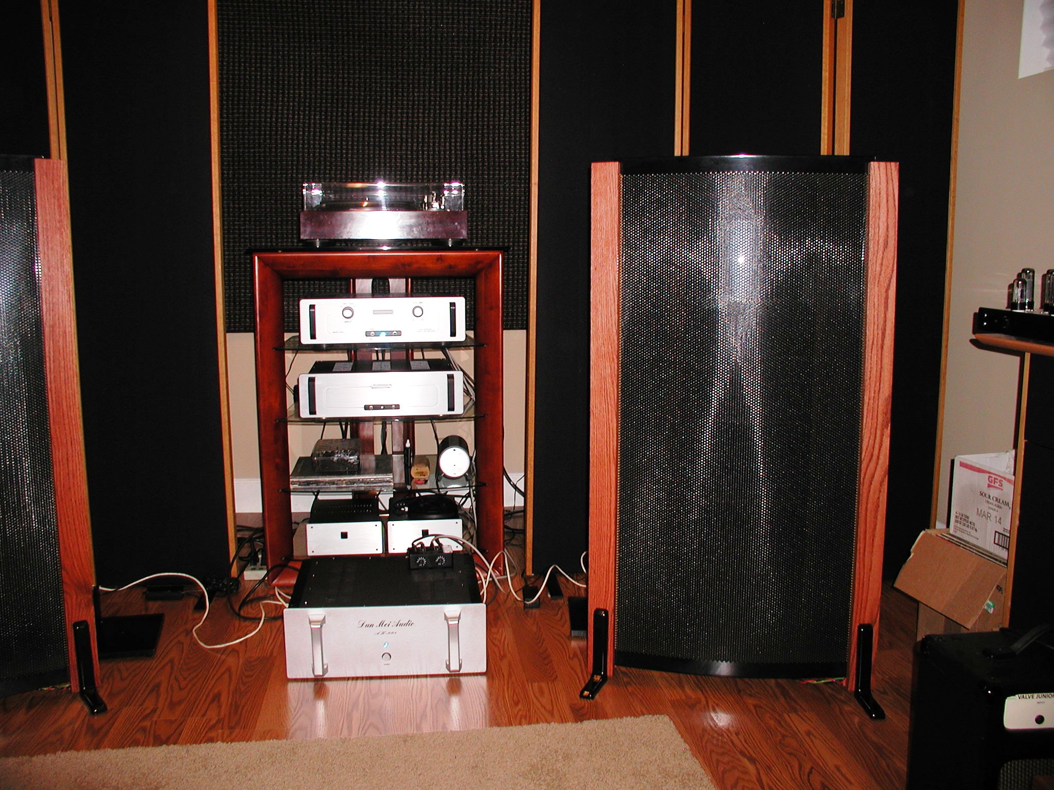

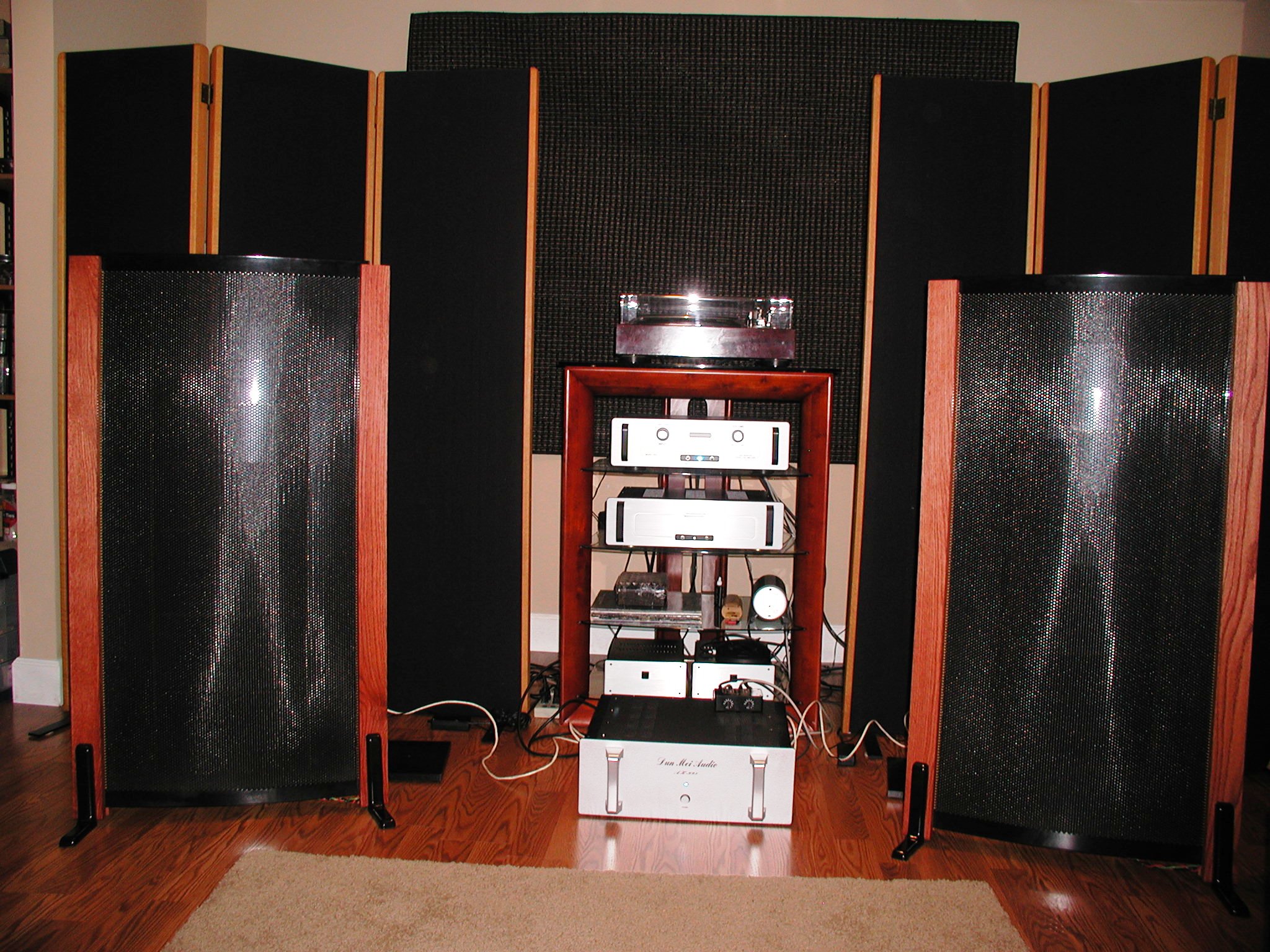

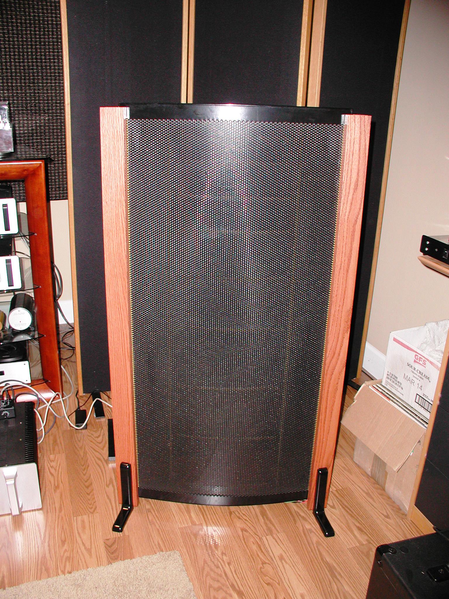

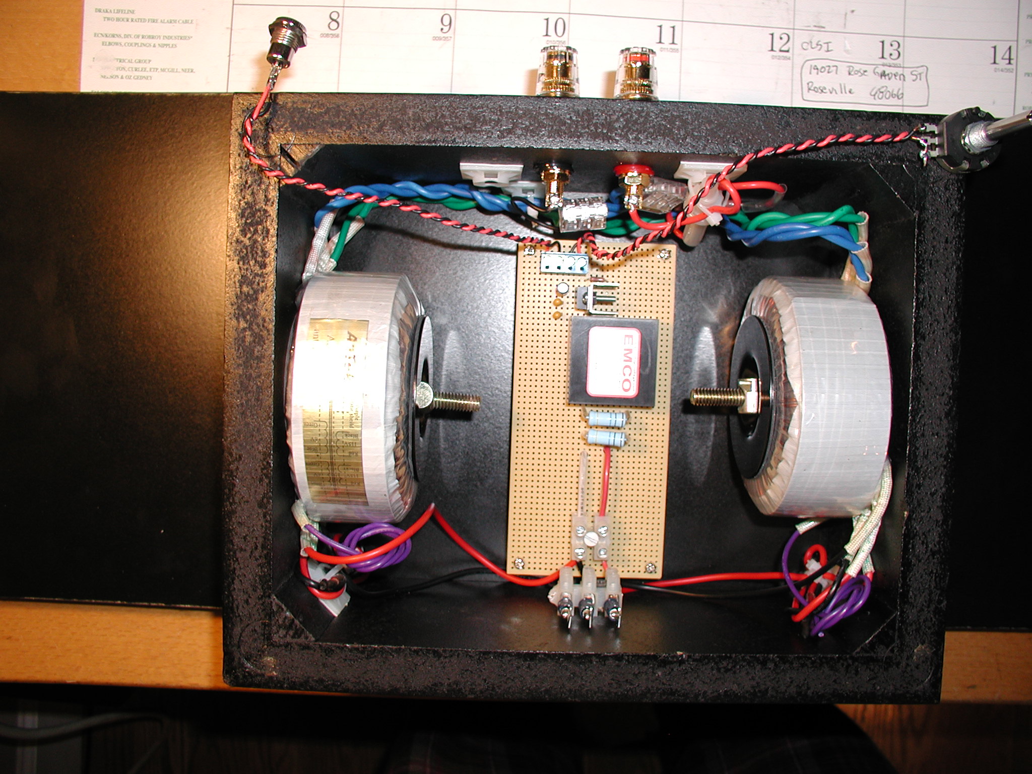

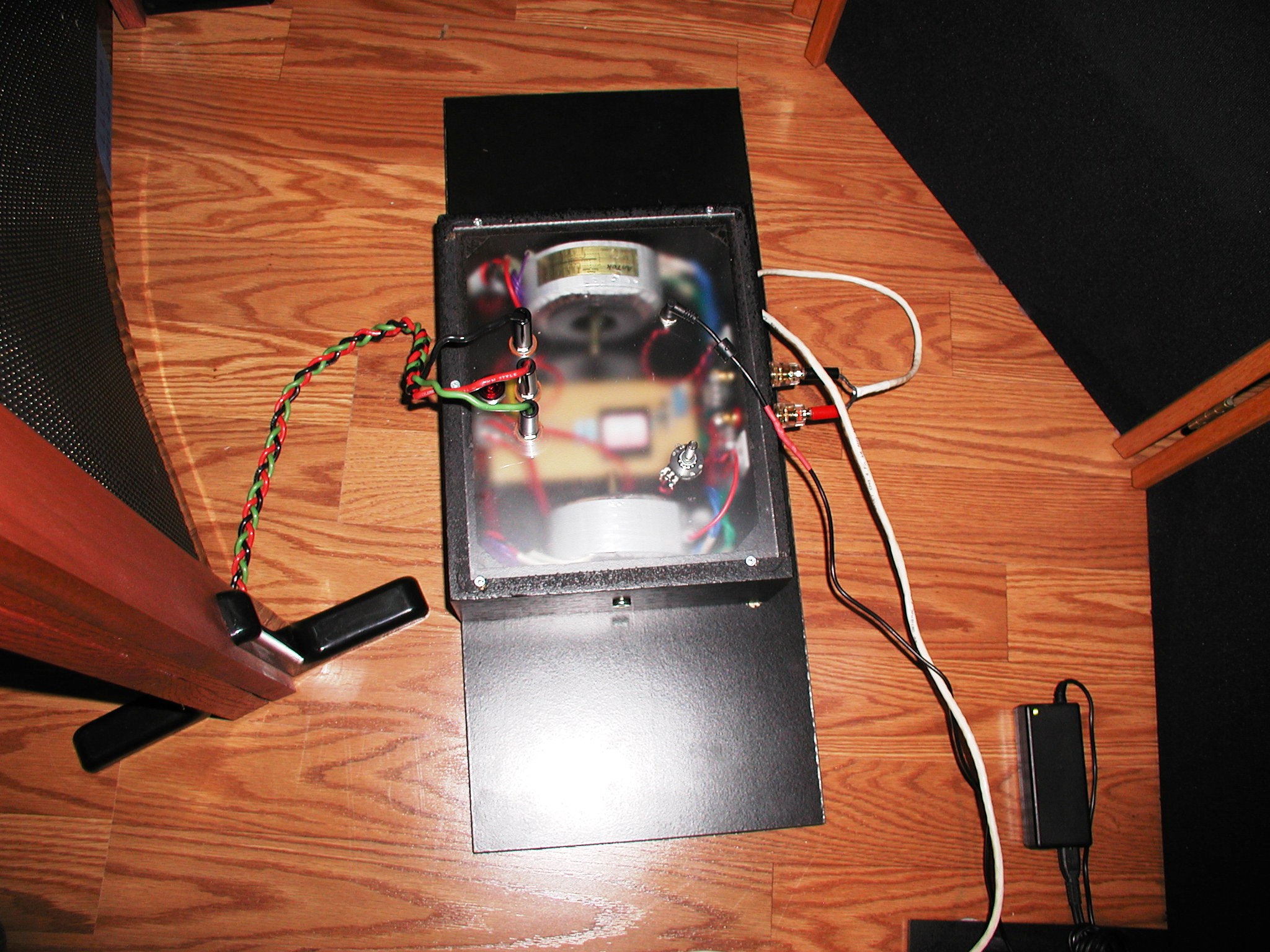

OK. Finished. I put the Neon Lamp in with .22uf 1000V cap (only one I have). Both lights blinks once every 25 sec or so at full voltage (5kv). I have the panels limited to 300hz and higher - no distortion, or any problems and plenty of SPL. Tomorrow, when I have the house to myself, I will try to see what higher volume sounds like - I am listening to David Gray - White Ladder - and it sounds incredible without any low end. Image is impressive. This may end up replacing my Tympanis...
I bought some 3" x 4' x 1" oak rails and sandwiched the panel ends together. The legs are shelf angles. I stained the oak panels with a Cherry stain we had left over...even the wife is impressed, which never happens.
Currently have them driven by a High Power JLH (JLH for ESL - Class A and about 40wpc) I built a few months ago and it sounds excellent.
I will leave the diaphragms in the panels as is for now, as I am enjoying them immensely just as they are.
