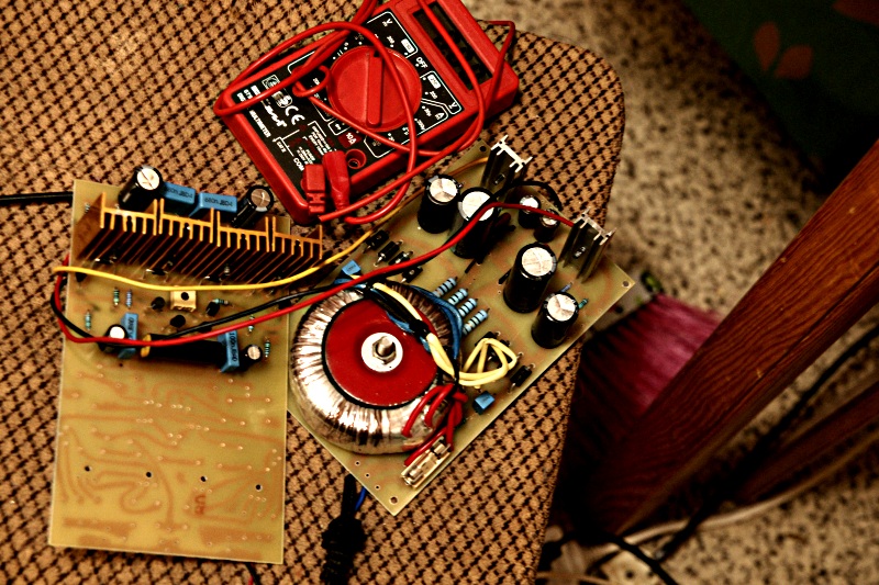

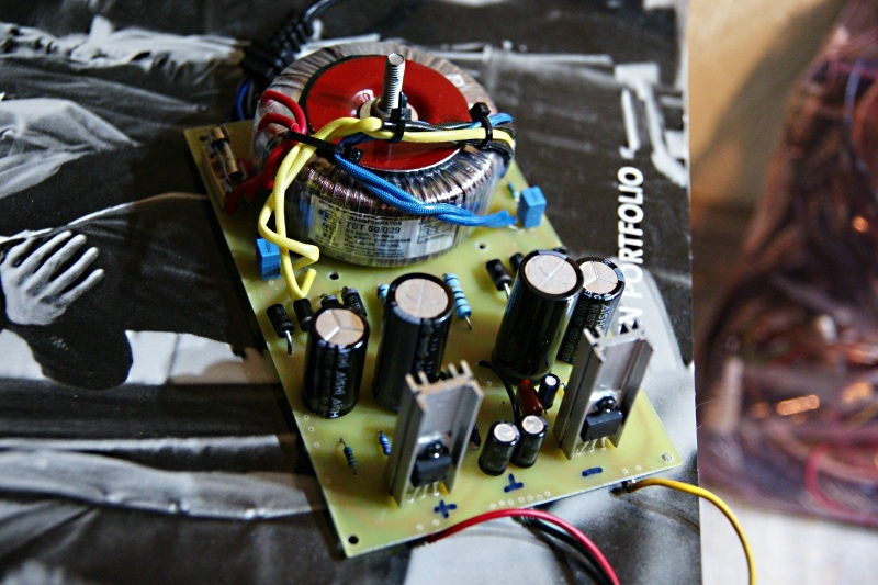

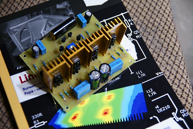

my Marsh headphone amplifier is under construction - i also integrated DC coupled B1 for volume control in one PCB with optional DC blocking capacitor.
one channel is already soldered , but when I create PCB I made a pretty big mistake - incorrect output transistor pinout(do not believe Google images -Check Data sheets). I use sk170/sj74 + BD outputs. I will re-done PCB again tonight from zero. At least PSU board working fine( 50VA 2x15Vac transformer + linear regulators).

Post some images when you are done. Looking forward to it.

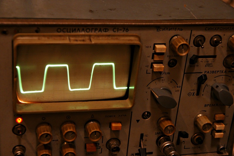

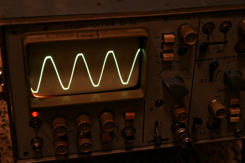

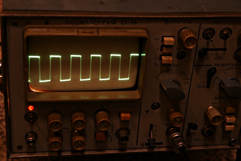

ok one channel soldered:
seems that everything works: hum 0.05mV with test wiring.
bias - 100ma per channel.
DC offset less then 1mV
20Khz;
90Khz;
clipping @ 9Vrms @13.8V
i will measure thd with sound-card tomorrow.

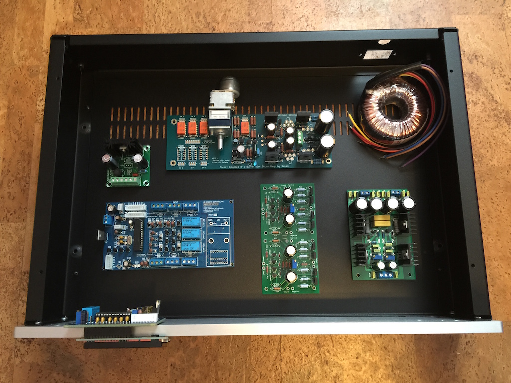

Excellent! So you are building a preamp with a great headphone amp!
Yes sir! :p
The last piece of the puzzle is creating a logic circuit controlled by the headphone jack's switch to switch the power to the CCS-fed shunt reg for the Marsh and also the preamp output to power the Marsh and mute the RCA out when headphones are plugged in.

actually, i think you WILL need heatsinks for output devices of the marsh headphone amp if you are biasing as in the LA article. MAYBE not if you use 2 diodes instead of three ... MAYBE ...
but why take chances with all that space?
mlloyd1
I have mine biased with 2 diodes vs 3 and they most likely wouldn't need sinks but I use them anyway. Better safe than sorry as mlloyd1 says. Another builder of the amp took a temp of the output devices and felt that they don't need sinking but again, no harm with them when biased with 2 diodes. And if you bias with all three diodes, without question then need a good sink.
