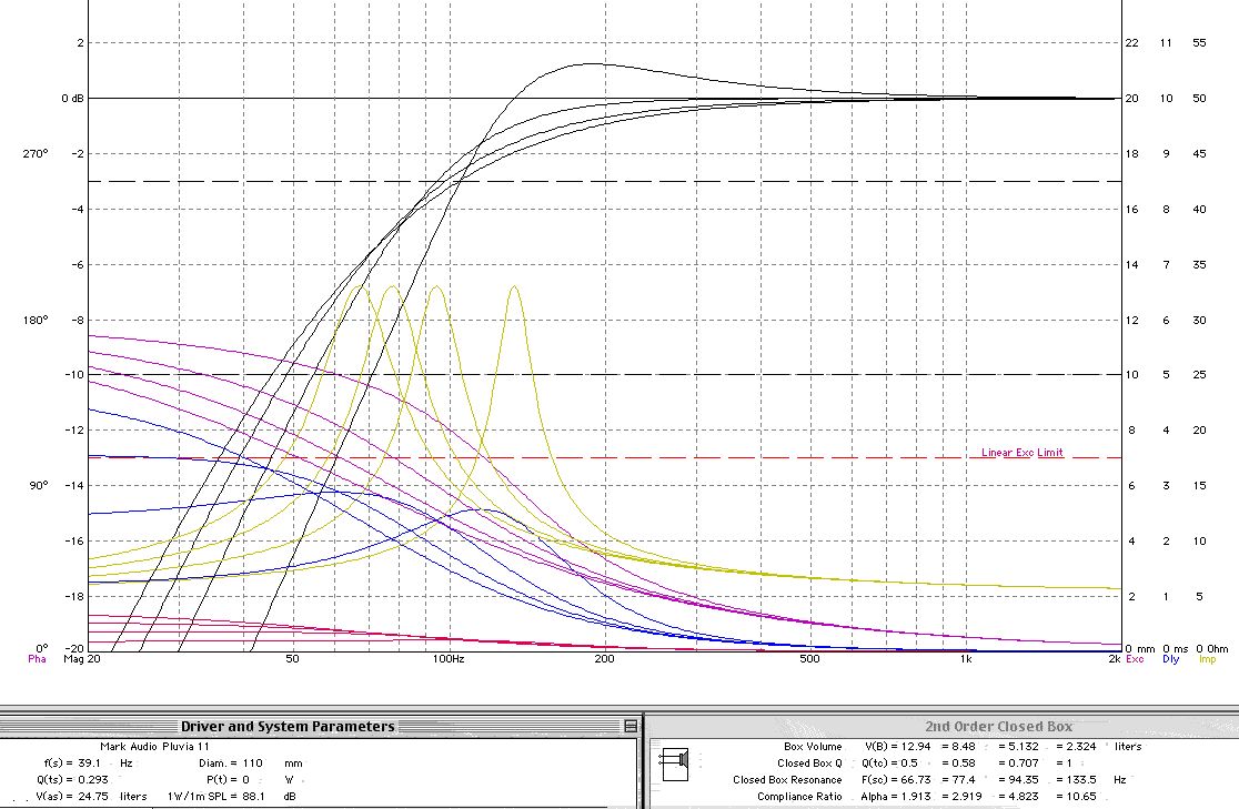

P11 sealed.
attachment.php
My optimal miniOnken is 9 litres and gets an estimated anechoic F10 just below 50.
We have had 2 pr of P11, 1 in the above CGR and 1 in FHXL.
dave
Dave, I'm not saying that with those specific cabinets you get worse bass response from the P11 compared to the other drivers. It very well might be (maybe a cabinet specifically optimized for the P11 could give you better bass? I don't see any reason why it wouldn't, but I digress).
What I'm saying is that higher area and excursion equals more bass, provided that the cabinet lets the drive to its job.
But right now I'm more concerned about the noise of the driver itself, way before it reaches 7.5 mm xmax.
Once that is fixed (hopefully), I can worry about designing a cabinet that allows the driver to move that much.

What I meant to say is that, provided that in each respective box (of closed type), two separate drivers are able to move up to their xmax at a certain frequency, the driver with higher area/xmax will produce more SPL at that frequency.
That is true but it says noting about how low that frequency can be. That is determined more by Fs and Qt.
dave
If you are EQing below the box resonant frequency you are putting a lot more strain on the driver than when the driver/box reaches that low itself… something like the EQed driver needs 4 x the excursion.
dave
Depends how low you're EQing it.
A driver in a sealed box needs a fixed amount of excursion to produce a given SPL at a given frequency. If the box is tiny, it'll be inefficient at LF and need more power to make the excursion happen.
Going an octave down at the same SPL requires 4x the excursion to maintain SPL.
It's more power being dumped into the driver, and likely more excursion being used (certainly compared to a tuned alignment), but if the end user is happy with that compromise (ie, reduced headroom available) then I don't see any problem. For 70 or 80dB peaks on a desk, you could probably EQ flat down to 40Hz and rarely see the cone move.
Just checked - a pair of drivers producing 40Hz in a sealed box would need 1.3mm one-way excursion to hit 80dB, and that's groundplane.
