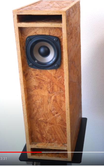

I made a wall-mounted Speaker with CHP90.
I used 9mm MDF to reduce the weight as much as possible, but it is strong enough and I don't feel any vibration of the box.

I like this idea. Does the thinness of the box affects the sound compared to other boxes you have used for CHP-90?

The difference between this box and other boxes is the internal volume.
A box with a small internal volume will not extend the lowest range, so I think it is better to choose based on how far you can tolerate it.
Even with this thin box, if you hang it on the wall, you won't have to worry about the lack of bass.

I like very much your idea for a wall mounted speaker (excellent for small apartments).
The ports (for a stereo) are firing inward or outward ? How do you think (guess ?) the sound will be affected if the port is down firing (to the floor) ? For a "normal" listening position - let say ear to the floor 90 cm - the distance between the port and the floor will affect the low end (bass) response ? The width and the depth of the "sound stage" ?

Hi Elias,
With the wall mount, I don't notice any difference in the direction of the ducts.
In free space (1 m from the floor, 80 cm from the back, and 90 cm from the sides when measured), there is a difference, but it is a matter of preference.
I preferred the duct position facing outward or upward.

Dave given the opportunity, is the speaker in the photo one of your designs ?
The seller claims:
I'm using the popular speaker unit TangBand W3-582SC.
Impedance: 8Ω
Playback frequency band: 70HZ ~ 18KHZ
Output sound pressure level: 86dB
Maximum input: 25W
Size: Overall width 116mm Overall height 382mm Depth 242mm
Weight: 3kg
Material: Pine plywood 9mm
Looks to me like fonken (in some way), or it is just a BR with 2 ports?
