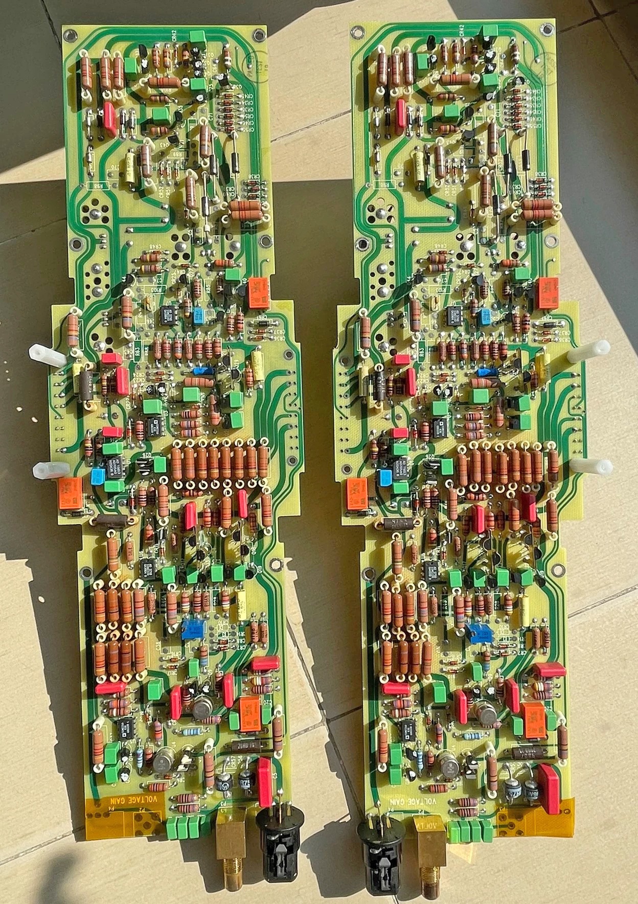

I need your help regarding upgrading my opamps in my mark levinson 33H
All the modifications that I have made to those amps gives them a new life and the sound became more analog.

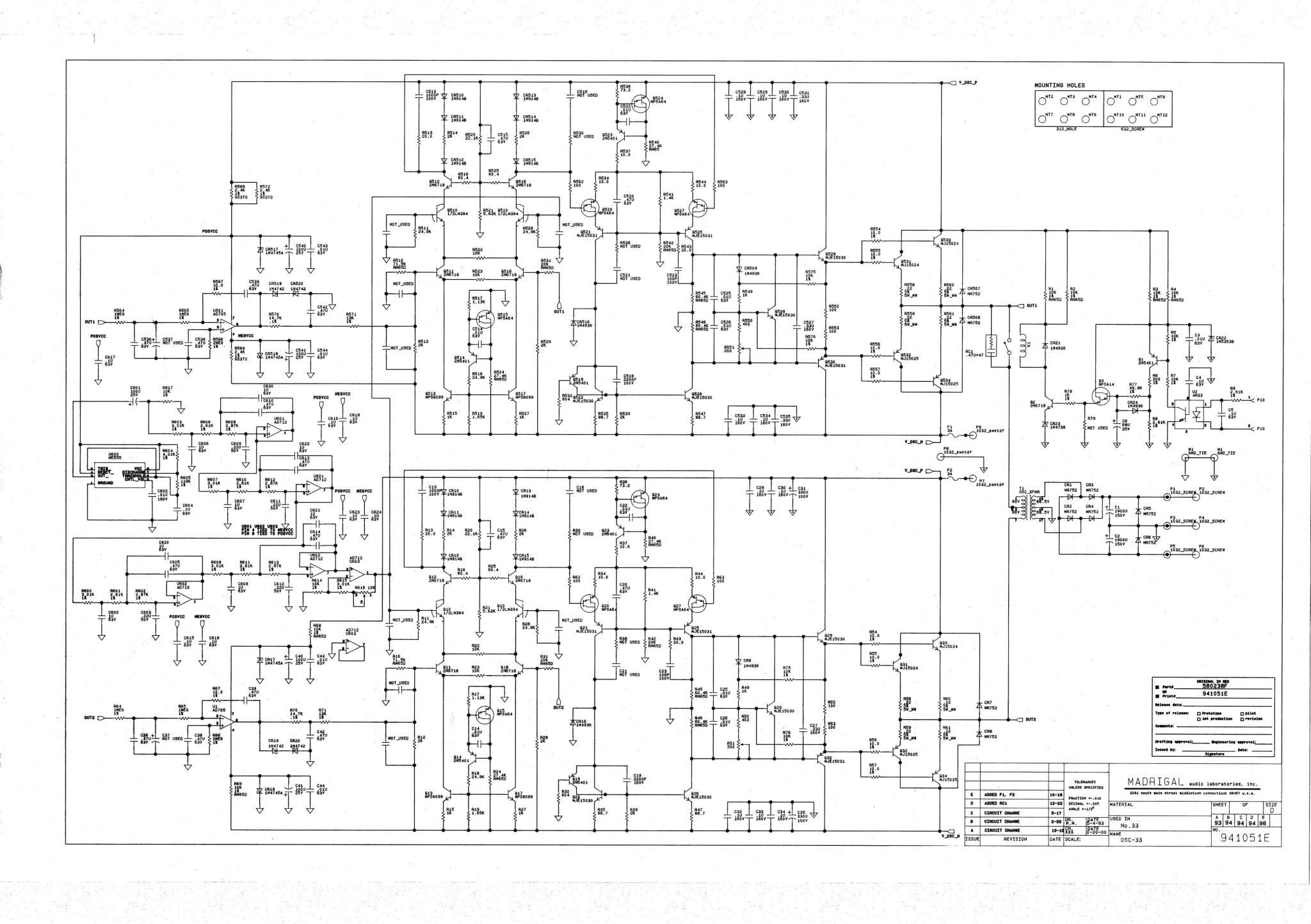

2. The second question related to the oscillator board of this amp
Since this amp has an AC regenerator for the input stage.

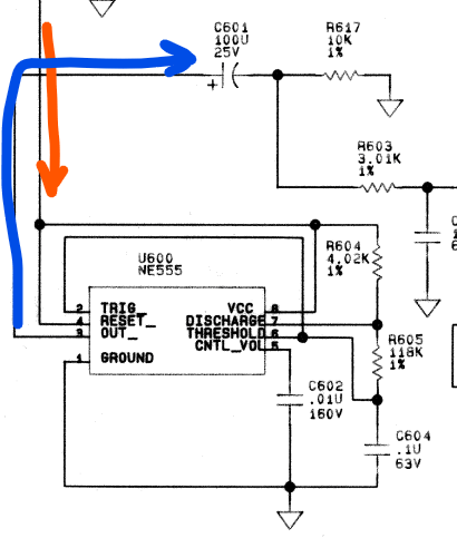

The oscillator uses NE555N and this connected to a series 3 opamps AD712JN
I was thinking to upgrading those opamps
To an opamps that have better specs of noise rejection to have better cleaner AC

Hmm, very complex circuit for an oscillator. Not sure the opamps have to be anything special at that frequency given they are parts of a low pass filter driving a transformer.
There is an argument for changing the Sallen-Key stages to multiple-feedback-path stages to reject more HF noise from the 555. By the same token there's a strong argument for replacing the 555 with a 7555 to put less switching noise on the 10V rail. The NE555 is a noisy beast.
Yes, seeing the schematic was what prompted me to post the regenerator module. If the opamps in the filter are in need of upgrading. wouldn't no opamps at all be an improvement? Also the classD regenerator module is capable of much higher power levels (with a suitable external set of MOSFETs) than your existing regenerator - it could potentially power the output stage of the amp not just the front-end.

The version or implementation of 555 and maximum load current has nothing in common with this circuit.
This connection of 555 forms a very typical or even classical oscillator circuit.
And it is loaded on C601 R617 only.
There is only one moment of time when C601 R617 circuit could be [a kind of] critical in a sense of 555's load current - when amplifier is turned on and C601 is completely discharged (and is a short circuit). But the current is limited by 10K resistance of R617 anyway, so for the maximal 0.1A of a "new but weak 7555" output current its output voltage should be 1KV. There is no 1KV in this beautiful Mark Levinson, so it's not an issue at all.

The important thing is the 555 has a spike of 200mA or more of shoot-through current from supply to ground every time it switches. Horrible behaviour that was avoided in all the CMOS versions like the 7555.

I'm intrigued. If I decipher correctly, the circuit produces a floating bipolar power supply, with DC outputs appearing on the right side of the schematic attached in post 3. Opto isolator U2 allows drive to be activated, again with isolation.
Have I missed something? Out of curiosity, what does the floating power supply drive?
