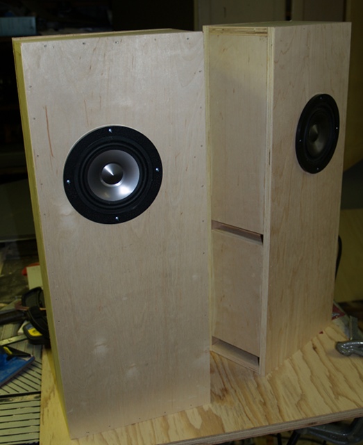

I finally have pictures of the dual-chamber base reflex enclosure I built for my CHR-70's.
This picture shows the speaker as built. I've not applied a finished, and I'm consider putting a quarter-inch overlay around the driver to get it flush. The driver is offset on the baffle because of the port running up the one side, and you can see the slot ports on the side. They are built mirrored.

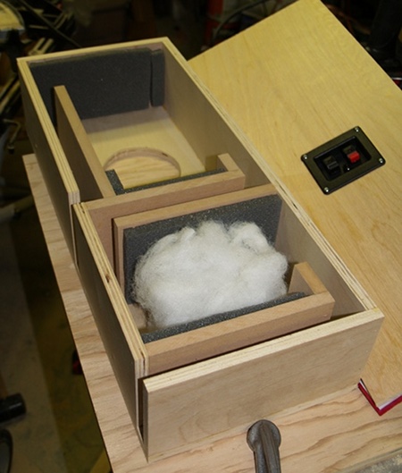

This picture is of the inside of my dual-chamber bass reflex enclosure, from the back.
In the design, I decided to use a slot port that was the same width as the enclosures depth and then use the port between the chambers as the separator for the chambers. This maximized the volume and minimized the number of walls.
The driver opening is visible through the far chamber. Half-inch material was used throughout. Because of some errors on my part, I had to use MDF for the port walls. All ports have the same effective length (slot port effective length is longer than actual length by half the height due to end being next to wall.) The height of the ports is 3/4". I used a couple of scraps of wood to set the spacing. The center port does wrap on both ends, again minimizing the walls. The driver chamber is twice the volume of the other. Besides the obvious stuffing, I glued some foam behind the driver, and I'm thinking of adding a little acousta-stuff in the driver chamber.
Overall, the design sounds very good. It can be pushed quite loud without distortion and it has good bass extension. Tuning design freq was ~48Hz and I believe the F3 somewhere below that.
I will publish a box drawing when I can get to it. Feel free to ask questions.

There had been a couple of enclosures built by some PE Tech-Talk regulars (Wolf's 3CR-Ti and W3-517S1-DCR, and Roman's Bandit). In Roman's write-up, he references the DIY-Subwoofer article about creating a 2:1 volume ratio and how the ports are determined.
The total volume and port size was determined by Unibox. The volume is determined in the vented alignment section with the number of ports set as 2. Looking at the response model, I chose 8.1L as my volume with no fill and tuning of 50Hz. This would allow for a mild ripple and I could tune that down with stuffing. The resulting port length is used for all 3 ports. The area of the port was chosen to be adequate for the driver at ~xmax. I also let the box dimensions drive this somewhat since I want to use the crossover port as the chamber separation too. The port is 4"x3/4" (3 sq in), and the internal depth is 4". In designing the box, I created a spreadsheet to develop the dimensions as I was iterating on several factors from Unibox and my space/location limitations. One issue with round ports was finding a way to put the ends into "space" in the chambers. This configuration does away with that problem entirely.

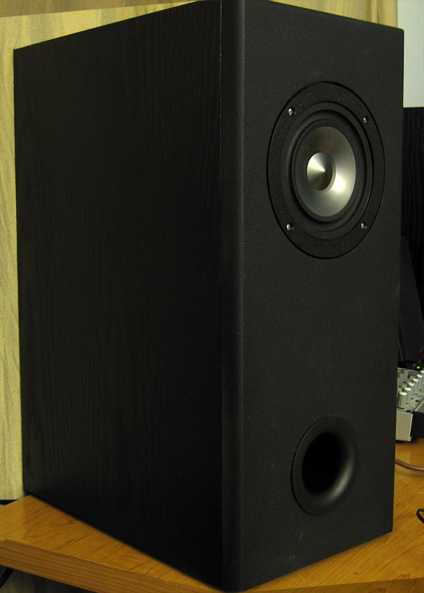

I figure I'll post this here, too, seems to apply
about 12.5 liters, tuned to 45 hz.
I think they turned out pretty darn well :D They sound great!
"black ash" type vinyl laminate from PartsExpress for the box, and the baffle is a couple coats of wood grain sealer, a few coats primer, a couple coats of this speckly texture stuff, and then a couple coats of flat black over top
No BSC yet, but on a desk backed up against the wall, they don't really need it. Something for future experimentation
