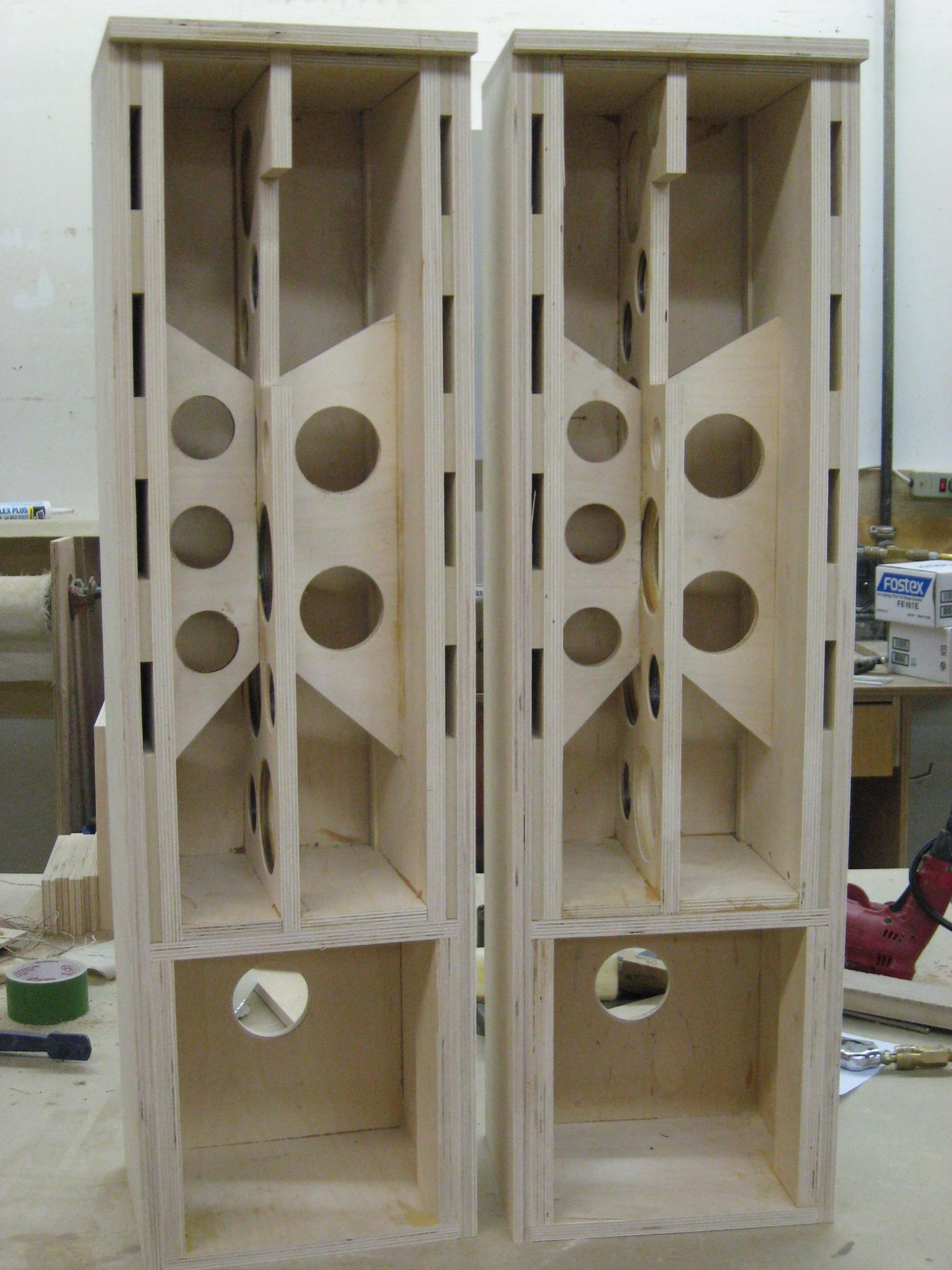

Tthe purpose of the "magnet" brace is to provide rigid coupling/ support between the motor assembly (generally the highest mass portion of the driver) and the rear panel, as well as bracing of at least 2 more adjoining panels.
On larger enclosures I like to run this brace vertically the full length of the cabinet (or driver compartment as in attached photo) to couple 4 panels ( front/back/top/bottom), and even include additional side to side bracing.
The trick of course is to cut the magnet brace just exactly tight enough to not stress the driver - this takes some trial and error dry fitting with the driver temporarily installed and before the second side of cabinet is attached.
