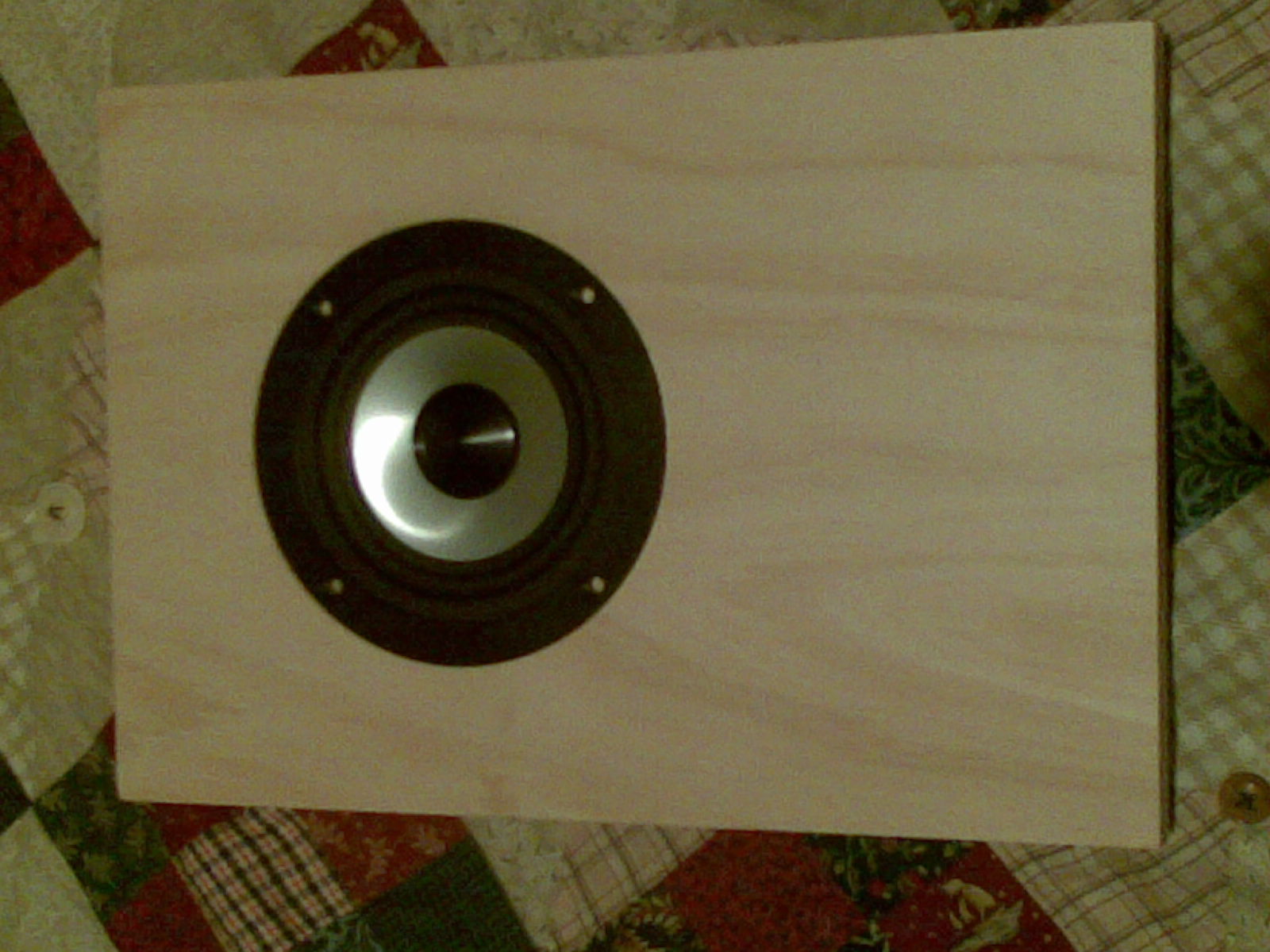

Well, I promised pictures - but I'm afraid I got held up, so now the second box looks exactly like the first box pictured in my previous post. So you'll just have to look at that, but imagine two of them.
In the meantime, I've been breaking in the drivers in their rudimentary OB's on my desk - some observations:
a) These things have extraordinary excursion for a small driver - even OB bass is audible down to 40hz or so.
b) Off axis response is surprisingly good - while there's certainly a sweet spot, response seems quite good up to about 30 degrees off axis.
c) Imaging! The phantom centre effect with these speakers is extraordinary - with well mixed material, it often seems like a 1 foot high hologram of the lead singer has been projected onto my desk.
So far, very happy - this pair is for my girlfriend, but I have the timber for another pair, and I think they'll be headed for the loungeroom to replace a truly dismal set of late 80's Sony 3 ways.
Routed, the baffles are, hmm?

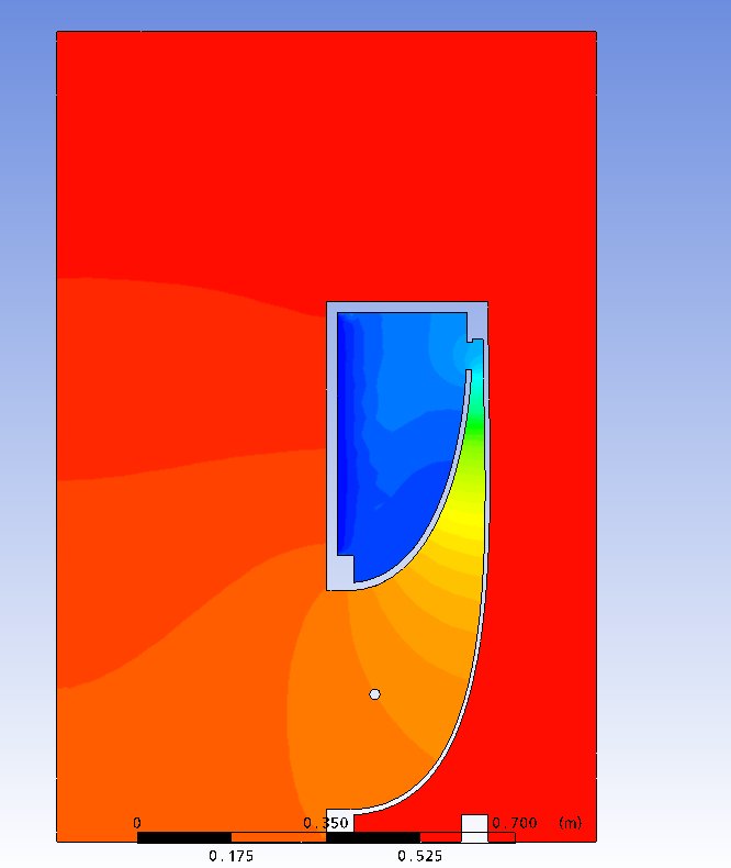

I've got question. Some time ago I bought CHR70 pair. Now it is time to do something with it. I thought about something like vented monitor(7-12l) with extra horn added(1,5m long throat 80mm2 mouth 800mm2). It will look like something at image ( it will be 150mm wide you can imagin it by extrude this profile). My question will this added horn help bass performance. Currently I work at FEM analysis. Image shows wave at 40Hz. I plan to form horn in thin plywood (first mechanical resonance mode is around 118Hz second around 200Hz but the deformation is almost zero so it is rather stiff). Post Your opinion about that idea:)
