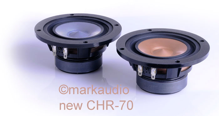

Hi Guys,
A quick note to let you know the new CHR-70 will be available soon. I've completed the production. The driver is updated with new cones (Multi-formed), revised coil and rear suspensions.
Here's a pic. I'll be back to the studio later next week so will post in the forum's new makers section.
Thanks,
Mark.

Mark, do we have any new TS paremeters for these? Also, how would you say the new design is better?
Mark, do we have any new TS parameters for these? Also, how would you say the new design is better?
Hi Steve,
Humble apologies for not replying sooner. Here's the link to the new CHR-70 thread in Markaudio section of Manufacturers, all T/S info there. I'd personally say the new multi-form cones are a nice step forward. Derek Shek (Miniwatt amp maker) and me were playing the new drivers in 10 litre BR's, Derek's tiny 2.5 watt with switching power supply - smooooooooth as silk with more detail, clarity. Derek knows both old and new drivers, got the big thumbs up for him for the new model.
Amazed at Derek's tiny 2.5. Thought it might struggle pushing the CHR's but it didn't. Played loud and clear, I learn something new every day.
Email me if you need more info - thanks
http://www.diyaudio.com/forums/markaudio/153091-new-chr-70-a.html
Mark.
