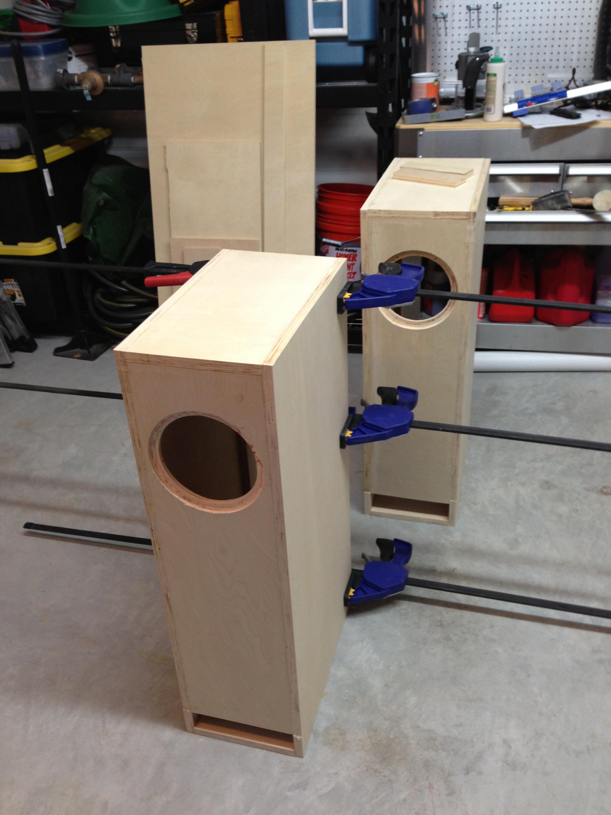

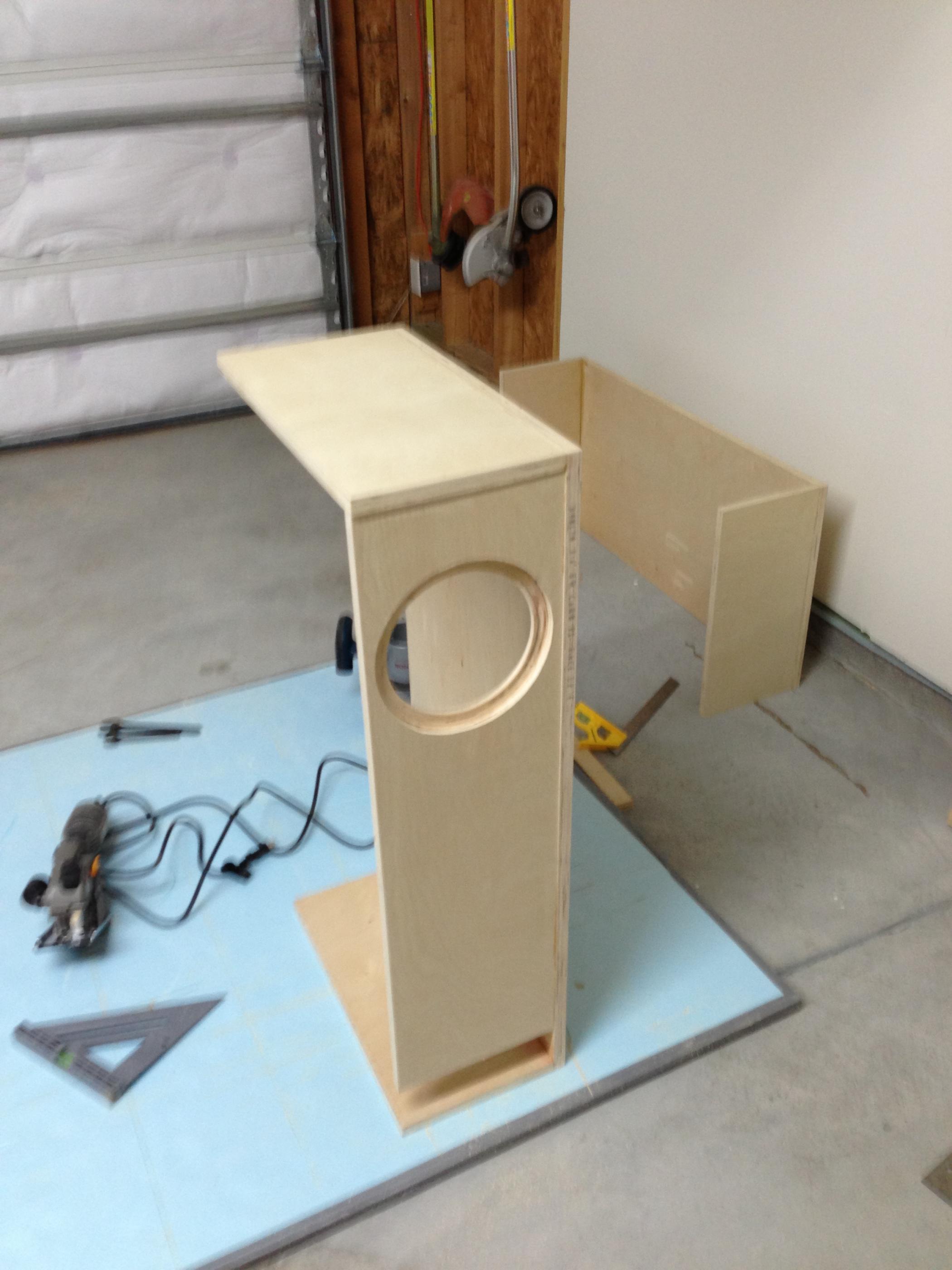

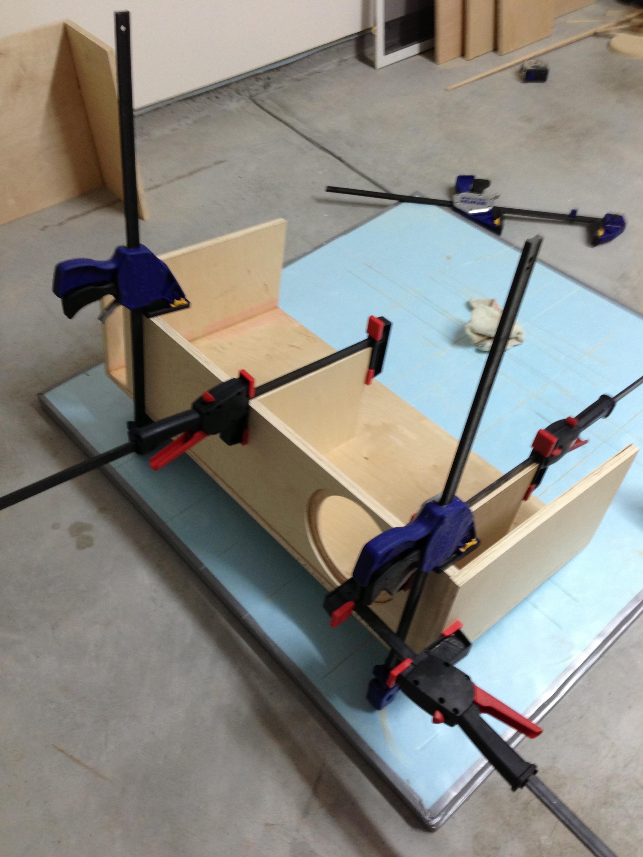

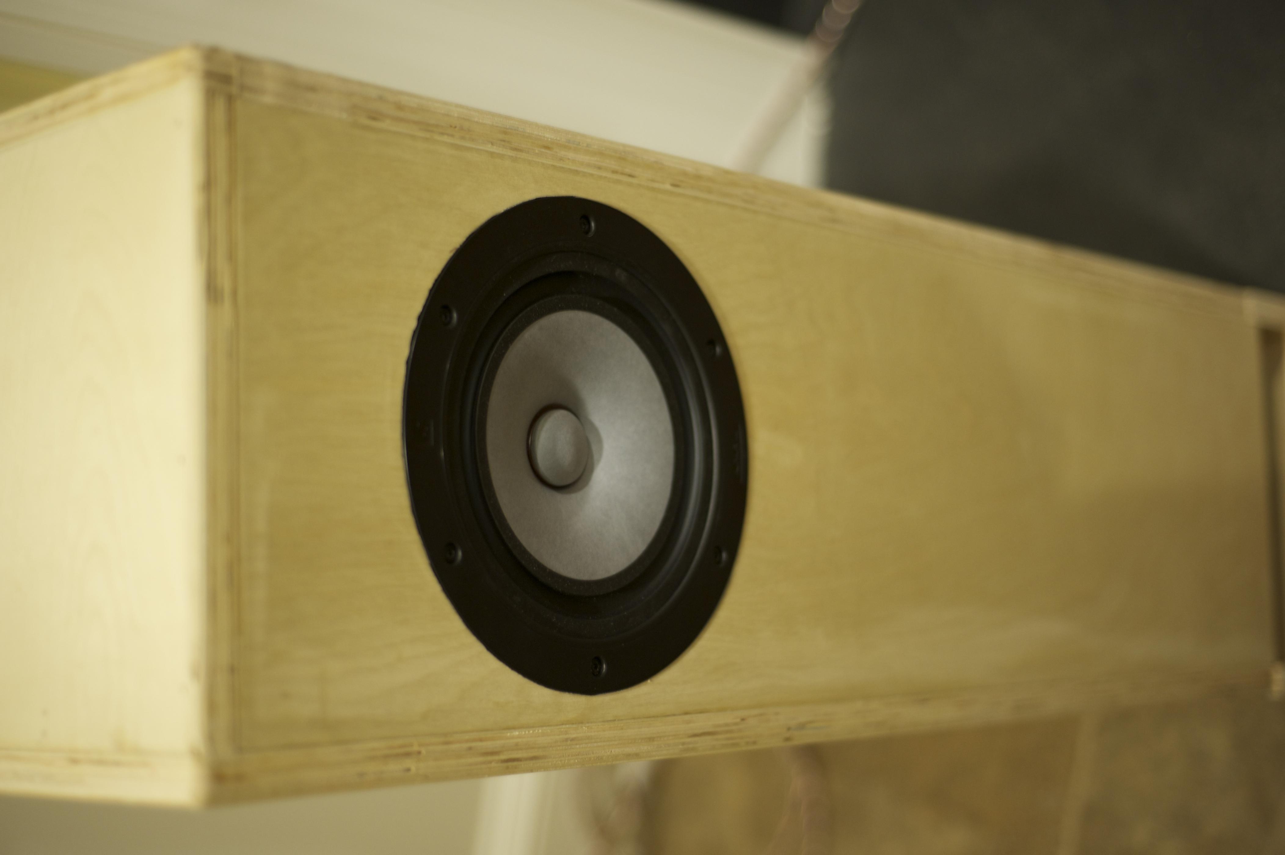

A bunch more completed so far today, should have one totally done today! Just a couple more back supports to go. A quick run to Lowes to get the pieces to attach the back with.
Going to hardwire them through the port today to do a listen test. (No binding posts etc here yet.)
I have one cabinet fully glued up except for the back. Going to attach the back once this glue sets and mount the driver. Should make for a great listen test!
Thanks to Planet10, I will use CAT5 from the driver to the hookup. (I will just be running this out the front port for now during the test phase.
Here are some pictures from the build so far...

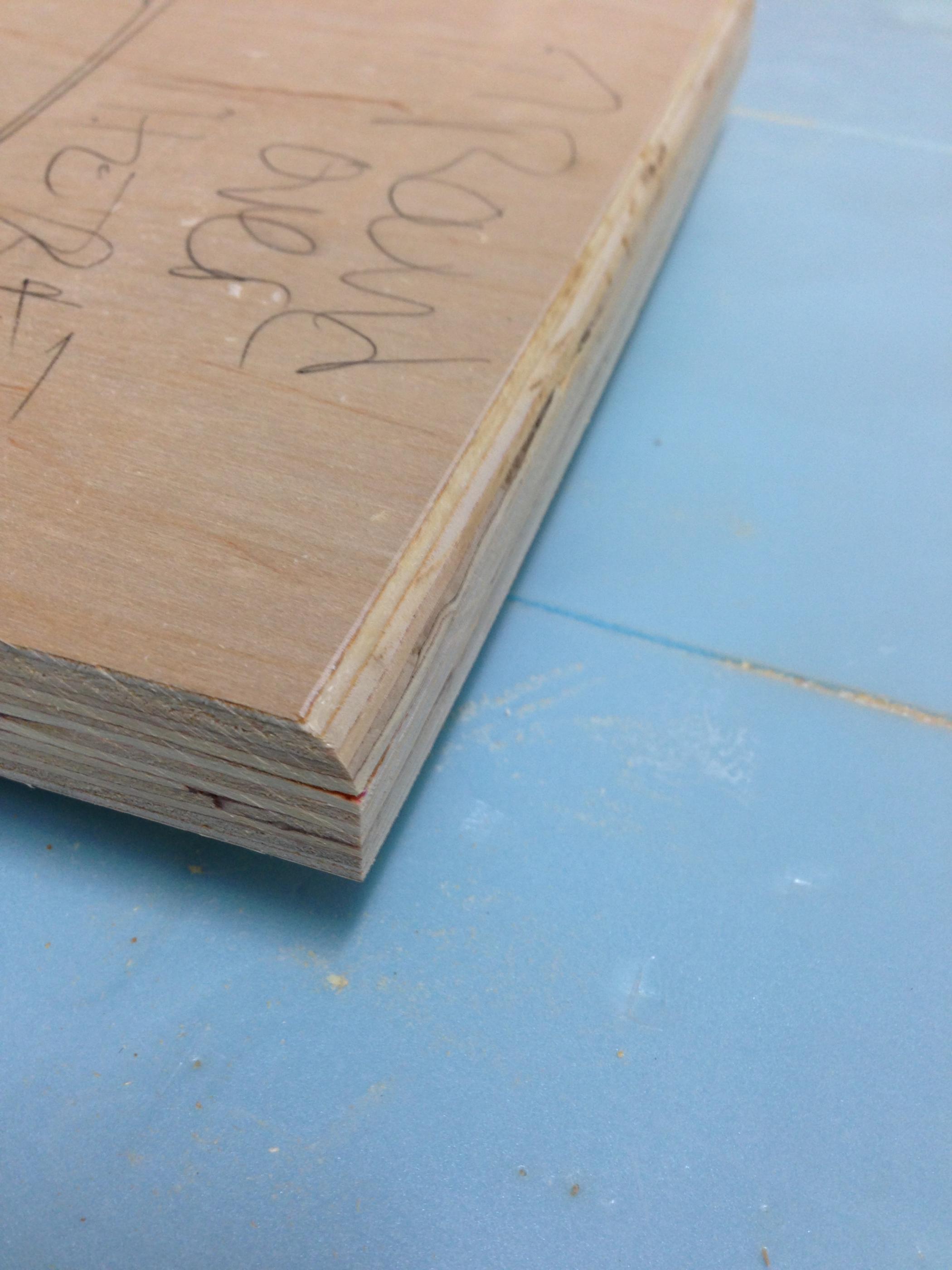

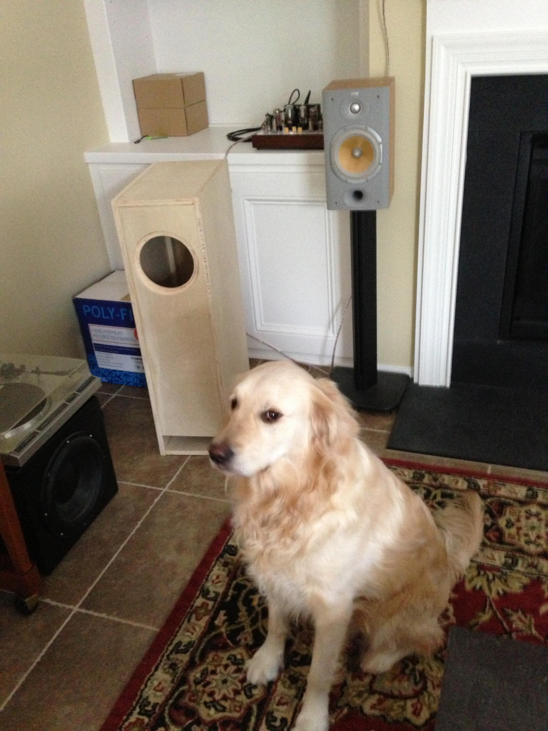

Couple more shots after the last clamps came off. Back is just tapped into place, no screws or anything yet. Fits like a glove. Stable too!
Todo:
  1. Trim Edges with Flush Trim Bit
  2. Roundover all edges
  3. Install Drivers
  4. Add PolyFill
  5. Test

Simplest solution, stagger two 1.25" ø dowels to form a Cross Brace just above the port but not with equal spacing from the next set of X bace'd dowels further up the cabinet. Although i do question whether three pairs of X braces would be sufficient bracing for a cab of that depth.
Thanks, I will take a peek at my options... I might make the optional braces...

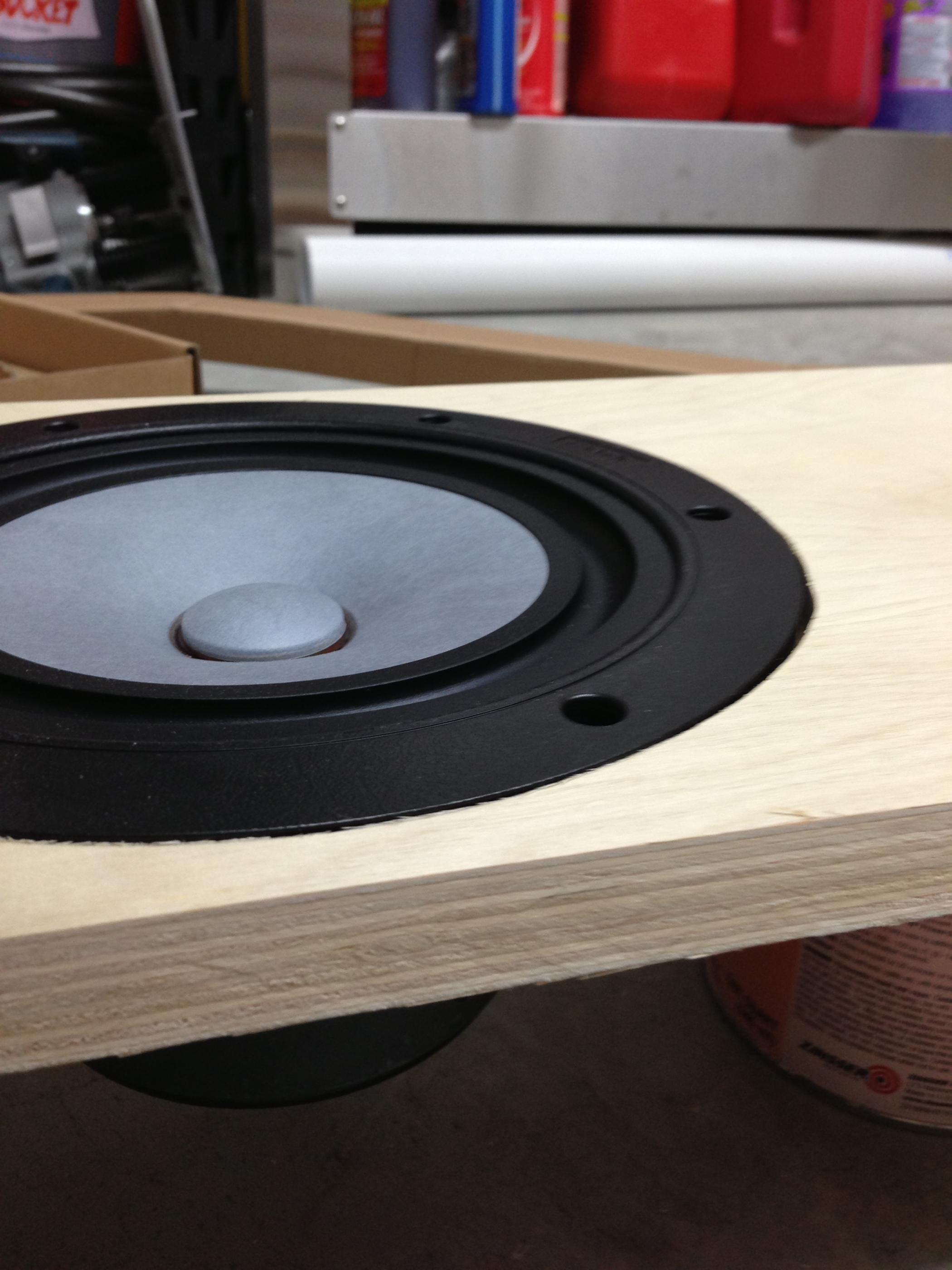

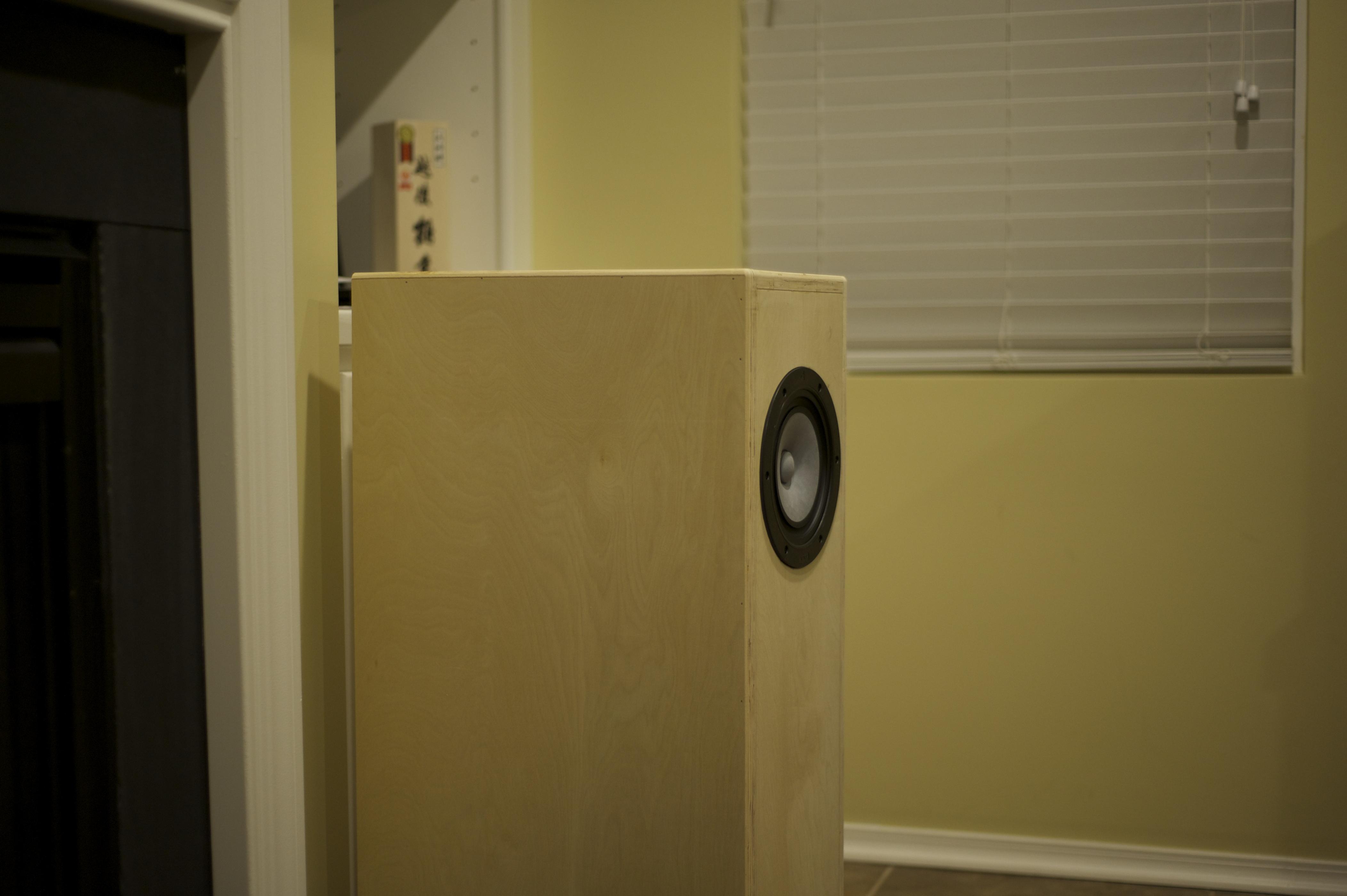

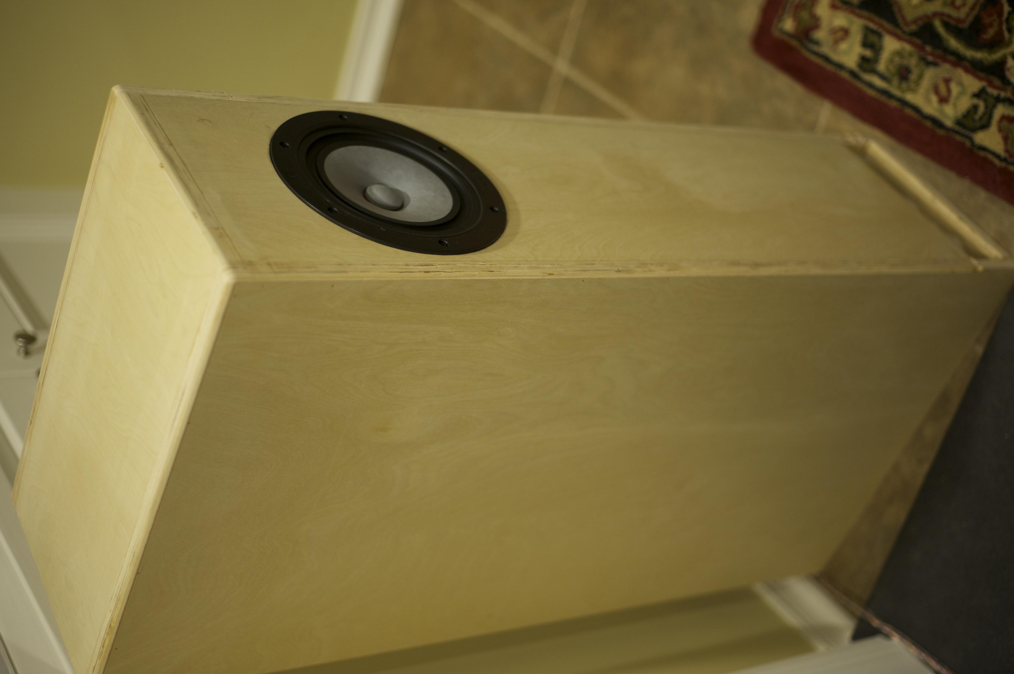

This build has been completed to a listening state. I will be running them like this for a while during the "burn-in phase". So far I am just blown away by the Mark Audio A12p's.
Imaging is just ethereal and absorbing. I have never heard anything like it.
I posted some final build pics. Last things left are some wood filler, sanding, and stain. I will be holding off on this until I have listened long enough.
