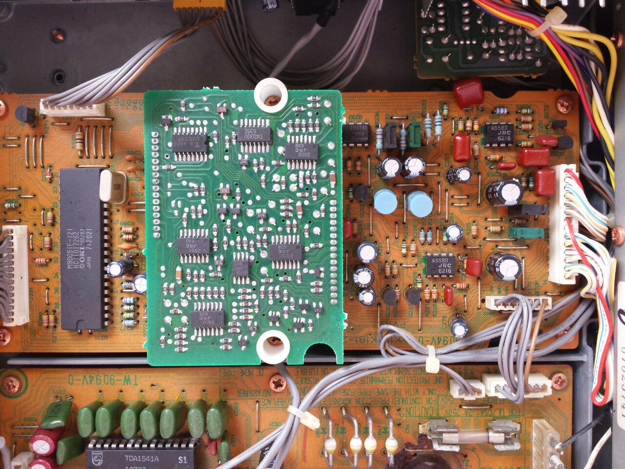

BTW, I know that much has been written, but any further hint or link for best mods on the unit?
I have got a CD94 Mk I but with TDA 1541A S1 (single crown) swapped by previous owner.
I seem I remember somebody suggested to beef up some of the caps around the DAC to 400uF, and to regulate SAA7220 voltage... but any suggestion is welcome. I also have a separate Monarchy 22B (PCM63K based) DAC and would like to perform a small DAC "battle"...
TIA,
Stefano

Very differently? As far as I can see the previous owner just swapped some elco with film caps around the two JRC 6216 but nothing major.
Besides the S1, and without yet disconnecting the board, I could only recognize non standard RCA plugs with coaxial cable.. (photo before the vacuum cleaner )
Before doing anything I've yet to finish reading (and hopefully understanding) the giant 650 thread...

This would be better moved to the appropriate thread but I could find that just now.
There are several super regs though might be of use for the 7220. I started with a 7805, and that was better. Then a more elaborate discrete regulator. Now we have more choice.
See the Jung Didden super reg thread: Super Regulator
Going by some graphs made for the regulator 'bake off' which go only up to 100kHz, I would consider a super Teddy Reg, maybe the Sjöström reg. for this purpose, due to this:
not being audio band but 11MHz,
that 7220 board might be drawing a far bit of current, maybe more than the 200mA max of the Jung / Didden, especially if you supply the 1541 as well,
because they are small and will fit in the space at the rear of the 7220 digital board,
they both have excellent PSRR,
You can sink the heat through the side the CD player chassis.

Seems cheaper than super regs, and small and simple to fit, and a lot better in various ways than 7805, 317, but:
It's PSRR is 78dB at 100kHz, whereas the others I mentioned are stated to be about 90dB.
IIRC, and I'm a bit vague on it now, according to the Super Teddy Threads at PinkFish, they were saying that because two FETs are used for the pass devices, they block the noise travelling either way, which would be an advantage for digital chips. Teddy Pardo seems to have some very good test equipment and was talking about the regulators effectiveness at MHz and the sonic improvements they heard.
Opposite to the LT3045, the Jung Didden super reg error amplifier is fed from the output of the pass transistor, which was found to be better sounding.
