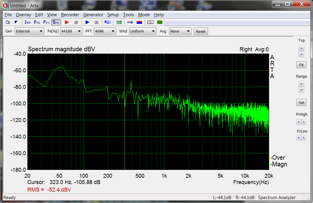

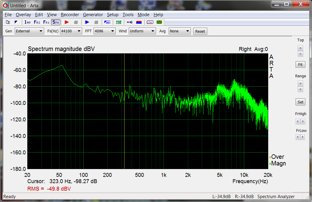

Returning from the City with some nice feelings about it I got time to record the noise and also took some pics.
The "linear" graph is "home noise" with system speakers muted, the one with the bump between 5 and 10k is was recorded with the mic near the tweeter with the system full on without music.

in this case it is not normal because it is much stronger on the right channel (the one we are studying).
The noise can not be heard when playing "normal" music but it is clearly audible when playing Eric Satie on quiet passages at loud volume.
Anyway, I do not think it is hum.... and being only on one channel lets me believe it is magnetically induced.

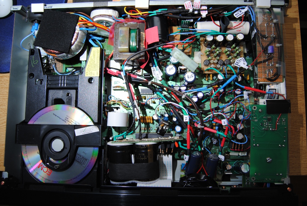

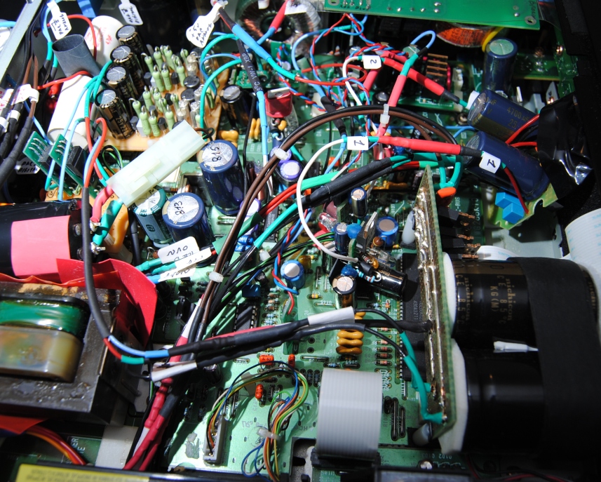

I will post some pictures of the inside of the player so you can analyse it and maybe suggest the best way to correct this issue.
Joined 2006
Well, today I opened the machine, took out the rectifier board used for dac analog and digital that sits closer to the dos and powered it up... no change....
I did profit to solder some 47n styros over the output caps and sound is now much better... next time I will try moving the clock tx away from the dac and see....
