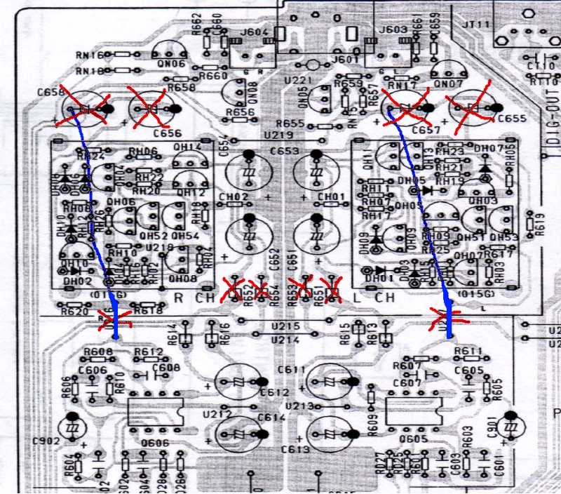

Your blue lines are connected to the wrong end of the links (need to closest to the opamps) you removed but other than that it's fine. Personally, I would not remove the muting to start but it's very easy to remove the headphones feed as you describe. To be honest, unless you replace some caps in the psu and local decoupling to the dac and opamp then change to opamps to lm4562 or similar, you will make it sound worse by just bypassing the hdam.
Thanks for looking at the 1st diagram, I have included a 2nd update, is this what you mean??
Minor tweaks like removing headphones and swappng the mains cord will not prep the players for HDAM bypass. I would do op-amps, filter caps and seriously beef up PSU caps first.
Thanks for the tips. I'm only 100 posts in the thread, more tonight!! I'll leave the HDAM alone then but at least I can now do it. :D I'll probably have a better understanding of which op-amps, filter-caps and PSU caps when I get further into the thread. There seems to be some many suggestions it's extremely difficult to keep up!

Hi guys, I'm looking for a nice (free) tweak to do next while I wait to get DOS parts. Does the following make sense?
