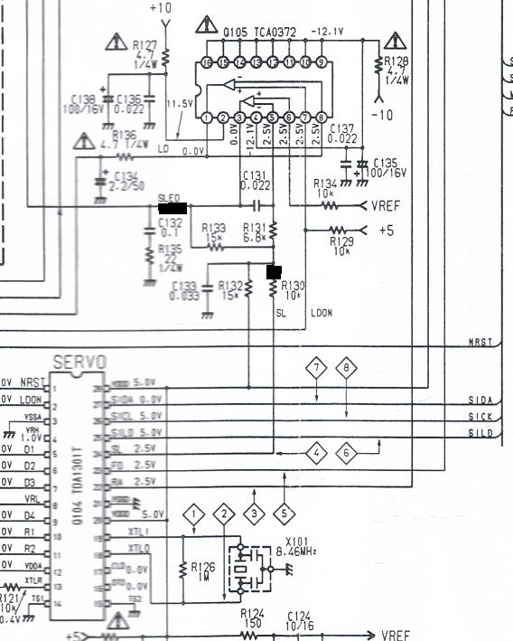

First check these voltages :-
across C122 - should be +5v
across C124 - should be +2.5v
across C148 - should be -12v approx. [pin 9-16 on Q106]
also from either end of R128 to ground [0v] - as above
Check carefully for shorts / solder splashes around the 2 jumpers [U139 / U140 ]
U139 connects the sled signal from the servo chip [Q104] to the sled driver [Q105]

In your previouspost, you gave the voltage for Q105, pins 9-16, which were low [7v]. The voltage either side of R128 should be around -12v, the same as pins 9-16. If they are different, it indicates a fault between R128 and Q105.(which is impossible given the distance. So your original voltages would seem to be in error
If the silver plated copper wire i use ideally needs silver solder, then would it be better for me to use cat5 cable instead with my standard leaded solder.
Yes
One thing, could the removal of u139/140 then the switching on of the player caused some damage, as that was the first thing i did about a week ago whilst i was strengthening my chassis. I didn't put those two back in until the other day?
thanks
Q105 is the driver for the sled and the laser.
U139 feeds the drive signal - removing it would give +5v on the input causing the sled to move to one extreme.
However, removing U140 disconnects the sled from the drive [leaving the feedback loop intact] which would mean that the sled would not move [no drive].
The black blobs on the attached show the position of the links.
What worries me is :-
you said with the links removed the sled went to one end.
with them replaced, it went to the other end.
The voltages around the chip are wrong.
Recheck the voltages around the chip [you can disconnect the cdm] should be as per diagram.
Clean up soldering.
Andy
