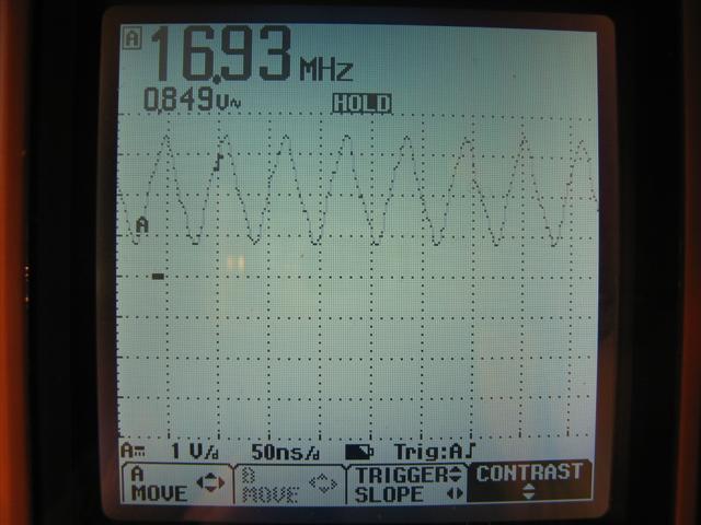

No no, its fine Ray. But I don't measure the waveform out of the Tent XO near square. I don't know whether my scope is the limit, but this is what I get from it. Doesn't seem to be a comperator output.
But I do agree, the square wave has much more energy than the sine.

avr300 said:No no, its fine Ray. But I don't measure the waveform out of the Tent XO near square. I don't know whether my scope is the limit, but this is what I get from it. Doesn't seem to be a comperator output.
/avr300
thats what i get too, on a 20Mhz scope
need higher resolution scope to pick up 16.9Mhz square wave, all the higher order harmonics.

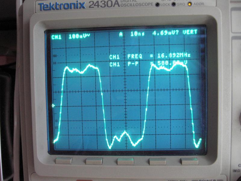

Hi avr,
Same as Allan, the square looks like a sine on my scope. If you do a search on this topic you can find more about it, and how to do a proper measurement with a terminated cable.
The closest I got to a square was on the scope of a friend of mine:
Ray.

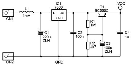

That's not too difficult. The offset voltage across the FET's 1k source resistor is about 2.5V, so that would mean 2.5mA. It wouldn't hurt to load the output of the PSU with an extra 1k in this case, to ensure minimum current draw.
poynton said:Use a TL431/BC550 as in the KwakClock.
Andy
I would prefer the more passive approach, with a pre-regulator, like this circuit that Guido uses for his XO-module. That's one potentially noisy TL431 less to worry about. Output is a little over 5V with these resistor values, and that will result in a nice 5Vpp sine wave.
Ray.

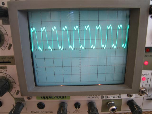

Hi Allan,
The more capacitive load you put on the square wave output, the more sinusoidal it becomes. The cable acts as a low-pass filter between the signal and the scope, and filters out all the higher harmonics. If you load the output as little as possible, you'll get a square more or less. Also the amplitude of the signal gets less the more you load it. The scope picture I posted was measured with a decent 10x probe, and still shows a lovely 5Vpp output.
Ray.
Done the same measurement again, this time with a 10x probe and on my old CRT scope. Looks a great deal bettet. Amplitude now 5V.
So Fluke'o scope with standard probes isn't up to the task.
BTW, just installed a sep. psu for the clock. Not bad, not bad...
/avr300
