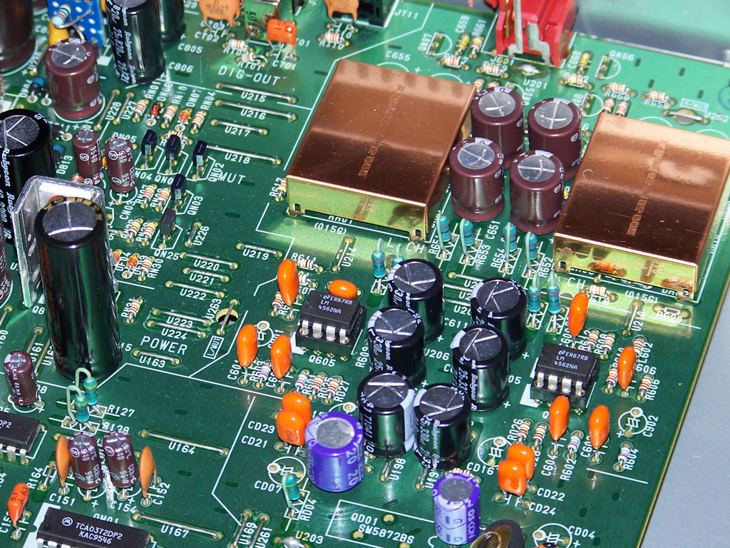

I wanted to report on the CD-63 SE I'm modding.
Stock it's far better than a CD-53 or CD-43, and until now I've never had a chance to listen to a HDAM'ed player.
Now modding :) All these at once with no smoke (yeeesssss) plus some other caps and 317/337 at 15V for LM4562. Followed Brent's advice with ZLG 330/25V all around analog. Really not bad!
I'm listening at low volume now, but switched players. The SE seems to do the drums better, kick is here, far less on the CD-43, and seems to be a bit more dynamlc. Strings and balance is not as good as the CD-43, image is narower, low mids are missing. As the speakers don't do bass, is it a "boomy bass" at the drum kick that pushes some bass out of the speakers that I hear, or the CD-43 shows some weakness? Very hard to say as the room is not sounding good at all and I have lost a lot in changing of house. It's like the CD-43 is at pain when the CD-63 has power. I'm a bit sad, all that work on the CD-43...

You should also use much larger value panasonic TSUP caps when replacing the psu smoothers. The original list has changed slightly ;-)
Personally I would use 10,000uF/25v on short leads to replace C803 and C804 but most importantly I would replace C813 & 814 with 22,000uF/16v panasonic TSUP. Again they will need to be on short leads and glued down but very much worth the effort. Given the relatively low cost of the parts involved, this would be very early on the list of to do's!!
no 1 on my list if you asked me 35v on the 803/804s major leap forward best mod ive done yet player came to life whats next . lol

I'm as ignorant now as I was then! There's one in every crowd...who just follows where others lead (and cheerfully take my money:) ) I don't suppose those silver oilers will fit? Brent? I'm a sucker for new and better!!!
Those capacitors have to be mounted on the rear externally just like I do it. I would give your player a good few months for the sound to fully settle in first.
