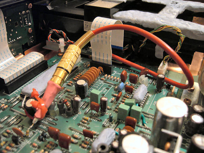

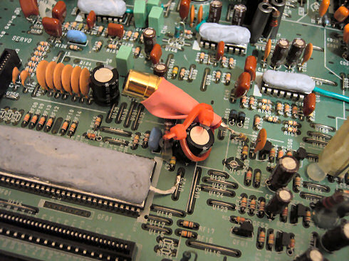

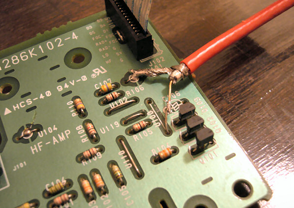

Did my first coax upgrade. I did this one because it's the most important one, and because CDs were skipping a lot, and the sound was cutting out and giving me grief.
After some days of it not working (bird poo solder??) it's now working (sans-display, lol) and....
- the skipping is gone
- the timing, low bass impact and treble smoothness have been improved very nicely
rowemeister said:Nice one Simon
Like the RCA idea.
Thanks. I glue-gunned the hell out of that afterwards. If I hadn't, it surely wouldn't last many plugs/unplugs. Only trouble is...the place I've probably killed the display's 5v is about there

Nice work Simon!
Something I will definitely try (one day, if I ever get the chance).
Even using connectors, it needs to be done late on I think. Looks a bit bulky. Do those cables wobble much? Do they need damping?

I agree, it's to be done late. I've done many mods already, and I suspected the HF signal was causing trouble (seems it indeed was), so I had to try it really! The performance difference seems to be significant - cymbals are less like white-noise and the sound is generally more 'analogue'. The treble is approaching the quality of the bass, altho the bass is better now too! The parts don't wobble now that I've glued both pcb-connected parts with lots of hot-melt glue. I'm tempted by the other coax swaps now, but I think I'll leave those till after my psu seperation and beefing upgrades.
