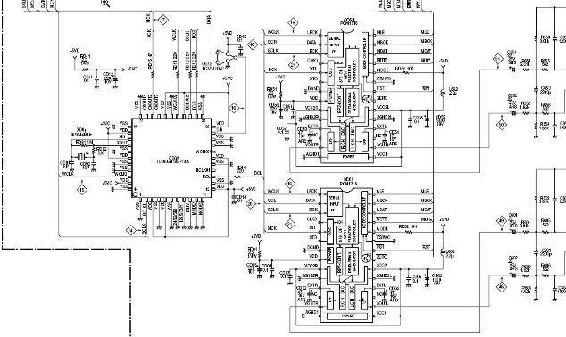

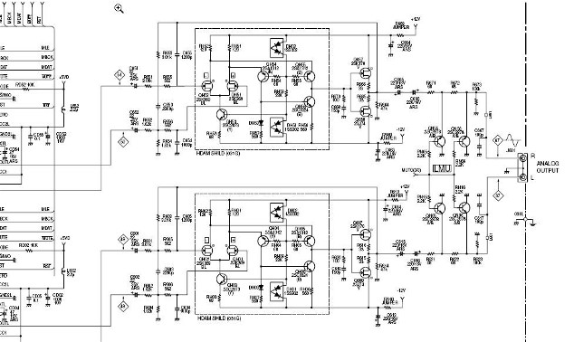

This is what happens in the CD6000 OSE
Andy

Hi Arthur,
The CD6000 is a bit more complicated because of the two DAC's. Marantz uses one for each channel, and that leaves us with four outputs for each channel that have to be summed, instead of two. First, they sum the RO/RON and LO/LON outputs with two opamps, and then they use the HDAM circuit to sum the two opamp outputs. Some filtering is done in both stages. As Andy states, in the OSE and KI they use HDAM circuits instead of the opamps. Both circuits have two inputs and one output, so they can be regarded the same.
To replace all this with passive filtering and discrete stages you would need eight passive filters, one for each output, four differential stages to sum these outputs, and two more to sum the outputs of these four. Since the DAC's are the same as in the CD63/67 I think my filter will work fine, but perhaps you will have a problem fitting it all on the board somehow
Since the HDAM circuit is already a discrete stage, maybe you can replace the opamp-part only.
Or you can take the "Microsoft approach" and use only one output of the DAC, like Thorsten Loesch does in this article. I tried this filter and tubestage too and it works very good. The gain is a bit low though.
The next solution could be: get rid of the TC160G11 chip that generates the data for the separate DAC's and use a single DAC for both channels, just like in the CD63/67. That would be one piece of silicon nastyness less in the signal path. But this would be HIGHLY experimental (don't you love it ????).
BTW, the inductors are nasty indeed, I get them from Farnell. I buy a few more than I need and pick out pairs that match best.
Ray.
