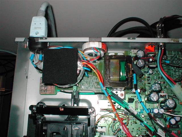

rowemeister said:Very good.
Have you found any improvement in bass?
Thank you.
Not functional yet.... must prepare the sregs for the servo... The wires from it´s psu seem to be just over their future placing
But I am very happy you believe it will produce bass improvements.
Let you know soon about the sound results.
Ricardo
Malefoda,
I remember years ago there use to be numerous discussions regarding the quality of the separate mains earth lines. Most earth lines in a house have a lot of noise on it and also a small residual mains voltage.
It was always advocated to make your own earth by putting a steel rod in your back garden. It was said to be beneficial to use this to earth equipment that didn't have a separate earth. I'm not sure what the improvements were, but no harm in trying?
Saying all that, I wouldn't want to be in your house during a thunderstorm!

In France each house uses a dedicated Earth. And it's very easy for me to have a copper stick or even several deep in earth and just linked to my -very near to come but still that pain to setup- dedicated music room. If this and star ground in CDP linked to that dedicated earth is a real improvement then I'll have to do it, cheap but bothering...
Running seperate earth rods is not a good idea form a safety point of view. By using seperate rods in different places you can setup voltages in the earth and thus causing faulty safety device (RCD) operation.

Thank you Brentrowemeister said:All true but we were originally talking about star gnd internally of the cd player, lets not get to carried away.
I did not wire my star earth to the mains GND.
Should I do it or can I have normal improvements just by centralizing the earths inside the player.
I used to build valv amps in the past and they must have a star earth or hum problems appear.
Ricardo
