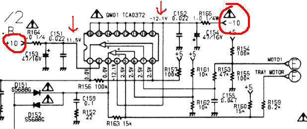

Glenn2 said:
Don't Os-con's have a failure mode of short-circuit like tantalums too? (unlike aluminium electrolytics)
I think I read that somewhere...
It would probably just result in blown fuses but worth bearing in mind... (a short after a reg often just shuts the reg down, but on unregulated side worse may happen.)
These lines provide +-10V to the driver..... The OsCon I am using are rated at 10V..... is dis dangerous ?
Ricardo
Ricardo
The key point is that the rails are unregulated. (Only nominally 10V.)
If you measure them with the machine not playing you will probably find they are 11V-12V. It tells you in the service manual.
They will probably sag a bit when you press play.
They will also vary as your mains supply varies.
You may be lucky but you are running them beyond their specified limits. I certainly wouldn't do it.
Hope this helps...
Glenn
EDIT: I just noticed I picked the wrong driver to show, but it's the same for all three.
Ricardo
Yes these voltage rails are +/- 12V. Only the + volt sags a little bit. More so on a 53 63. The SE and KI only sag a little bit due to the larger VA tx.
I would defo put a 16V minimum rated cap on those rails.
Brent
