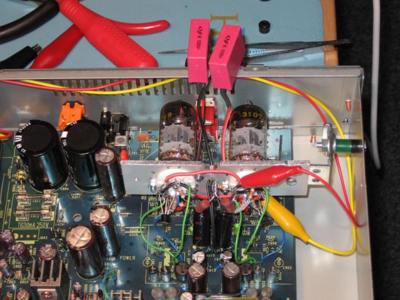

Thomo said:I seem to remember that somebody built a valve output stage (Ray?), does anyone have a schematic? A mate is very interested in getting me to build one, which is good cos I'm skint.
Lee.
Yes, that was me
It never made it past the prototype stage, but it sounded very good. I took the solid-state path...
I'll see if I can come up with the schematic, the circuit is not that complicated.
Ray
Considering the exemplary sound of the FET/solid state output stage, I've no idea why anyone would feel the need to add unreliability and something fragile into their player.
Lee, does your friend read too many hi-fi comics? If his sound needs "sweetening up" I'd imagine it's better to do it with good component choice and speaker tweaking.
Just my 2p and I mean no offence.

SimontY said:Considering the exemplary sound of the FET/solid state output stage, I've no idea why anyone would feel the need to add unreliability and something fragile into their player.
Simon
That's more or less the reason I took the solid state route. Tubes are NOT fragile BTW (ever tried overloading a BC550 with 400V without any damage?? but you need an extra HV and heater supply. A bit too complicated at that time to fit into the player without too much trouble. After several listening tests I came to the conclusion that the outputstage sounded great in both cases, whether it was built with tubes or FETs, so solid state it was...
