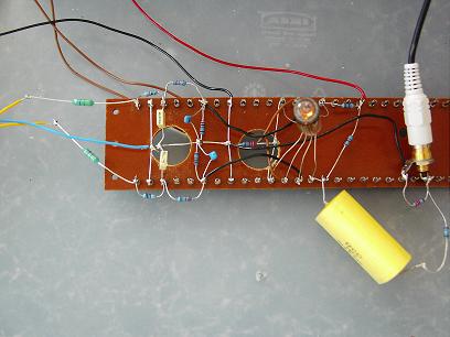

poynton said:
So, I am now going to try the small tubes.........
Hi.
Another day .....had to repair the power supply this morning - somehow the Tx developed a primary short. Luckily I had a New TX to hand so I could repair it.
Worth the wait though !!!!!!!!!
Now using one of the minature tubes ( 6BF7W ).
Really excellent sound - possibly a little lighter on the bass than the E88CC but only a RCH !
B+ is incredible - it does not seem to distort (audibly) until B+ goes down to 3.5v - Correct 3.5v !! then it cuts off anyway ! I will keep it at B+ = 25v - audible performance does not seem to improve above this.
Heater is running a bit bright for my liking and gets HOT. I will try on 5v regulated supply rather than 6.3v AC
Andy

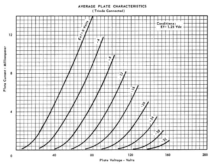

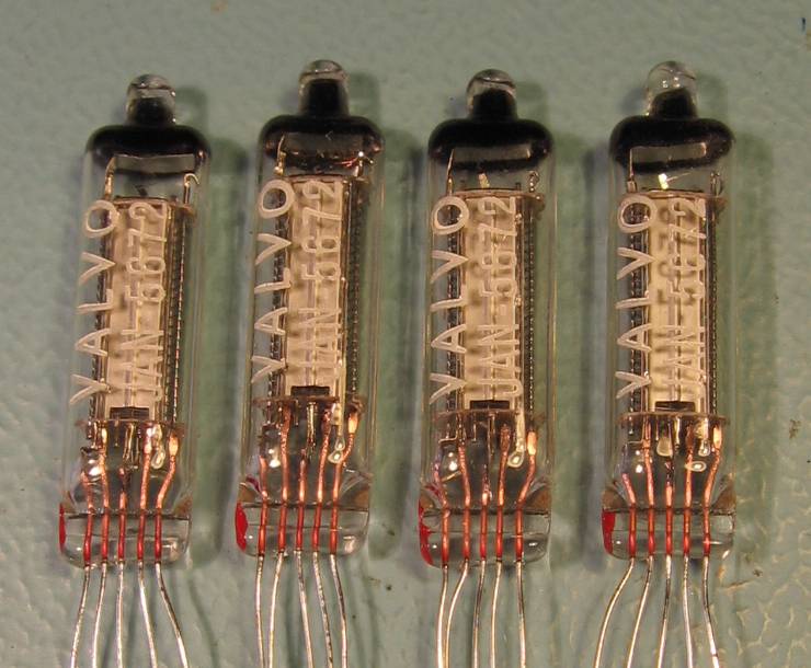

I went to the dump-store this afternoon, and I picked up some 5672 and 6418 pencil-tubes. They are low-voltage direct-heated penthodes that use 1,25V heater supply! I don't know if they're any good, but one of them has got very nice triode characteristics!
As soon as I have the passive part finished i'm going to try them.

6h5c said:Hi Andy!
Ray.

Just a resistor - no ccd

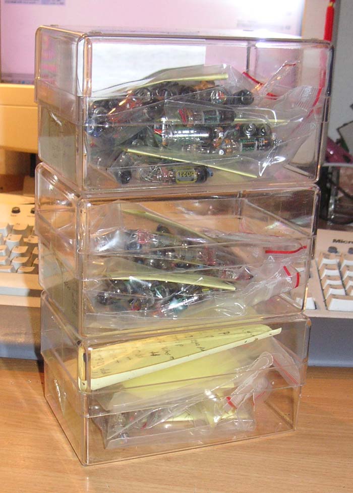

poynton said:What is a dump store??? How much??
Ehm, a shop with lots of junk, where they sell old army stuff and surplus parts, I don't know the exact word in english. They have at least two boxes full of these, they only cost me € 1,00 each! So I bought four of both types.
Ray.

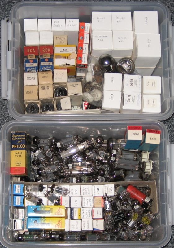

Hi Franz,
Cool site! I love those places.
I'm very glad I have a place like that about half an hour driving from where I live. It's called "BACO". I go there like once in a month to check if they have new things. They have a (dutch) website too: http://www.baco-army-goods.nl/
This is my tube-collection so far. About half of it (and the boxed ones) comes from the dump-store, and the other half is old TV tubes (PL series).
Ray.
