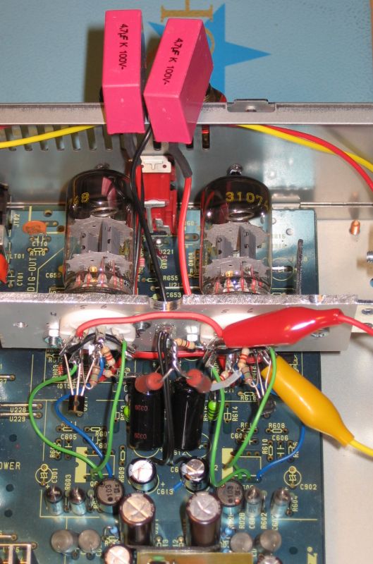

aquar said:Ray's tubestage
Hey, cool you still have that picture
SimontY said:
Without checking, I think a couple of posters here tried a tube output, and liked the results. The FET output will do the same sort of job though I'd have thought. And much more neatly. Can't wait to hear mine.
Simon
The results were nice indeed, but the solid-state version did not make the world's difference. So I decided to drop the tube output plan and use FETs. Much simpler with the +/-12V supply
Ray
