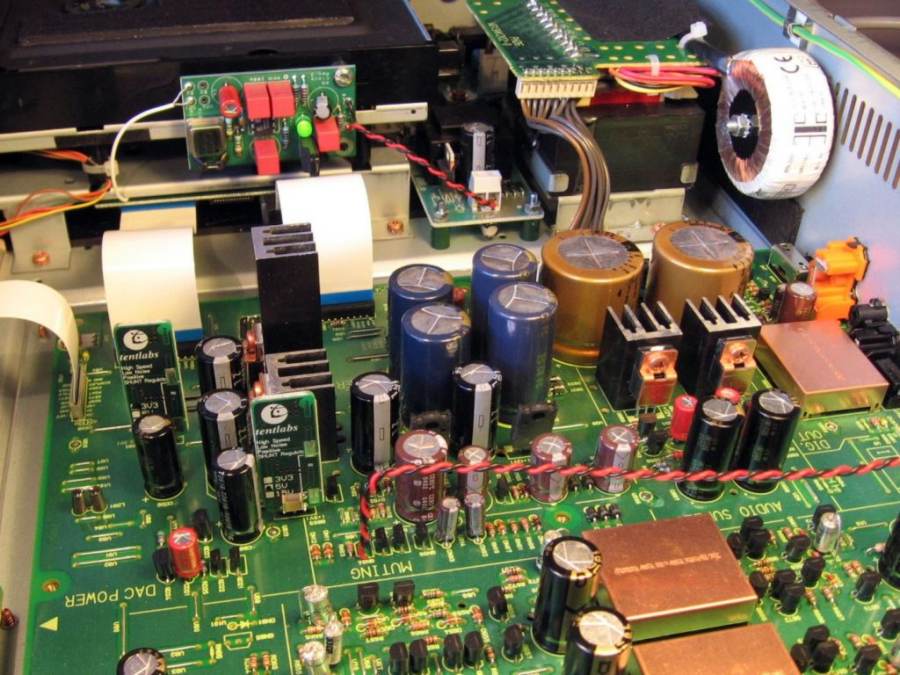

Here's the latest thing I've done to my SA8400 .

martin clark said:Right here
Don't worry that shuld work OK.
The 17.6v figure is the lowest that is guaranteed to work with tolerances of parts - but not the raw PSU - taken into account:
7812 puts out 12.0v nominal, raised from ground by the LED - 1.95v actual, say 2V = 14.0v;
7812 dropout needs to be 2.2-2.5v min at low currents;
Gyrator portion drops 0.65v+ small amount through bias network to drive BC547. How much? well it's the output current - say 20mA - divided by Hfe, say 300 (pessimistic for a BC547C at 20mA). That's 67uA, or 0.67V across the 10K biasing resistor.
So we need (14.0+2.5+1.3v) input, 17.8V, to guarantee it will work. In fact, because the BC54x will have a Hfe of c.400 at these currents, most LM7812s are actually about 11.9v to avoid exceeding their rated voltage (and fwill work with 2.3v overhead at 10mA output) and the LED voltage reduces at -2mV/degreeC, 17.6 will work - always, but that's why it's given as 'minimum minimum'; it gives no allowance for variation in the output of the raw PSU.
If you're worried that your implentation is a bit marginal, then monitor the output from the 7812. It should be constant to two decimal places at (around 13.9v, +/- a little bit). If you see it wandering by 10mV or more over a few minutes then it has insufficient voltage input, and the fix is either more raw input, or reduce R1 (say to 5K ) and try again.
Well, it seems there's also an "average minimum"...
My main dances from 225.00 to 226.00V -for now, as in minutes it can goes from 220 to 230!- while my PSU (20V raw, rectifiers, 1200µF, 7818, 47µf) dances from 18.85 to 18.89V, while the Flea's 7812 show 13.83 to 13.88. @L1 (wich is not there as the XO) it shows 5.05/.04. I have 15K at R1, as I have 2.2µF caps in filter...
Is it OK?
If no, may I change R1 even with 2.2µF?
Or may I remove the PSU's 7818 and let the 20V in?
About the opamps, as it seems it is the main debate on forums, is a ranking possible? I mean like 3 class, 3rd low cheap EOM ones, here JRC2114, a second class with not the best but still good sounding and enjoyed by some of us, and a 1st class, with the very best, maybe a top 5 where each of us may find happiness. Those this make sense? I think that may be a good help for newbies.
Have a good day!

Hi Matthieu,
Looks o.k. to me. Your Flea input voltage is above 18V and the output is a nice and stable 5.0V, so no worries here. As long as the first 7818 on the PSU has a minimum input of 20VDC then everything else behind it is o.k., it's all regulated.
15k for R1 is fine, there's hardly any current flowing there. The higher value nicely compensates for the capacitor being 2u2 instead of 3u3.
