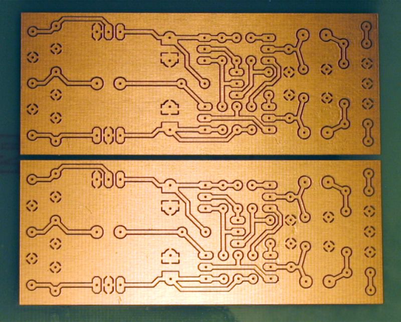

ImSparticus said:Ray, lookin very neat
can i buy one if you do a run of those ?
Thanks! I hope it works...
My girl won't be too happy with that, me taking up all the kitchen with the etchtank, processing 20+ PCB's .
Ray
Offer to etch the turkey too, & see how far that gets youMy girl won't be too happy with that, me taking up all the kitchen with the etchtank, processing 20+ PCB's
